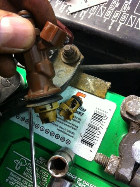

The swap is all straight forward unless you run into the issue I had. 3 injectors broke. Now the plan was to change out #2,4,6 and do the other 3 at a later date. But 2 and 6 broke while in the chamber and 5 broke when trying to free the fuel rail. Thank goodness I had an old spare. I cleaned the 3 remaining "good" old ones and put in the 1,3,5 side.
Heres a pic showing where the brittle plastic failed after 210K miles.
The pic shows the body with a port still attatched and a broken port lying next to it (I was pretty freaked out and realized this is the only photo I took while in the middle of process)

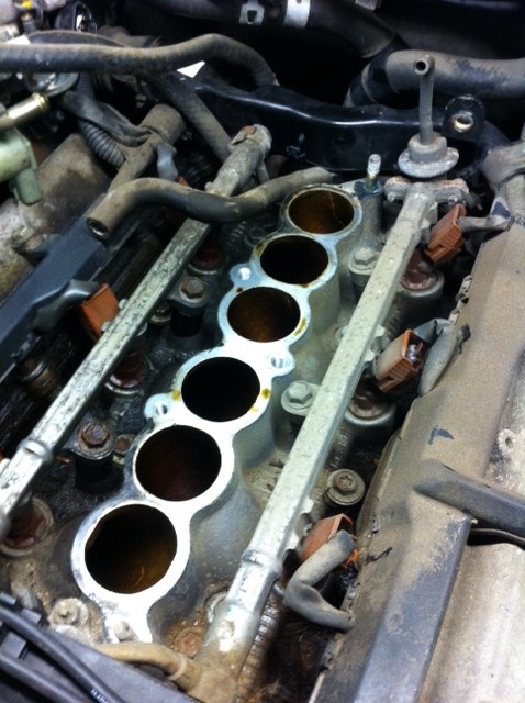

Be sure to order 2 intake gaskets for the plenum. I found a small leak in the lower plenum gasket between cylinders 1+2. Notice the black and oxidation in the photo below:
I cleaned all surfaces off from the old gasket and re-installed all

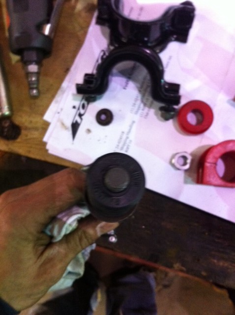

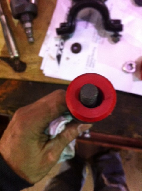

I've read plenty of times where the Moog frond enlinks and Energy Suspension poly bushings have fit issues. Add me to the list!
Swapped my front swaybar endlinks and bushings last week (and fuel filter).
I did the rears last Spring with no issues (ES and Moog as well).
This time however, the front links seemed pretty scrawny! But the main bushings fit perfect. And for the Northeast drivers hit the dealership for new brackets ($15 each PN: 48824-35150 and 48829-35120), bolts, and nuts as shown in my previous post in this build. It saved TONS of time!
See photo:
Moog
Energy Suspension

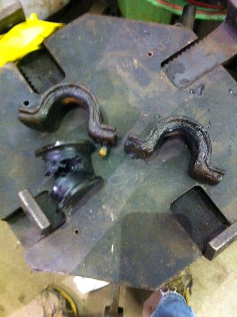

Old Stabilizer Bushings
Considering I replaced the steering rack bushings back in the fall, the whole front end shows considerable ride improvement. Plan to chase down the seller of Amazon for the correct bushings and send the over-sized ones back

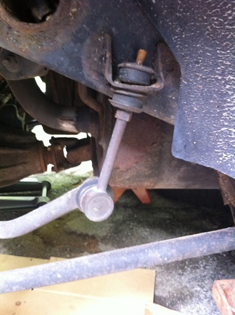

Now Im all messed up because I found a pic of the link before the swap. Maybe when aligning the rearend on the trailing arm before installing the swaybar threw it (swaybar link) out of true. But the rig tracks well and took an avoidance maneuver at 70mph on the freeway today (I pee'd a little and my wife FREAKED! LOL)
Still needs to be addressed tho (here's the old swaybar link)

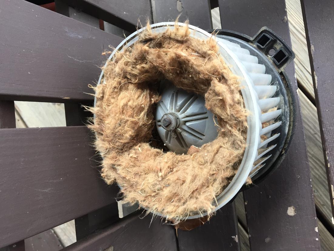

Thanks to millerad1651 (cleaning the blower motor http://www.toyota-4runner.org/3rd-gen-t4rs/113266-cleaning-blower-fan-write-up.html) I got to check my blower motor under the dash because after it sat and I swapped out the exhaust, I fired it up and there was barely any volume coming from vents and a humming from the blower (that and all kinds of debris shot on the floor). Here's what was in the hamster wheel:
