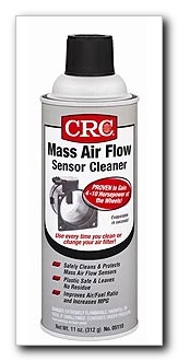

I recently read an article from this month's Consumer Reports which talks about how a dirty MAF sensor can decrease fuel economy. As I was upgrading my OEM air intake to a Volant CAI I noticed how easy it is to remove and check the MAF sensor. For members that are conscious about maintenance and keeping their vehicles in good shape, an excellent idea will be to clean the sensor every time you clean or replace your air filter. I don't know for sure how dirty the MAF sensor can get in our 4Runners but is also good to check it out when we do the air cleaner check. The magazine had an advertisement for CRC MAF sensor cleaner, I think it wouldn't hurt to keep that sensor clean!!!So, all said and done, I will go to the auto parts store today and get a can of sensor cleaner to keep my 4Runner's nostril clean clean:D
CRC

The MAF sensor is one of the most critical sensors for keeping the air to fuel ratio correct. I would recommend cleaning this every 30 k miles. Otherwise the resin will thermally insulate the heated wire and thermister. The will cause the engine to think that more air is actually entering the intake. Remove it and spray contact cleaner in it. CRC makes an aerosol Electrical Cleaner that does a good job for this, or use what Msanta listed above. Do not touch the wires but spray the cleaner several times into the MAF. Let it dry in the sun for several minutes. It should not throw a code unless it

Do not use brake cleaner on the MAF. CRC makes two types of less harsh solvents for this. The 4 wires in the MAF are thin and strong (like a light bulb), but heat over time can make them brittle. [RL Lemke] It is my guess that your MAF was ready to go at any moment and while cleaning it, it simply broke.
