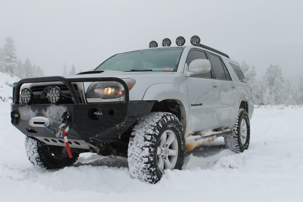

OKOKOK.....here are some more pictures....
So it snowed in COLORADO SPRINGS yesterday and I saw on 2 inches max. So my wife, my son, and I headed into the mountains to see if we could get into deeper snow. Well turns out its possible to find that. After driving up 30-40 degree hills I was thoroughly impressed. The Duratracs were EATING the soil and snow. The time I did slide was because I downshifted while going into a corner on pack ice :( .
Its awesome to see the tires working in 6-8in of snow. The white snow billowing out the sides of the fenders looked great. Since I had the little one i couldn't play to hard but as a review, The ICONs are great! They are like the XREAS in a way but the XREAS could not soak the bumps in like the ICONs!
BTW, the PIAA's dont work yet. Next month ill get them wired

That looks fantastic! Now I have to save up for a suspension to handle the bumper on my wish list!
Thanks Guys
Thanks Doozi, Its worth saving up. I saved for 2 years for the setup.

Very nice
How did the Duratraks do in the snow?
I am thinking about putting those on my 4Runner too.
Thanks Desert Fox as well, These Duratracs are like having snow spikes. I tried to test them. After driving up 30-40 degree hills I was thoroughly impressed. The Duratracs were EATING the soil and snow. I will say if i need a good snow tire I will choose these from now on. they are Awesome!
