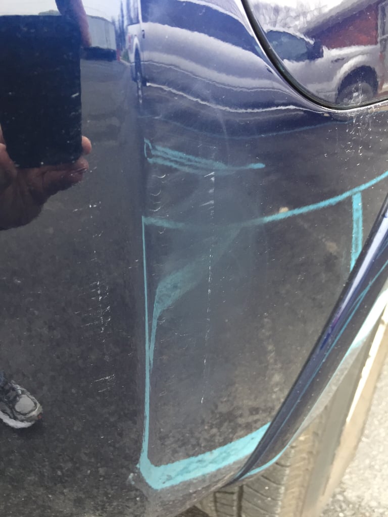

I know this is really late but I haven't been able to snag one:
I have a detail scheduled at the dealership next week. I decided to not touch it any more so it will have a chance of being fixed [emoji23].
Okay I'll start this off by saying I'm an idiot. I didn't know magic eraser could hurt car paint. I bumped into our outside fridge last night when we came home late, and ina brain fart so grabbed a magic eraser. I then freaked out and got it washed. Today it looks dull and there's still some of the white scuff where I hit.
TLDR What can I do to fix magic eraser on my front bumper? Say a product at Napa or something. I have a polisher/buffer if needed.

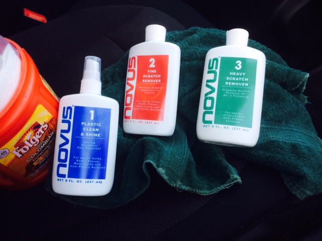

Novus was invented (in 1973) to restore Boeing 747 windshields...kit sold on Amazon.
Video: https://www.youtube.com/watch?v=9qvGnFecVDs
Amazon: NOVUS 7100 Plastic Polish Kit - 8 oz. @ $17.90 https://www.amazon.com/NOVUS-7100-P...UTF8&qid=1491020861&sr=8-1&keywords=novus+kit
^^ I use this product on a soft bath towel (slightly damp) to fix slight paint damage & also to clean up headlight plastic.
- works very well
Several years ago, my wife was sideswiped by a mini vans side mirror, doing 60 mph...lady doing an improper lane change.
We had 5 feet of black plastic smudge, on a gray Volvo wagon quarter panel.
- I successfully hand polished out all the paint damage, with the kit...$$ will spent
The last car i detailed, didn't even use any wax.
Just Novus hand polished the whole car of paint oxidation to restore the factory finish.
- end result is a shinny finish & slippery (to bead off water)
- even used it on the hood of our black RAV4, to remove water marks (left behind from washing)
- also use Novus to polish alloy rims / any brake dust is very easy to clean off later

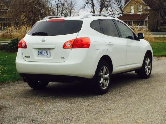

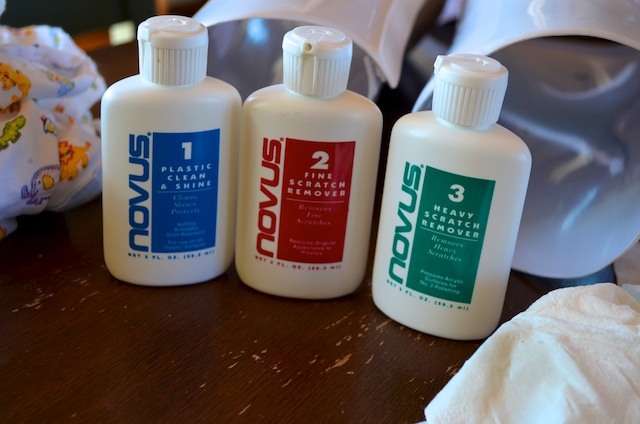

NautiBlue ^^ Don't remember the commercials, but was asked to order some when I worked in Purchasing (for a Tier1 Parts Manufacturing Plant), decades ago & had to try it. We used it to polish Plexiglas SPC work stations in an oily-mist environment.
So many uses for the Novus system - even takes rust color deposits off painted surfaces & restores the original finish.
- I detailed a car once, with 100's of pin-heads of rust starting
- worst was on bottom half of exterior (from inadequate winter washing, so salt damage)
- and rust spot/blisters, on roof front at top of windshield, looked ugly
NOVUS effectively left the spots largely unnoticeable to the untrained eye & further sealed problem areas (for some measure of short term protection). I use NOVUS because it has some cutting action (probably similar to 1200-2500 grit) & sealer/shine characteristics, like a good quality wax. Originally the Nissan paint looked so dull, boring & neglected.
- afterwards, so bright & refreshed plus the clear coated pearl white, just popping like new
- even removed caked on brake dust, off the aluminum alloy rims
Using Novus was a transformation & SUV sold for top $$ above kbb valuations.

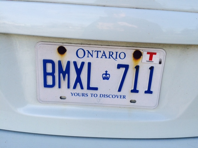

Paint looks good but I'm cringing hard at the rusting license plate fasteners. A pair in stainless steel would help immensely

LOL ^^ I use stainless screws on my own vehicles / but the white Rogue wasn't mine...sons vehicle.
- I was asked to detail SUV & get it E-tested plus Safety Checked prior to sale
I wish I had taken some Nissan before pics. / was a night & day difference, afterwards...using Novus kit.
The licence plate & fastener rust, differently stuck out like a sore thumb.
- a good 10 minute cleanup, made it presentable / wire wheeled the nut head & Extend rust converter, prior to some paint
