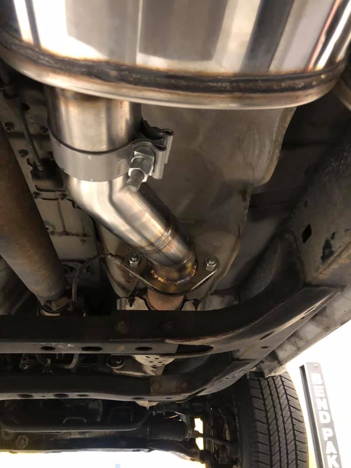

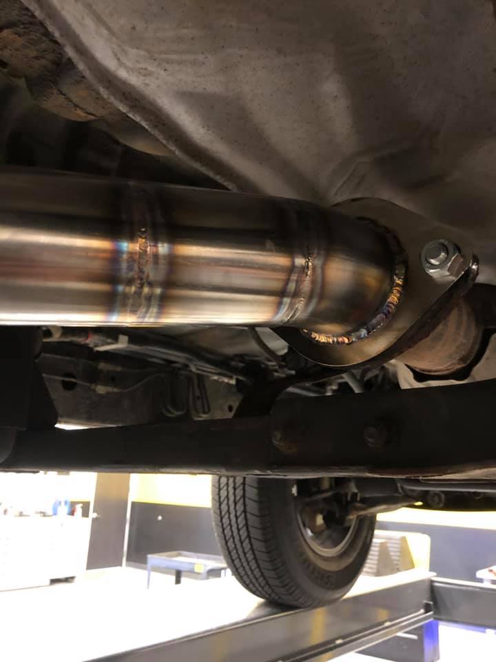

That question was asked on FB. here is what was said By Connor Rhodes he is with Magnaflow.
01-02 have an additional inlet pipe that is included
like a shorter one to allow for the 2nd cat?
Here are some images that Connor attached also
I clarified that everything is there that is needed for all years and all bolt on. the pictures are from earlier in production.
Below from Connor with Magnaflow:
the pipe for the 01-02 does not need to be welded! Everything is bolt on and clamp on! That picture is simply our first article. Far from production!

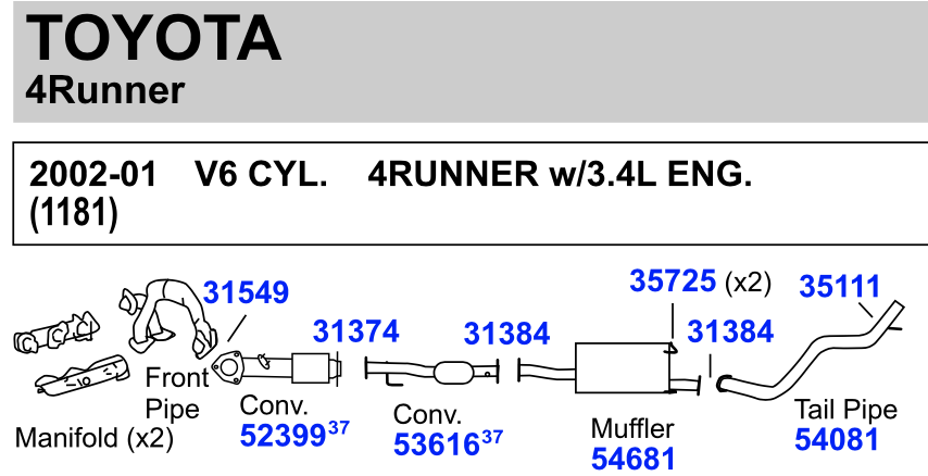

They do, but regardless of emissions standards (California or Federal) the exhaust system after the second converter is the same.
This is a breakdown of Walker OEM replacement exhaust components. There is no different muffler and tailpipe for the CA spec models but the converters do have different part numbers, the ones shown here are Federal.
