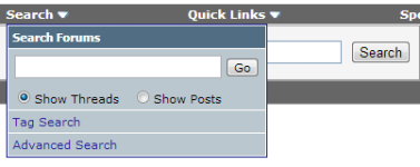

Really appreciate the feedback guys. It seems like tires are my best bet for a starting point. I am trying to search the forum for recommendations but I am having trouble with the search tool. It seems to always search the entire forum not just the 5th gen sub. Do you have any tips on how to search here?
Up top, you click Search then click Advanced Search. There will be a box where you can select which specific areas you wish to search.
