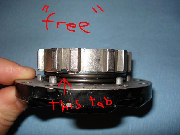

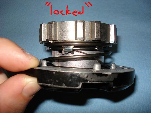

My question is what position does the dial and spring lock need to be in? Or does it not matter as long as the dial turns once installed?
Attached are two pics from ih8mud site thread.
I don't think it matters what position it is in as long as it moves. Just look to see if it turns your CV, if so, it is working correctly.
Thanks for the replies. The weather co-operated this morning and I was able to install the hubs. After installing the hub body, I made sure the dial was in FREE position and the locking spring was in the correct position. After tightening the dial bolts, I check to make sure the dial turned easily and turned the hub to see if the CV axle was turning in the LOCKED position, and back to FREE.
