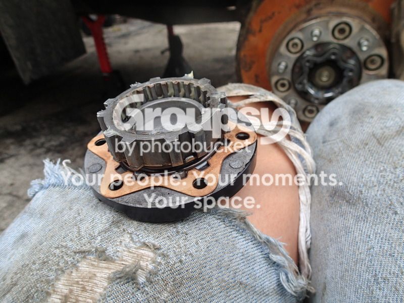

Pic for the whores
No, I can't afford new pants because I keep buying truck stuff.
The AISIN faces and internals are identical to the Tacoma pieces just a different color, the aluminum hub body is different.

Pic for the whores
045_zpsc9fbkayi.jpg~original
I know this is a weird ass question but do you shave your legs or something?

Pic for the whores
Well, Habanero's not a dude, so...yeah.
