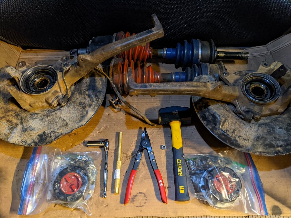

Picked mine up from a local T4R member. 30K on the bearings installed on ABS spindles complete with silicone boots CV axles

I didn't want to have my '99 apart for a long time while I had my donor non-ABS manual hub Taco hubs pressed into ABS housings, so I got some ABS uprights from a junkyard. 3rd gens are hit and miss in the PnP style yards these days, slowly becoming a bit less common, so I looked up the parts interchange and found that first gen Sequoia/Tundras use the exact same part number. And for whatever reason, those are generally easier to find in the PnP yards, so that's what I ended up getting.
And good thing, between two different machine shops, the presswork (disassemble and reassemble with new bearings) took around 2 months. The first machine shop wasn't busy, but after 2 weeks gave up and said they couldn't get it to budge. The second shop is busy as hell, because they get stuff done. But it takes a while.
Installed them with new upper ball joints (I recently did lowers) last weekend. Oh, another thing that took several months? Getting OEM rebuilt CV shafts. The donor manual shafts I got were fine, but the boots were a little tired yet. Not yet cracked and leaking, but soon. I thought it would be nice to save those as spares and get rebuilt ones. Especially since the rebuilts were barely more than the cost of new boots. And the Toyota dealer was happy to take ADD CV shaft cores in return, I specifically mentioned they weren't manual shafts, and they were OK with it. But yeah, after almost 2 months they initially came up with a pair of rebuilts, and when I went to pick them up I opened the boxes and found one manual shaft, one ADD. It took another month or so to find a second manual CV shaft.
