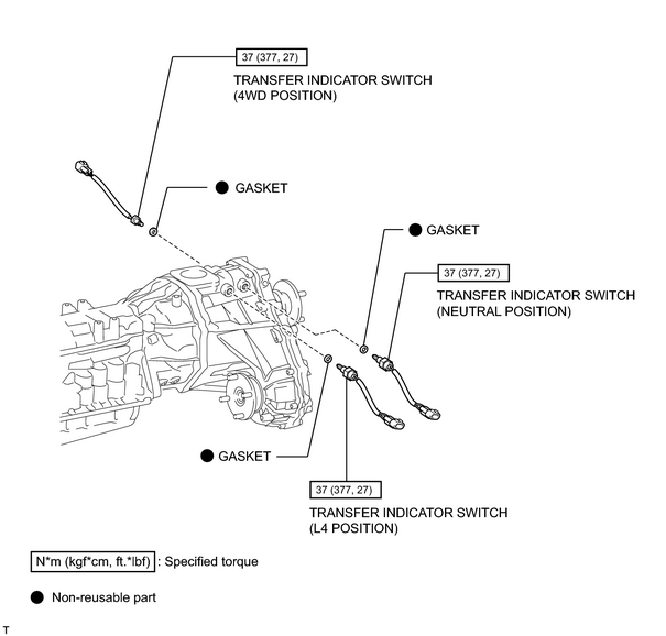

Also, correct me if I'm wrong but I thought the lever is mechanical in nature but still the tcase requires some electronic components for it to switch/operate.
Also safe to assume if it has the lever, it has a locking rear differential and multi terrain select.
If it has a dial knob, it doesn't.
Just in case the OP doesnt see it, the mechanical lever comes with the Trail/Offroad trim.
The shift forks move manually, but there are electronic sensors for position

It's also not just the offroad models. My 2012 has one and it's just a run of the mill SR5 premium. And it's definitely manual. You can tell by feeling it while you are driving. However, the actuator still has to kick in in the front axle to actually engage 4wd - which is electrical.
The shift forks are move manually, but there are electronic sensors for position
I was looking for that. Didn't want to argue without it.
But, ya you can grind the gears if your being a dummy. If your phone cord rests on the lever (steel braided) it will sing the song of the transfer case into the cab. That was my only argument without the diagram ha.
