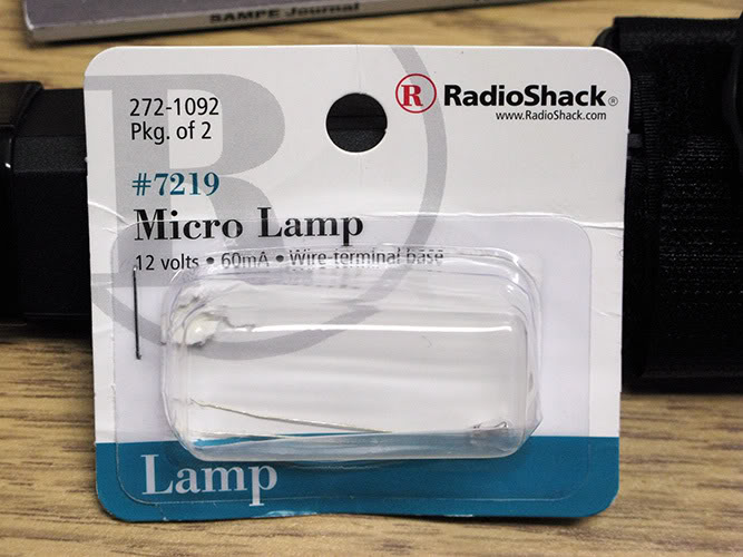

Instead of buying the complete bulb and holder you can buy just the bulbs (part # 2721092) at Radio Shack and remove the old bulb/s from the holder/s and replace it with the new bulb from Radio Shack.
Here's the bulbs you need to do this.. 2 for a couple of bucks.
Look on thiis link for photos showing how to remove and replace the bulbs, post # 13, the holders are a different size but the process is the same for the ones you're doing.

You know, Ive seen those posts about the radio shack bulbs, but to be honest I was a little hesitant to go that route. However quite a few people seem happy with the results, so maybe I'll give it a whirl.
My last car was an Infiniti, and I went through the same issues with small bulbs. I did try going the radio shack bulb route, however they gave off an orangy-yellow light conpared to the pure white light the oems gave off. This was because of a blue plastic sleeve though.

Followup:
I bought a box of ten #7219's from amazon as suggested.
They worked PERFECTLY.
If I may recommend for sanity -- when you go in to replace a few bad ones, just go ahead and swap them all out. I ended up having to redo it all. The new bulbs were significantly brighter which was annoying, and then one of the old ones burnt out the same week.
Thanks all!
