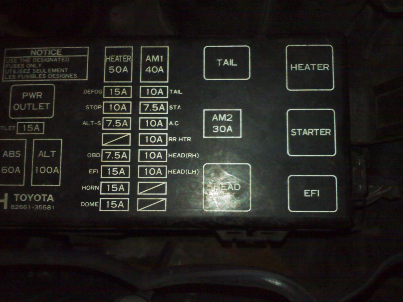

So I just noticed a few minutes ago that my front marker and corner lights are not working. All four of them are out. I have no idea why. No recent changes, other than my headlight housing. Didnt change the bulbs though. I mean I changed them about two months ago. But all I changed last week were the actual headlight housing assemblys. So what would have caused this, just a fuse?
By the way which of these are the front marker and corner light fuses? Im guessing the two 10A left and right Head fuses are the marker lights, but which are the corner lights?

Alright, so everything works except for my front corner lights. I was mistaken about the front bumper lights. For some reason I thought they were always on. But they are only the turn signals, and they work fine. So I just dont have the corner lights. I'll be honest, I know nothing about lighting, wiring, relay, etc, so when I look at those diagrams without anyone to explain them I just get confused.
Anyways, everything on the tails work as well. So the 98 must be different than 99+. So any other ideas?
If its just the corner lights that aren't working, I'd start by going back over your headlight swap, and make sure all the wiring harnesses in that area are connected tightly, no wires pinched, etc. Grab some new bulbs and make sure they didn't just burn out (maybe you shorted something while working on the headlights and popped them?).
