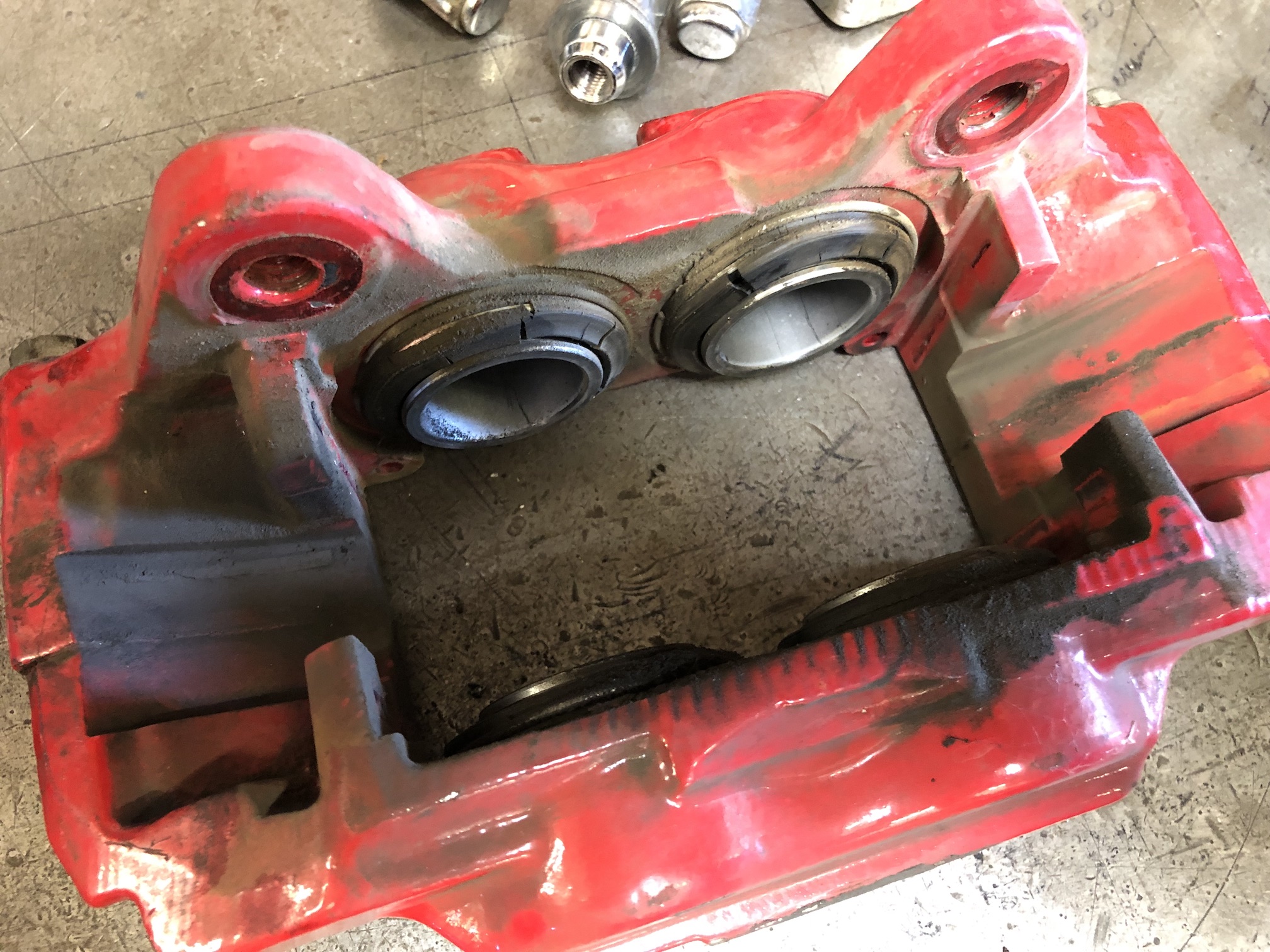

Another update:
After bypassing the ABS unit, replacing the rear brake line, and doing a few other tests, it turns out that my calipers were bad. I bought them from eBay. They were red and shiny. Anything red and shiny usually gets me in trouble. I went to O'Reilly Auto and bought their lifetime Tundra calipers. I told them it was for a 2005 Tundra 4x4 V8. Put them on, and they work GREAT!
My truck's brakes work again! And they're amazing... especially with the upgraded master cylinder.
Here's what POS ebay calipers look like after less than 18 months of use:
Hope this helps someone.
Another update:
Glad you got it figured out, but FYI, you can buy caliper rebuild kits for $20. That would take care of your seal issue there.

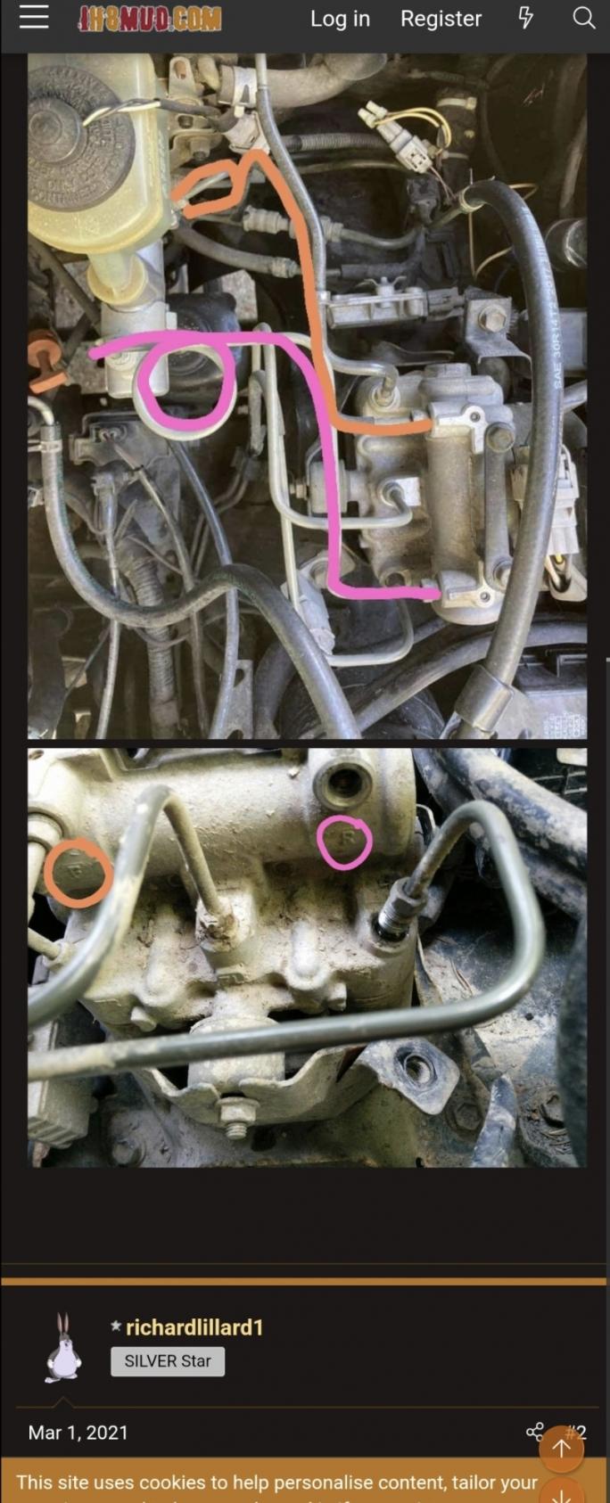

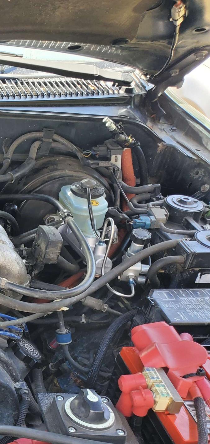

Sorry to bump an old thread. Just ordered the fj-80 master and booster for my 3rd gen.
Dumb question, do you plumb the front brakes to the port closest to the firewall or furthest?
The fj80 is reverse of the 4runner. The front is the rear port (closest to firewall) rear is the front port. You will need to make a new short adapter lines for the front and rear. Also iirc, the fj booster is installed 180 degrees (rotated) so the firewall studs line up, then reinstall the fj master. Don't mind the the prop valve as I converted to disc in the rear.
Thank you for the info. Just to double check.
Closest to firewall -> front brakes
Furthest from firewall -> rear brakes
I think I have the same prop valve, but I like where you mounted yours better.
