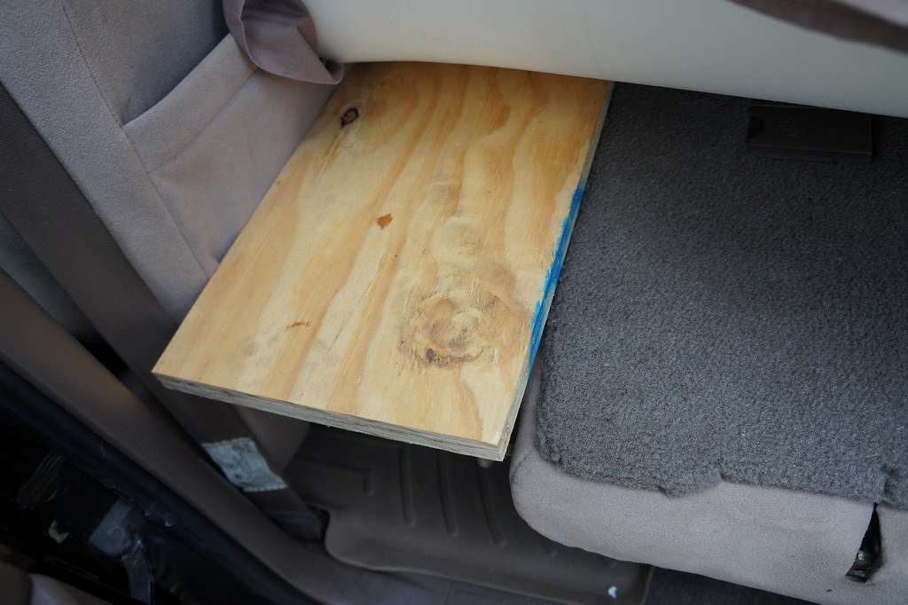

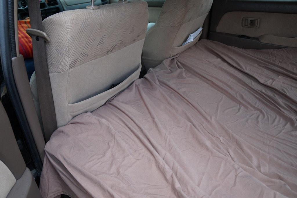

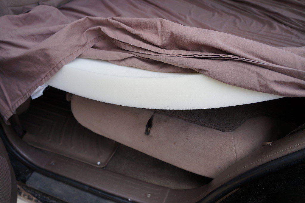

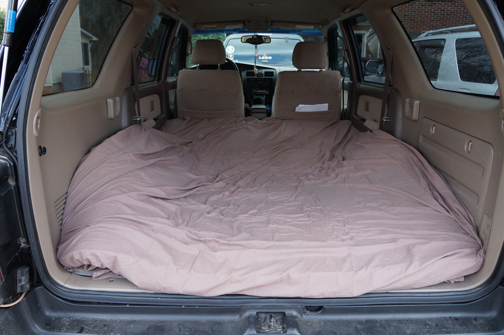

This is what I use for a mattress.
The Foam Factory, Mattresses, Conventional Foam
I got the 2" full size one and it fits perfectly. The good thing is that even if you build a sleeping platform this will still sit on top of it and be the right size. I used to take the hi-lift off the mounts in the back, but this weekend we tried just laying the mattress over top of it and you couldn't even tell it was back there so that's one less thing that needs to be moved when setting up.
Yeah I do remove the seat bottoms. It gives a lot more room actually. I can lay back there without touching the hatch door or the front seats and I'm 5'11".

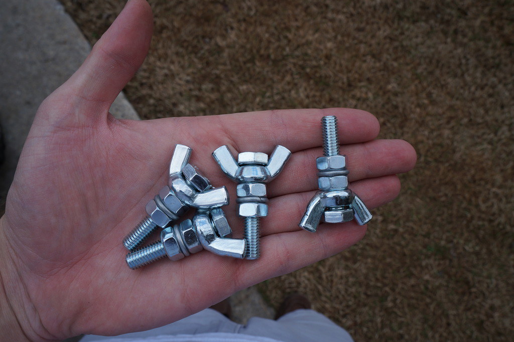

I made my own wing bolt things like you're talking about. I wasn't gonna pay $75 for them so I made my own for $5.
Here's the post from my build thread about it.
I made these quick release bolts for my seat bottoms so it's long enough for me to lay back there now. Simple set up, Just a M8x1.25 bolt, a 3/8" wing nut, and some M8 nuts and washers to clamp it on. They are sturdy, you just have to turn them a little to flip the seats up depending on how they are lined up at the time. Then I cut a piece of plywood to lay across the front. Just flip the headrests around and you've got a good support for the wood. Throw a 2" foam mattress topper on there and you've got a pretty decent bed.
