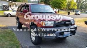

My old 01

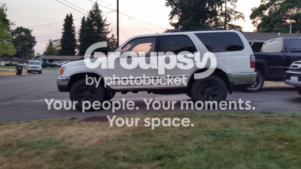

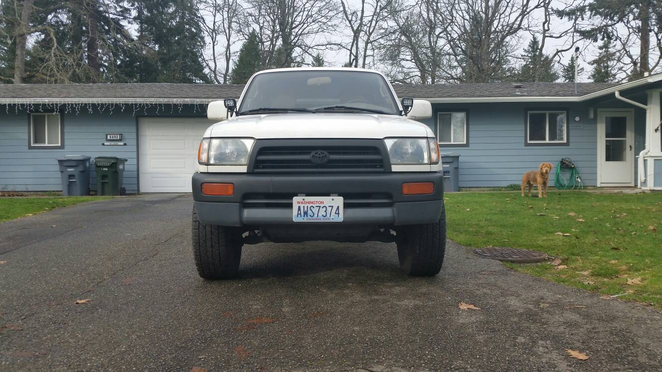

The first pic of the 1997 with the chrome flare things and mudflaps

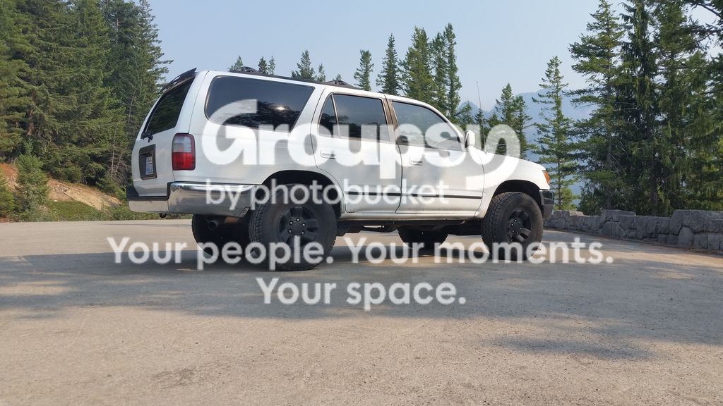

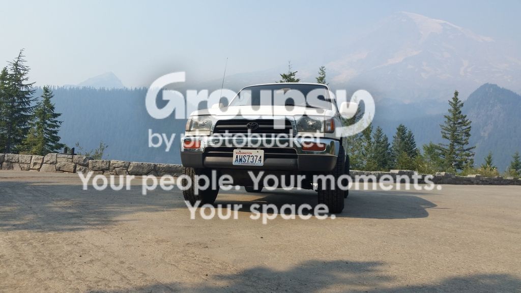

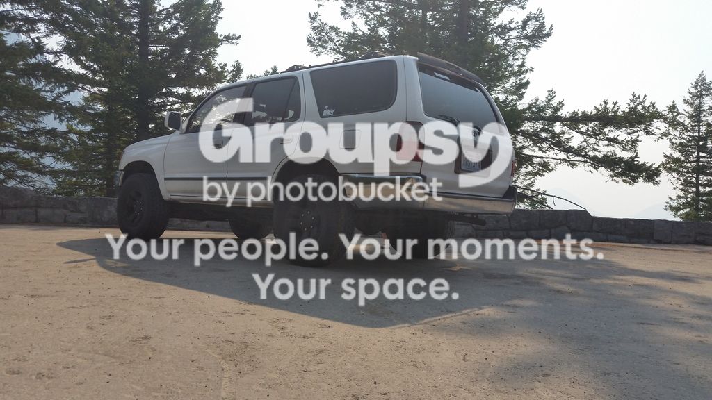

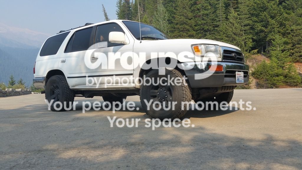

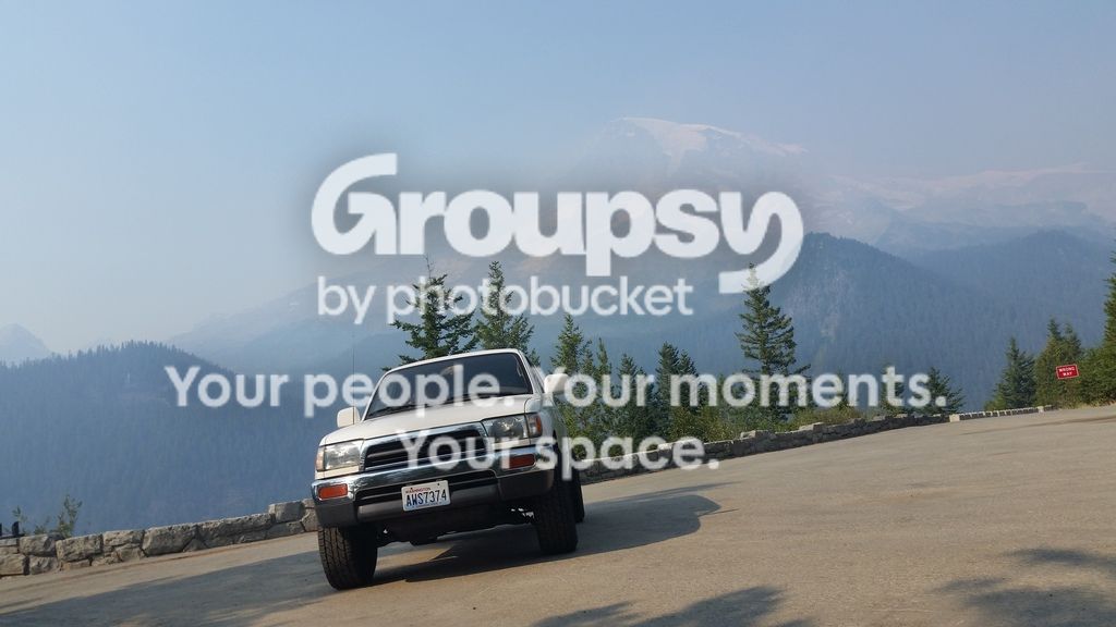

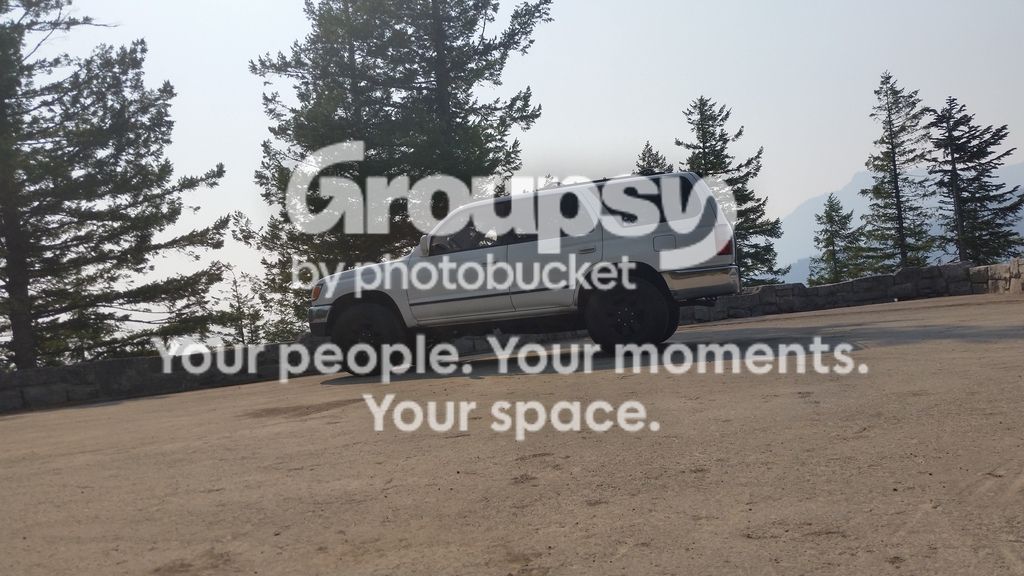

First batch of pics after I replaced the TB,WP and what not. Also all the fluids, belts, and radiator were changed. Then we took it to Rainier while my dad was in town.
The Fires made it pretty hazy out there even at 5400ft

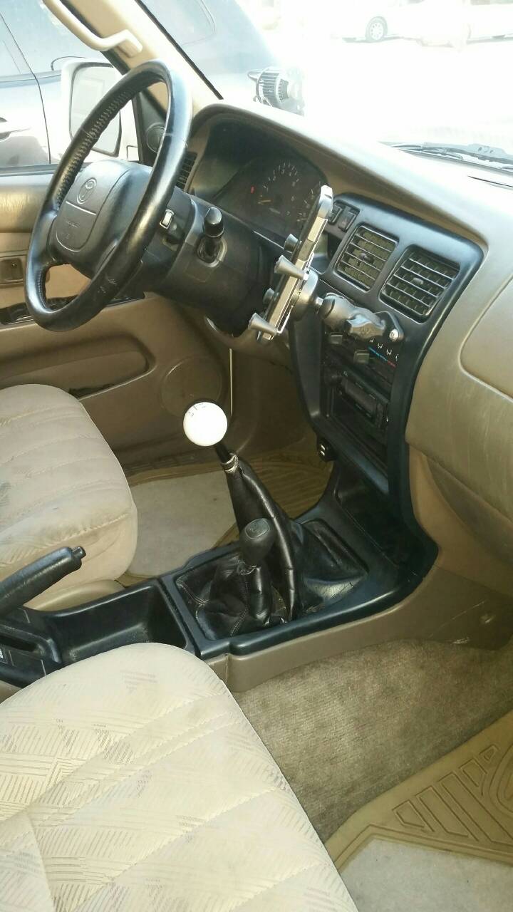

Recently moved to El Paso, TX and have no idea where anything is, so I was in the market for a good phone holder. I can just set my phone in my wife's 03 4runner's cupholder. Unfortunately I haven't found a good 99+ console yet so no cupholder for me. Looked at all the cheap options and decided to splurge a little and go with a RAM mount. It is very sturdy and is in the perfect position for me. I cannot stand anything on the windshield or blocking even the slightest bit of my vision out the front. One of my pet peeves I guess. All I have to do to run my 7 inch tablet with backcountry navigator GPS is get a larger cradle for it, but for now the phone will work.
