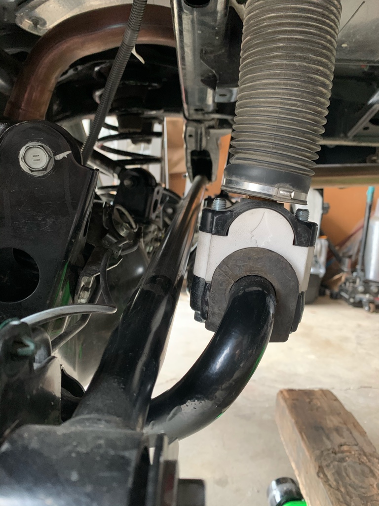

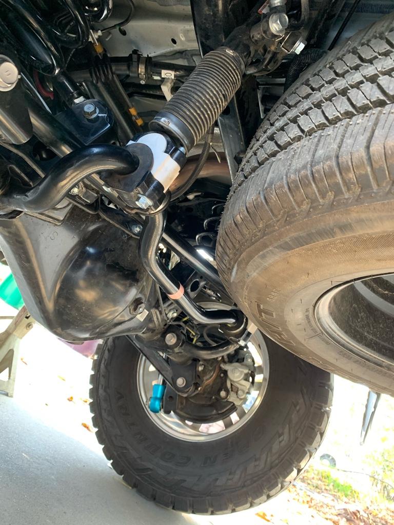

Ok this my version of how to maximize the kdss equipped 4runners that have a lift and extended travel shocks. I know there’s that Sonoran steel zigzag track bar. But it just wasn’t for me. Plus the tolerances are tight. If you don’t run stock length links or if your axle isn’t in same location as stock, things will crash into each other. I personally didn’t like that , and the look of it. It could also have better joints as well. Totally not taking anything away from it as it’s an awesome idea. It just wasn’t for me.
Originally I was going to do my own version of a bent track bar ( and did ) but when I was test fitting it, a light bulb went off in my head. I got together with a long time friend Don Thuren ( thuren fabrication ) and came up with this. It works like a charm.
Here’s a link to my instagram so you can see a video on it.
Dom R on Instagram: “Here we go.... prototype kdss drop!!! Posting for time stamp while lawyers put together and file the patents. .. This is my fix for the…”
You can now run a straight track bar. Even the stock one which I have on the truck now. With that said I’ll make a straight track bar that utilizes more superior joints then what factory comes with. If you know about factory style bushing / joints. You know that it’s not designed for anything longer stock suspension travel.

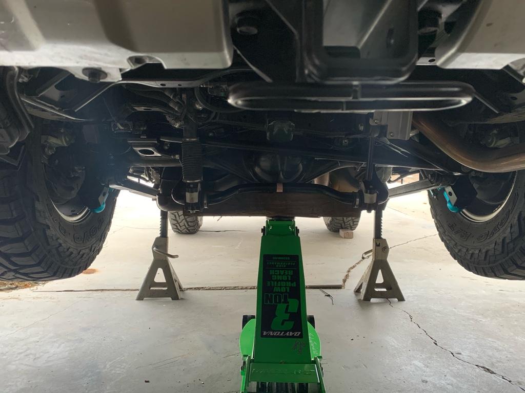

Full articulation . Yes that’s a harbor freight floor jack. Don’t hate lol.

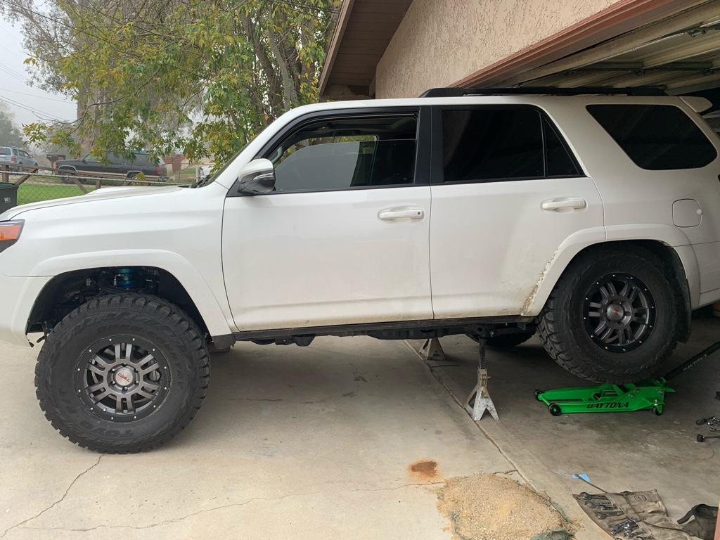

Ride height on 2” lift.
Full droop.

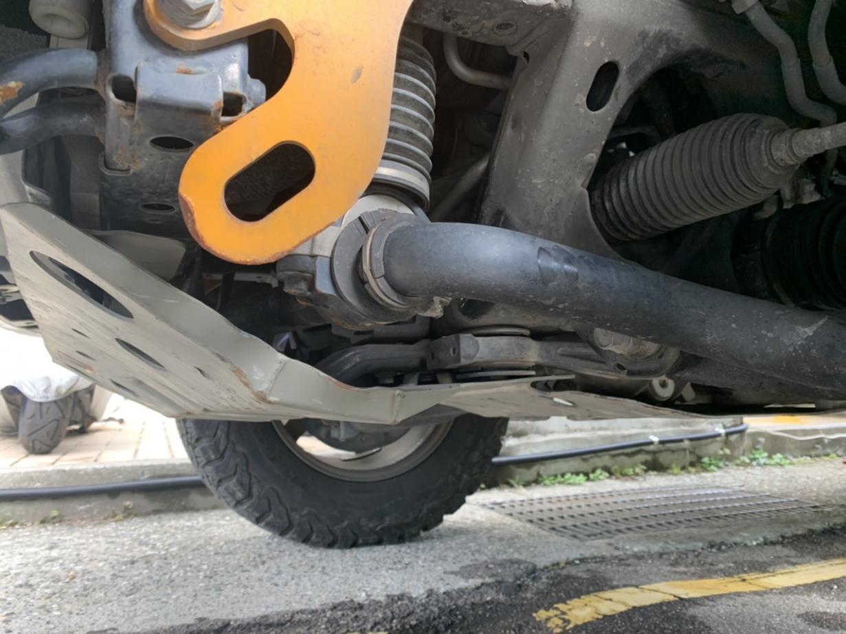

so like i said on IG, when's the front fix coming to put the sway bar in a neutral position on the LCA bushing bracket? :)
Totally will do something to fix that.

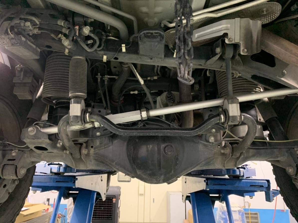

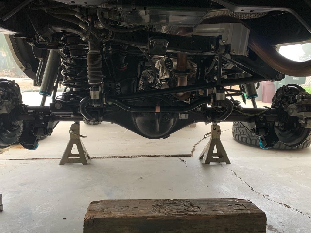

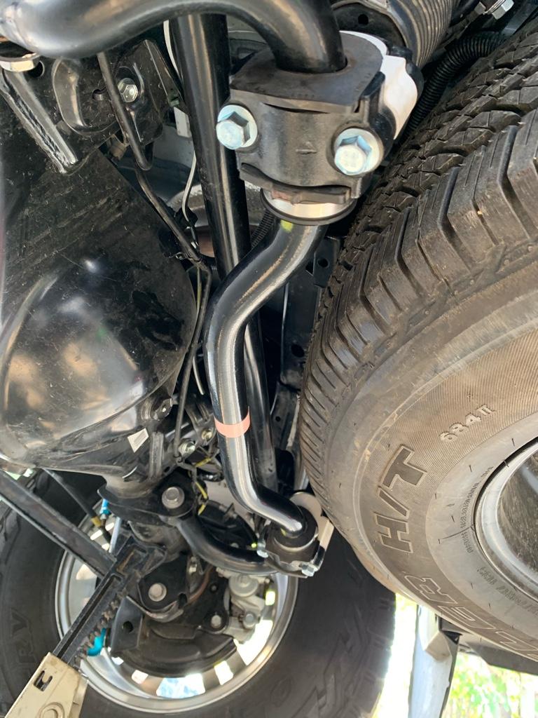

I’ve done this in 2017, the lean in the front is about 10 mm only. I’ll say it definitely helps.
The way I think is, if you didn’t add the pad to the rear, there will be more pressure in the rear to pull down the KDSS cylinder, and since the front and rear KDSS path are connected, it may create opposite pressure in pushing up the front cylinder and then make the lean worse.
The pad actually helps releasing unexpected pressure to the KDSS cylinder caused by the lift.
