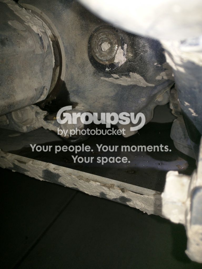

Well, you play and you pay I suppose right? Cleaned all my terminals, still got a click/delay/start and while I was checking connections I found out my driver side CV is now leaking gear oil. I'm assuming that's either a seal or a bearing.

Bummer about you diff leak. The cv is only held in by the pressure of being sandwiched between the spindle and the differential. I would guess that it is possible for the cv to become loose against the seal with modified suspension during times of full down travel. It might of let some mud get into the seal causing it to leak. Either way I would pull the cv, replace the seal, and change the diff fluid since if oil got out, that means mud and water got in.

I'm probably just going to replace the starter today while I have the axle out for the seals and the knuckle is pushed out of the way. There's not a whole lot of room in there and I might as well just put a brand new one in for peace of mind. At least I should be good for another 100k miles on the starter and I'm staying away from deep water for awhile, haha.
