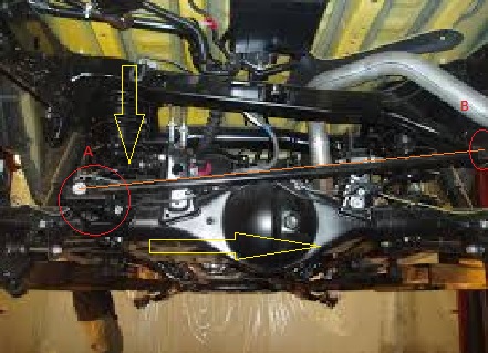

What you are seeing as mentioned above is your rear track is offset due to the suspension being forced down in the rear. See Pic
As point A is forced down (as in when you install a lift) it will move the axle slightly to the pass side. the effect is compounded by the fact the drivers side pulls in at the same time the pass side pushes out. In reality it's less than 1/4 inch, but looks like half.
On a non adjustable track bar point A and point B cannot change, so the axle moves slightly side to side as the suspension cycles.
nothing to worry about FWIW
