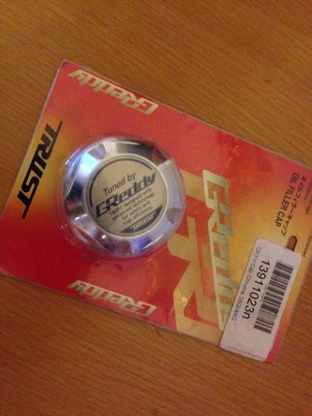

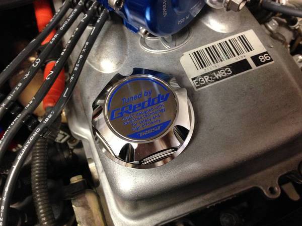

Well, I added a couple things to the 4Runner recently. First was a GReddy oil cap a few weeks ago - looks pretty sweet under the hood, and it's made in Japan, so you know it's awesome (plus it adds at least 15hp...lol). I got one of the last ones on closeout for $30, which is an awesome deal IMO.

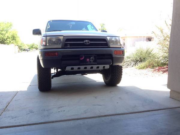

I also installed the sport skid plate from the 2001-2004 Tacoma on my truck yesterday. It is a straight bolt-on for 1996-1998 4Runners, but for 1999-2002, you need to make some bracket extensions to accommodate the fat-lip bumper. I got it from toyotapartszone.com for about $100 - not too bad IMO.

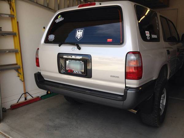

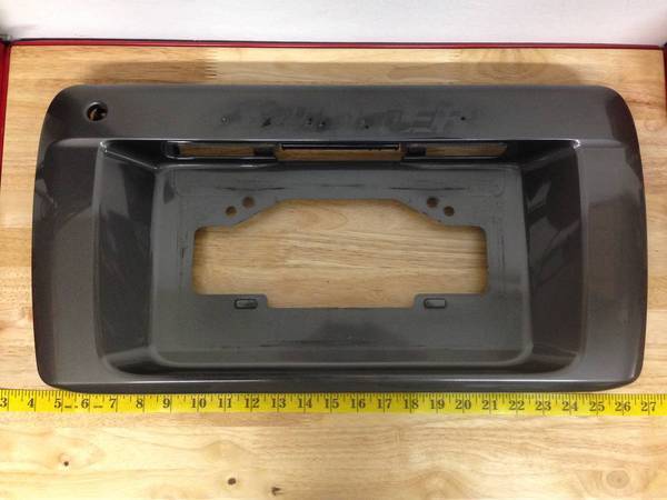

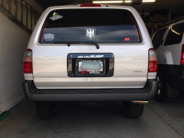

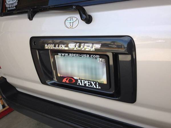

Finally finished the installation of the Hilux Surf emblem on my runner today. It was a bit more involved than I originally planned, as I ended up needing to get the license plate trim piece (rear garnish in official Toyota terms) repainted. Here is what it looked like once I got the 4Runner emblem off.

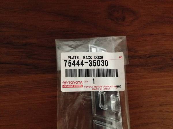

The removal of the trim piece was very simple; I just had to take off the plastic panel inside the tailgate, the metal panel under that, and then was able to get around the rear window mechanism to take off the trim piece. Anyway, pictured below is the part number for the emblem if you are interested in doing the same mod, as well as pictures of the finished product. Also, for those with 96-98 4Runners that have the emblem installed on the license plate trim like mine, keep in mind that the 4Runner emblem has pegs that insert into holes in the trim piece, but the Hilux Surf emblem does cover those holes up perfectly.
Part Number
Close up shot
Shot from the side
Straight on from the back

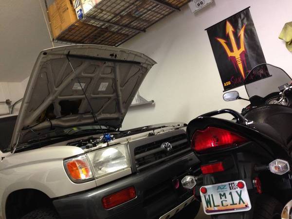

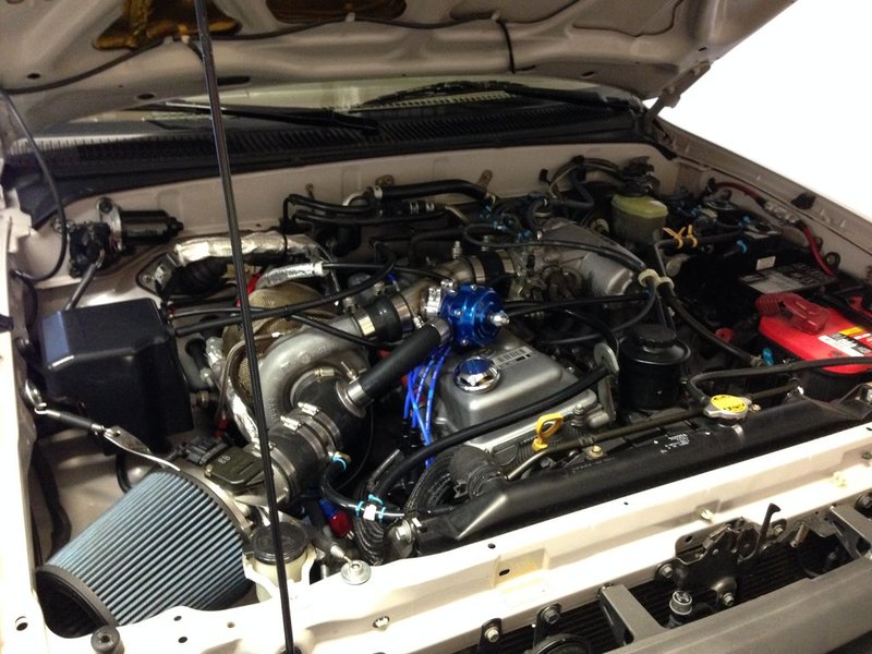

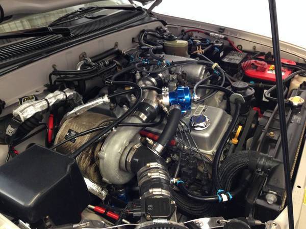

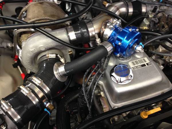

Small update. Finished up a bit of work on the truck this week. I got tired of the VTA BOV really quick, as it caused the truck to stall when braking abruptly in heavy traffic, so I converted my TiAL Q to a QR. It runs 100% better now, and has better pickup after venting, too. I had to get pretty creative with the mounting for the recirculation line to the pre-turbo intake elbow by punching a 15/16" hole in the 45° elbow, followed by using RTV to secure a 1" aircraft ducting fitting on the inside and a cut-down 1.25" fitting outside for the BOV to recirculate through.
I also wrapped the MAF wiring harness that sits above the downpipe with a DEI heat shield, as the engine bay gets quite hot and the last thing I want to do is melt important wires.
Of course, here are some obligatory pics (and YouTube video) of the new setup.

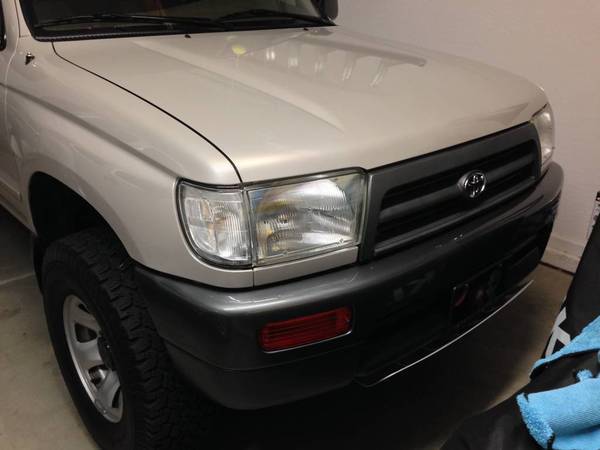

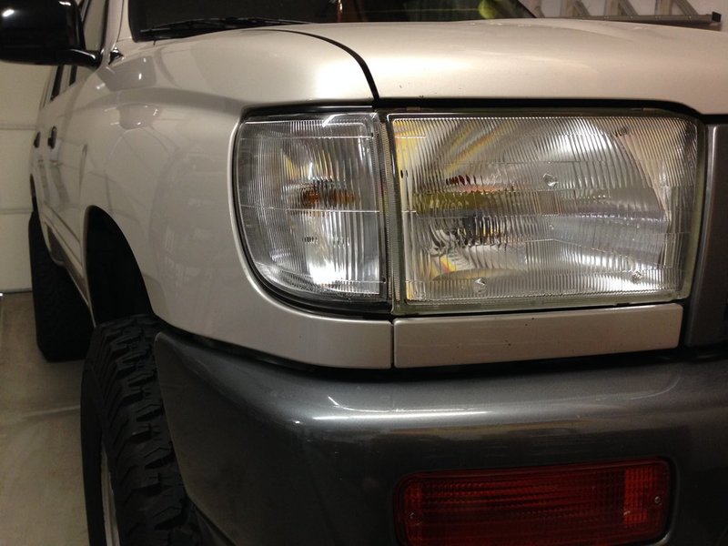

A few weeks ago I undertook the rather laborious task of cleaning out my headlights - they came out very nice IMO. I also had my EFI relay take a crap last week - truck would run fine but when I put my foot into it, would go full lean for a sec (fuel cut), and then would kick back in. When the relay really started acting up, the truck would die at a stop while in gear. Replaced with OEM Toyota relay (Denso equivalent didn't work for whatever reason - truck would run full rich), and HOLY CRAP the truck runs so much better. I always thought it ran fairly smoothly, but DAMN, with the new relay, it idles and accelerates like butter, and the ECU responds significantly faster with regard to fueling (i.e. richens the A/F mixture faster when under throttle).
Moral of the story: replace your EFI relay. Seriously, if you haven't done it before or if you don't know if it has been done in the past, it's only $20 and made a world of difference in how my truck runs.
Anyway, here's a pic of the clear corners and the headlights after I cleaned them.

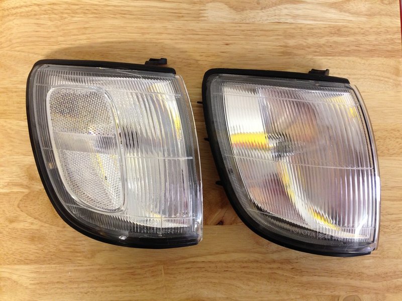

Another small update. Last week I managed to get my hands on a set of OEM J-spec marker lights through the classifieds here (thank you [MENTION=30949]SIKHILUXSURF[/MENTION]!). Got them installed last weekend, and they're such an improvement over the cheap aftermarket clear corners.
Here's a side by side comparing your typical aftermarket light to the OEM JDM light. Notice the difference in clarity and how straight the lines are on the OEM one.
