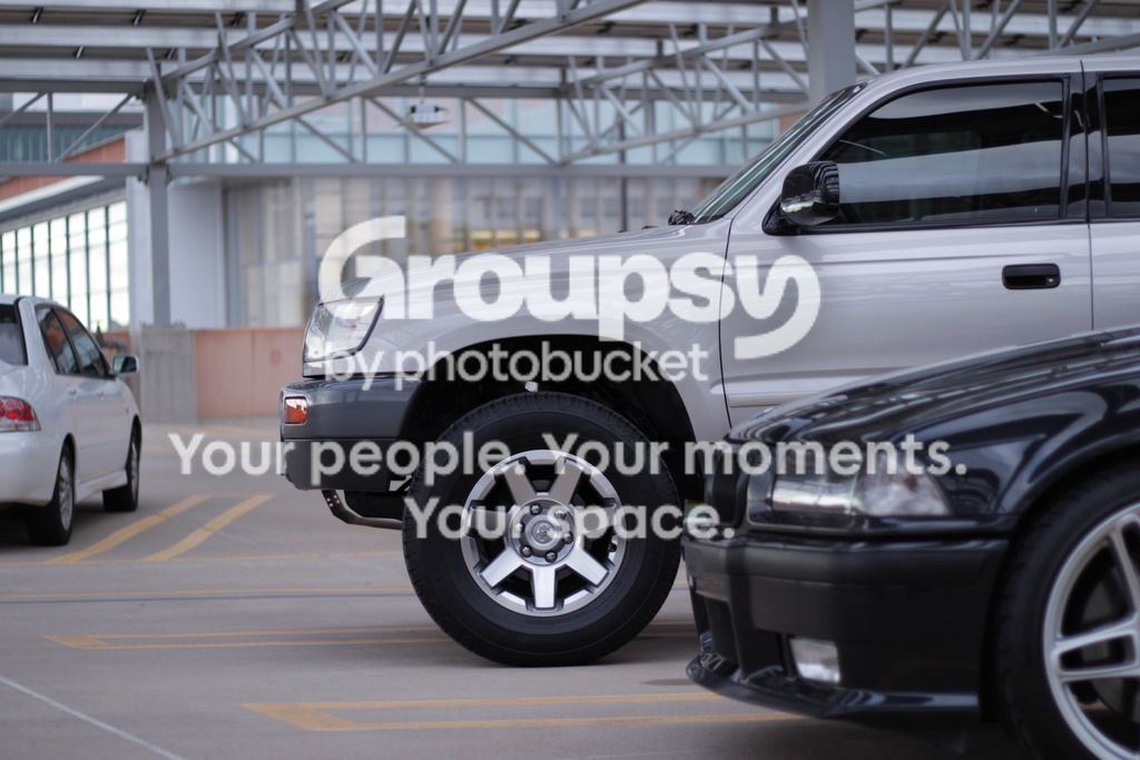

I recently picked up a set of the same wheels that you have on your truck. They do a wonderful job of setting the vehicle apart from the others.

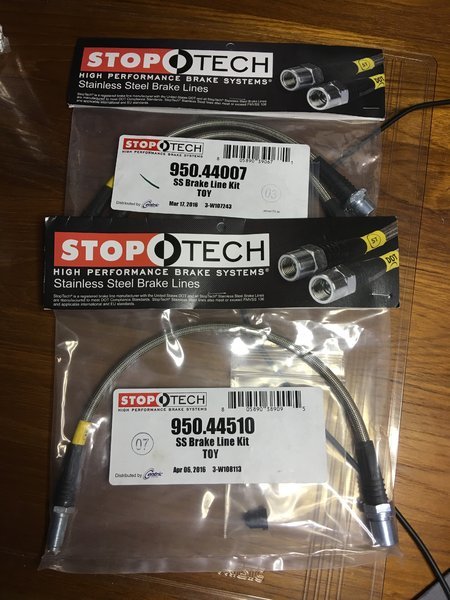

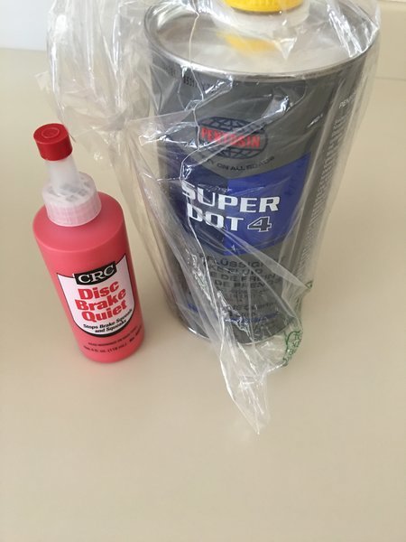

First off, I have had a pull when braking that has been getting progressively worse, with old pads being the suspect. I figured while I was replacing the front pads, I'd upgrade to stainless lines all around while at it. I ended up going with StopTech lines since I've had excellent experiences with them in the past, this time being no exception, and I used OEM pads with Pentosin DOT4 fluid as I always have. With everything fresh, the brakes feel a whole heck of a lot better - a lot smoother than before, and nice and stiff. Here's a couple pics showing the lines and fluid I used:
I also shot videos showing the process of replacing the pads and lines. I have the rear line and brake pad videos finished and uploaded, and I should have the front line video done later this week. Here's the ones I have finished at the moment:

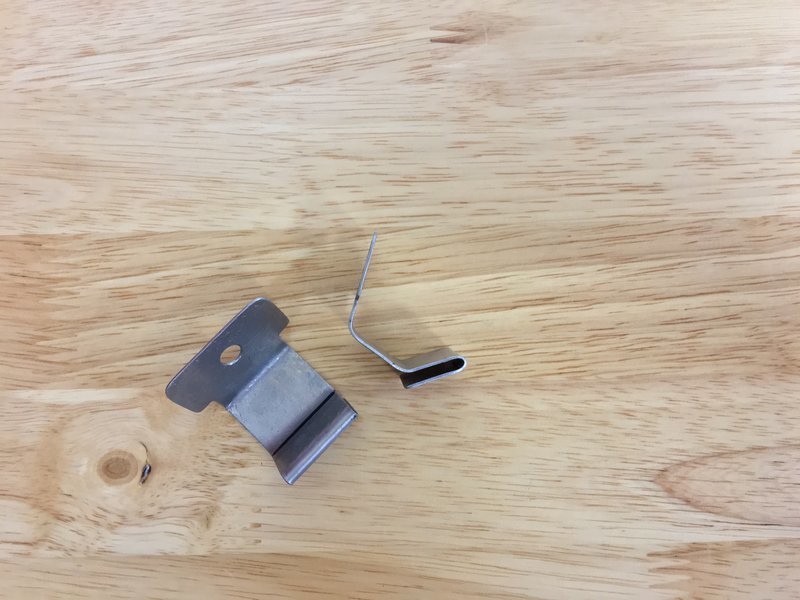

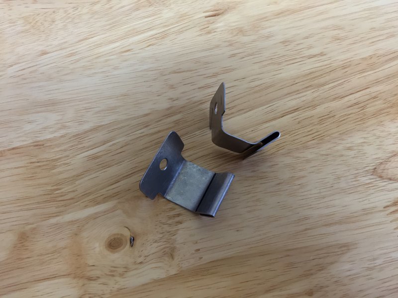

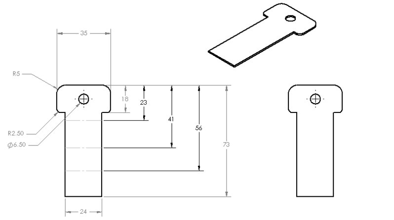

I also got my spoiler brackets bent up this morning...they came out damn good considering I don't have any proper metal working tools. I used my milling table to rough cut them out of 20g (IIRC) 1020 steel, then filed them to shape and bent them using my vise and some wood blocks. They fit just like the OEM brackets should as far as I can tell. I made a couple changes to the final design, so I will update my drawings and upload them here soon in case anyone needs to make the same brackets in the future. Here's what they look like before any paint...I may need to slightly widen the portion where the bracket is folded over in order to accommodate for the thickness of paint as well as paint protection film I will be applying to the truck, but they are done for the most part.

Just a really quick update, I got the video for front brake line replacement uploaded a little while ago. Here it is for anyone interested:
I definitely recommend the StopTech lines if you are in need of replacements, they are half the price of OEM lines, fit like they are factory, and the brake feel is definitely improved over rubber lines. The spoiler is going to be painted and installed soon and at that point I will start working on my headlights, so stay tuned for more build action coming soon!
And as promised, here's the drawing for the lower spoiler bracket in case anybody needs to make one in the future.
You can also click here for a printable PDF version of the sheet. If you print it at 100% scale (1:1), you can cut out the template on the right side of the sheet if you plan on cutting out the brackets manually. Hopefully someone finds this information useful!

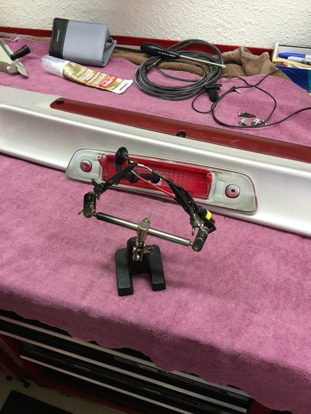

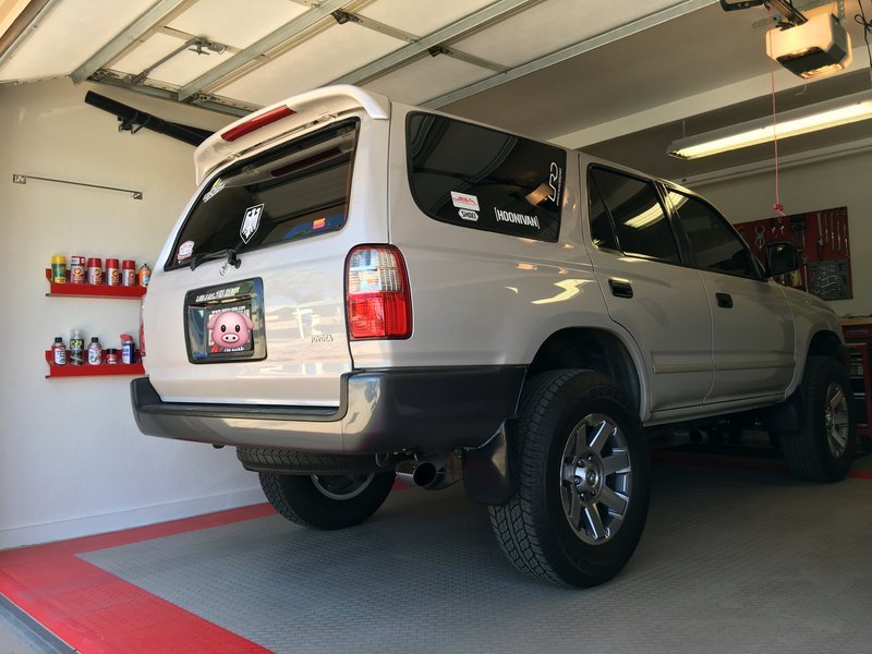

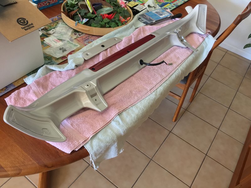

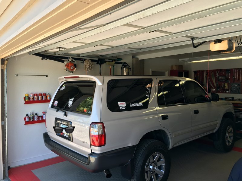

Finally got the OEM rear wing installed! Pics below...next up, retrofit!
Fresh back from paint:
Cutting some clear protective film for under the brackets and legs:

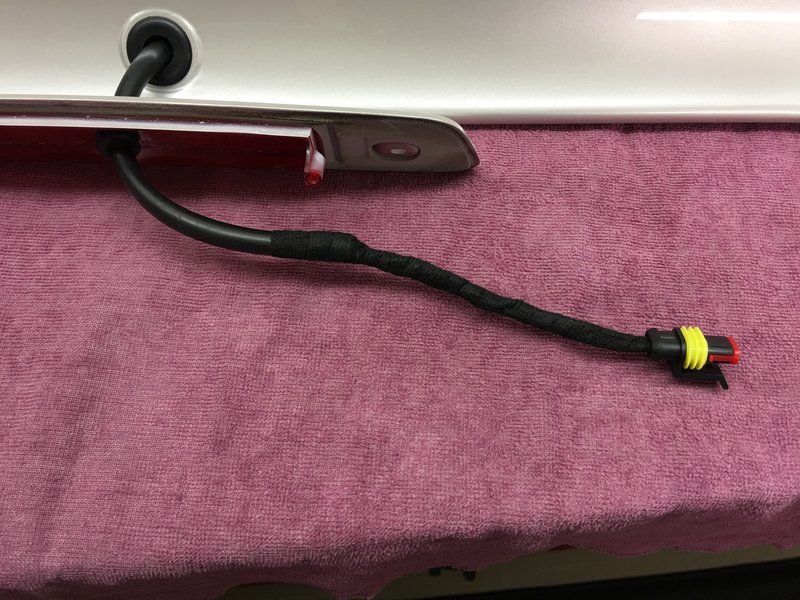

Getting the new connectors wired up for the brake light:
Wing-side harness done:
Installed!
That actually looks good! You say OEM so is that one of those Hilux parts?
Yep, it's off of a Hilux Surf SSR-G. It's the one JAOS (now discontinued) and Burtman replicated, but the OEM one clamps on (I'm vehemently opposed to drilling into unmolested sheet metal on this vehicle). You can find them fairly regularly on Yahoo Auctions Japan, but they're not exactly cheap to import over here. I got lucky and got it from a forum member for a good price missing the lower brackets, which I made (detailed a page or two back). It's one of my favorite visual mods you can do on a 4Runner, and it's super unique...never seen another one outside of the forums.
I saw your ad in the classifieds, but I prefer turbos on imports. I want to keep my engine relatively stock anyway, at least until it is rebuilt in the (hopefully) distant future. GLWS though!
Got the video of the wing install finished and up on YouTube, embedded below. I will be test-fitting the aftermarket JDM headlights this week and ordering retrofit parts if the fit is to my liking. Stay tuned!
Wing looks great! you have way more patience than me haha.

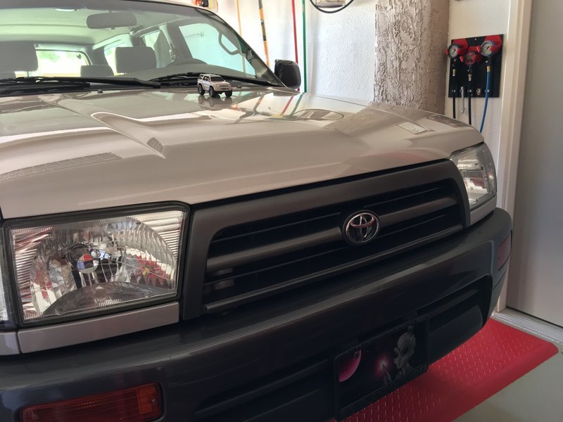

Haven't posted an update in quite a while, but not much has been done to the truck. Right after I finished up installing the Surf spoiler, I swapped out the Zenki (96-98) headlamps and corners for Kouki (99+) ones; headlights are OEM from a 2002 4Runner, corners are imported OEM from a Surf. I also put on a new aftermarket grille to tide me over until I have some more parts to get painted along with my OEM grille, although I may just tackle that respray myself with some proper paint.
I also took some time and built a Tamiya Surf model, painted in Desert Dune to match my truck.
At this point, most of the parts I want for this truck are ones that are very hard to come by, so I am planning on simply purchasing them when they become available for a price I'm willing to pay and working on further installs at that point. Because of that slowdown, and because I needed a test vehicle for a thesis project at my university, I picked up another car - 2002 Lexus GS300 Sport Design, 1 owner, under 100k miles (although I'm about to roll over that soon). Some very interesting things will be happening with this car in the near future (stay tuned to my YouTube channel here if you are interested in following that project), and I'm stocking up on cosmetic parts for once that thesis project is complete, but for now, here are some shots of it with the Runner; you can also see those new headlamps and corners in the first pic.
This truck is definitely still my favorite vehicle I own, so there will most certainly be more updates in the future, though when I can't say for sure. Until then, thanks for reading!
