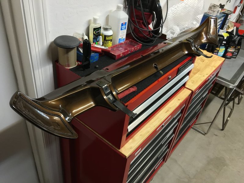

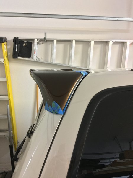

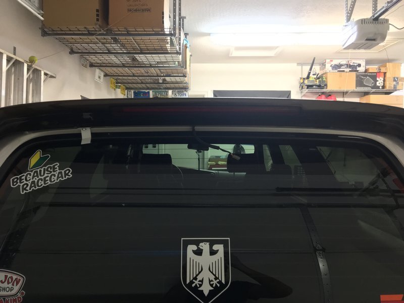

Well, even though my grill getting messed up this week was a downer, I finally got in my OEM Hilux Surf rear spoiler (thank you [MENTION=74071]Brilliant[/MENTION])! I've been wanting one of these suckers for a LONG time, so needless to say I'm pretty damn pumped. I will need to paint it to match my truck, bend one of the upper brackets into shape, and make the lower brackets for it to mount, but after that I can get it on! Assuming everything goes according to plan, this will be the next mod to get installed, followed by the projector retrofit. Stay tuned!
Oh, and the spoiler in all its bronze glory:
Nice. Do those black brackets sit directly on the paint? I would put paint protection film in the areas they contact.
Indeed they do, and I already have the film on order. Last thing I want is to scratch my original paint. For the side areas (the very ends), there is also foam tape (that needs to be replaced) which is to prevent scratching, but I will definitely put PPF under those areas as well. Should be a pretty straightforward process once all the materials are in - waiting for a small brake to bend the new brackets up, along with the 20 gauge sheet metal for them, the clear film, and paint for the spoiler. Hardest part will be finding the time to get it all done with the new semester having started.

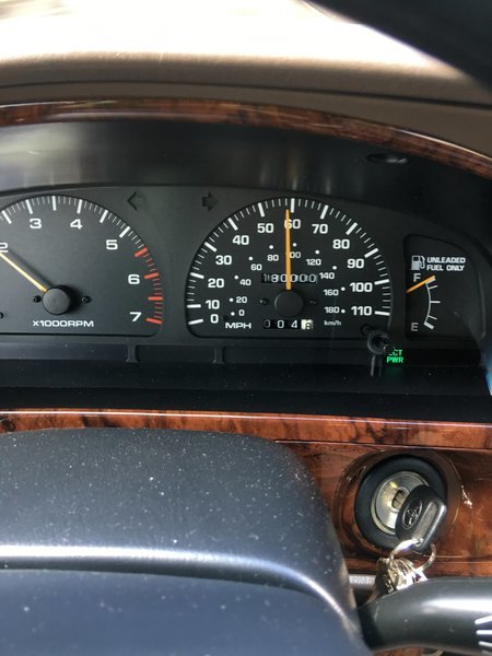

I've been daily-ing the 4Runner for a while now, so I've been racking up the miles. Hit a milestone on the road to 200k+...pardon the dust, I've been enjoying the last bit of time I can drive windows-down before the 100+ degree summer days.
I'm at about 15k miles since turbocharging, and once I got all of the tuning issues worked out no issues at all since with the exception of a recurring exhaust leak between the turbine housing and downpipe...hopefully I have that resolved now.

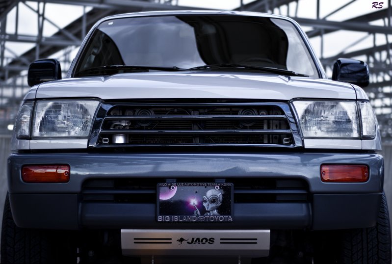

Here's a pic I never posted from a photoshoot I did with a friend of mine last year...the truck should have a slightly updated face next time I post a major update.

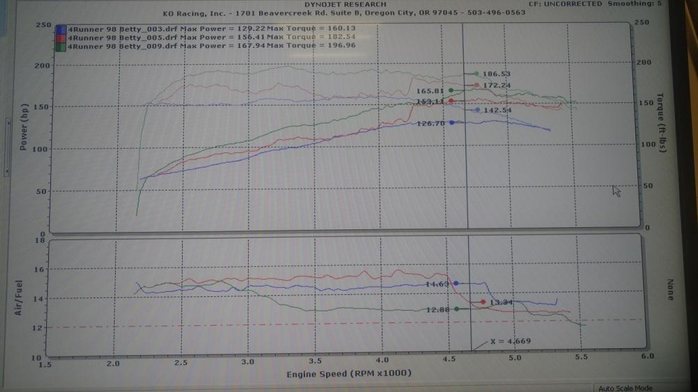

Nice looking 4runner. Your videos are great and I like your attention to detail. I think you might be over estimating the actual horsepower though on the 3rz at the boost level you are at. I bought my 4runner at 215K miles (had perfect compression, 180-180-181-180 on the cylinders)and we installed the Enforcer turbo kit (T3/T4 46 trim) on it. Bone stock with a cold air intake tube and K&N filter it put 130 whp on a dynojet chassis dyno, and with the enforcer kit it did 156 whp (stock computer untuned). After adding an AEM FIC-6 piggy back it made 170 whp. This is with all stock engine components and the AEM piggy backed on. I didn't like how the AEM idle worked though so sold it and am running just factory computer again but working on some other upgrades including a Hydra EMS full stand alone. Kris of KO Racing is my brother and I work at his shop sometimes to help out so just wanted to say thanks again for your posts and input as well as help you out with some real numbers. Have a good day! I'll be putting up a build thread for "Betty" soon (my 1998 4runner 4x4 3rz 5-spd manual). Keep up the good work!
Interesting, do you know how much boost you're running on your truck? The dyno sheet on the KO Racing site (also from a Dynojet dyno) shows 175 whp/185 lb-ft wtq for a 2WD Tacoma @ 4.5 psi. My truck definitely keeps dead-even pace up to some sketchy speeds (tests performed in Mexico...lol) with a couple supercharged 5VZ trucks (both Taco and 4Runner), so your power figure seems a bit low to me. I can't remember if I'm running the 4.35 or 5.8 psi spring in my wastegate, but my peak boost is in the 5-6 psi range.
I will say that my truck does heatsoak very badly, so if you were idling for a while before your turbocharged dyno run that might have caused you to be down on power. During the summer here when it's 100-115 degF out, I barely drive the 4Runner because heatsoak happens so quickly and I lose so much power due to the extremely high IATs.
Looking forward to taking a look at your build when you get it started. Those of us with street-focused builds are definitely few and far between!
My 4runner is a 4x4 so that might explain some differences also over the 2wd 2rz, and if I remember right that 2rz was on a stand alone engine management computer, but other than that, it should be a more apples to apples comparisons (3rz to 3rz). My 4runner was dyno'd at the same place the 2rz truck was dyno'd before KO Racing (my brother) got his own in house 224 DynoJet chassis dyno. So all future testing (yes we test a lot) will be done on that one. My boost gauge shows 5-6 psi, but the actual number (autometer isn't super accurate) was not recorded on the dyno as the shop we used to go to didn't have a transducer set up to record boost. It will be on the dyno sheets in the future. I've kept up pretty well with my 4runner with v6 vehicles off the line, and she had no troubles hitting about 110 mph once on some open back road. Ill overlay the 3 different dyno plots with the AEM turbo charged (green), stock computer turbo charged (red, it pulled timing in the middle rpms, as seen by the dip), and stock before turbo charging (blue) so you can get an idea. Some sort of tuning computer helps a TON, needless to say. :) I might have been able to get the AEM to idle better if I kept playing with it, but for my ultimate goals, stand alone is the way to go and just swap back to factory ECU when it comes time to go through emissions again.
The dyno on the website specifically states stock ECU, but as you said perhaps your truck being 4WD makes a decent difference. I believe the 4Runner has a different transmission from the Taco, too - if I'm not mistaken the Tacoma has a W59, but I think 4WD 4Runners (at least the V6) had the R151F. The drivetrain losses through the transfer case in the 4Runner could conceivably be a decent bit greater, too.
I considered switching to a standalone ECU as well, but the hassle of having to go back to stock for emissions isn't worth it to me. The power level that I'm at is fine with me, as I am more about reliability - the only thing that I take issue with is the ECU taking so darn long to switch from closed to open loop fuel control at WOT, but that's just something I live with. I don't know if you've discovered this, but if you roll into it instead of mashing the throttle, the ECU has a chance to switch to open loop control and timing does not get cut like it did during your dyno run...definitely is easier on the engine, and makes driving more fun since you're lengthening the drama of spooling the turbo. :lookout:

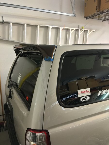

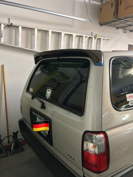

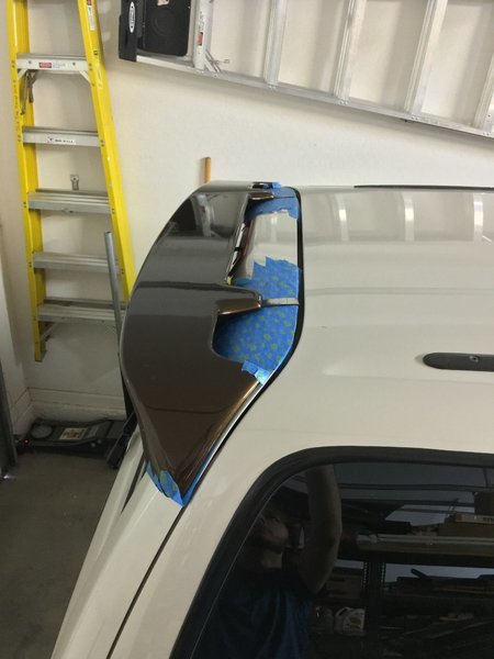

I've finally gotten started on 4Runner projects once again. The truck was parked for about a month because it had formed another exhaust leak between the turbo and downpipe and I didn't have time to fix it for a while. Got it back up and running last week, this time using OEM BMW locknuts to ensure there are no problems with them backing off, along with a Vibrant gasket between the turbo and downpipe. The truck has been running great since, so I have just begun working on the mods I've had in boxes for months.
So far, I've gotten the OEM Hilux Surf rear spoiler test fitted, and I've replicated the lower bracket design (these were missing from the spoiler) through the use of pictures and refining by test fitting the templates I made up. I will be fabbing up the brackets shortly, and assuming my design fits (it should), I will post up the template and measurements in case anyone needs it in the future.
The plan is to get the spoiler mounted once I've made the brackets, and once everything has been figured out as far as that is concerned, I will get it painted and then fabricate some caps to cover the bracket mounting points as well.
I should be able to get everything knocked out fairly quickly, and once that's all done I will move on to retrofitting the aftermarket JDM Surf headlamps I have with projectors. That won't be anything crazy spec-wise (probably going with DDM stuff, since I don't want to invest a ton into a cheaper set of non-OEM lights), but it should still be a cool project since I've only seen one other set of Surf headlamps retrofitted on here.
That's all for now, so I will leave you with pics of the spoiler that I took when I test-fitted it. Stay tuned for more!
