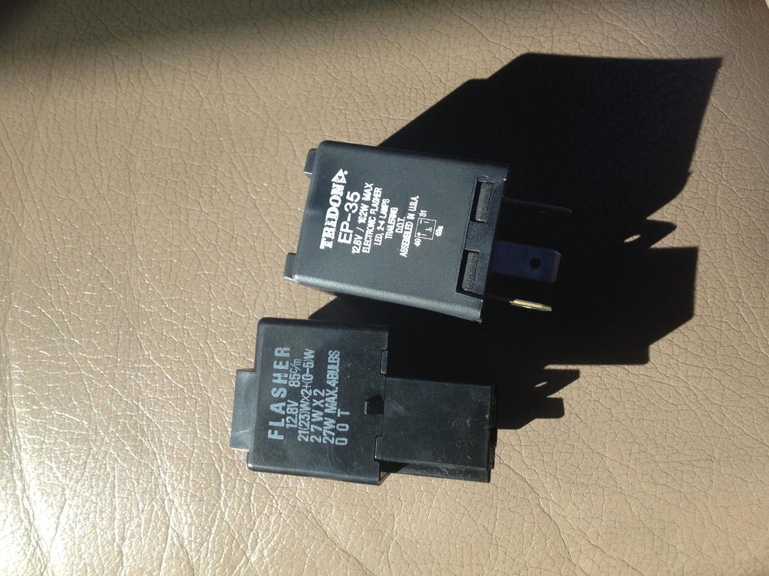

Today I got a few little things done. I bought and installed a Tridon ep-35 flasher to fix my hyper-blinking from the LEDs on my Outdoor Logic bumper. It was a bit of a pain to get to the old flasher and install the new one.

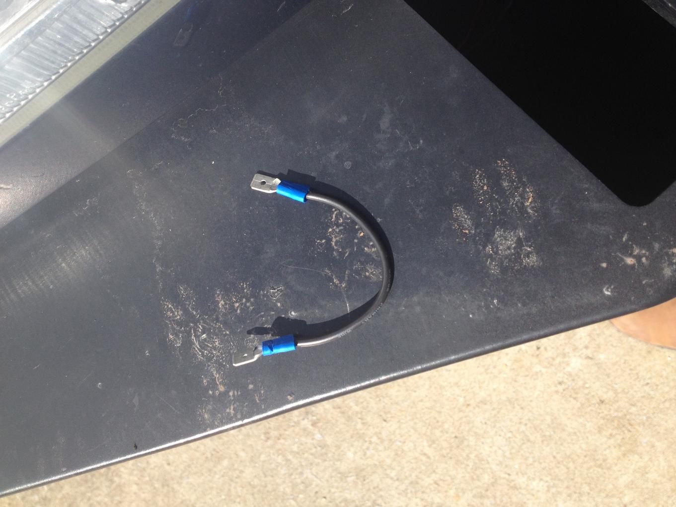

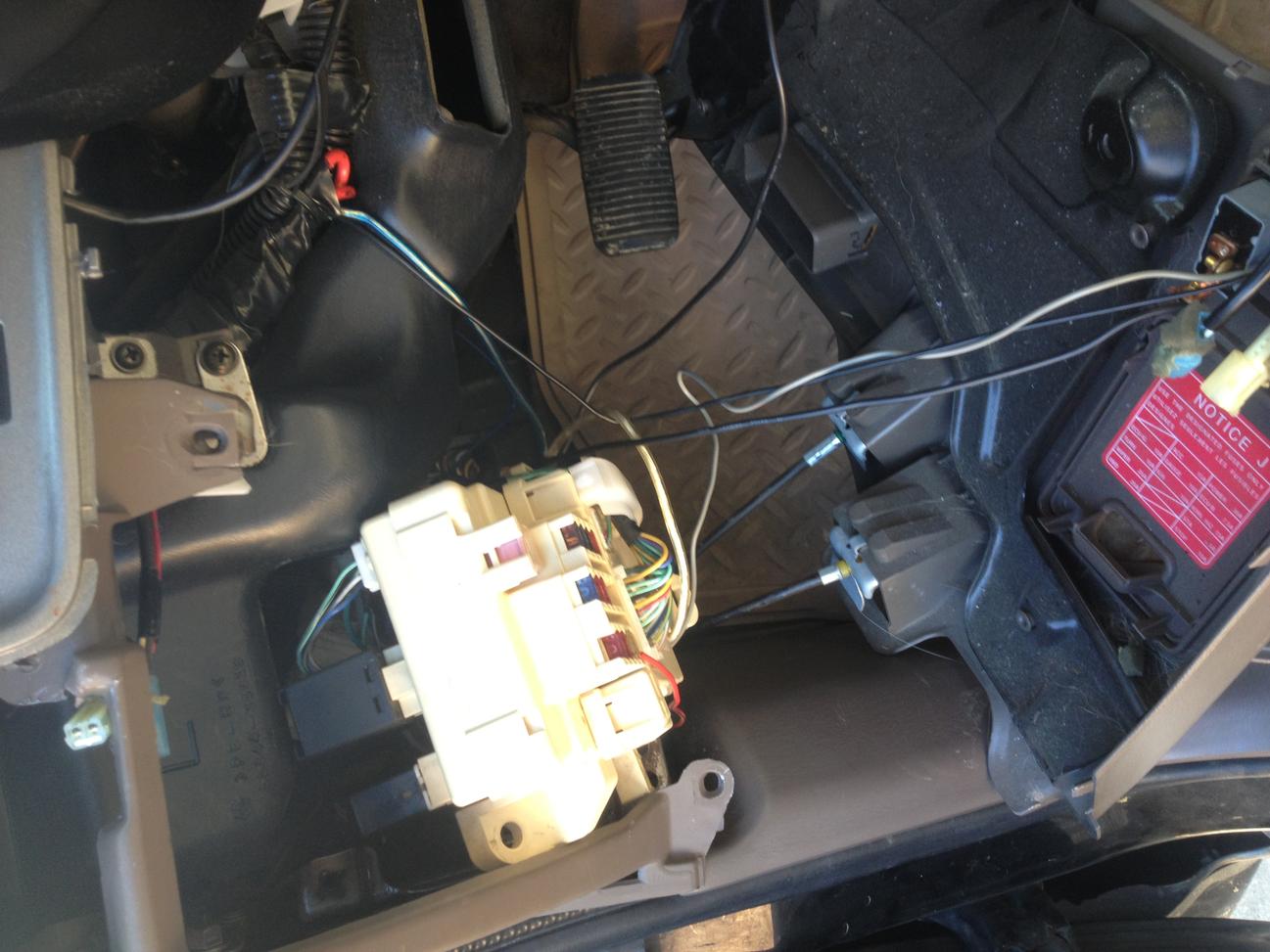

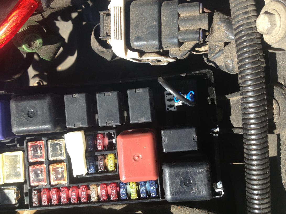

Then I finally got around to doing the Full Time 12V Power Outlet Mod so now I always have power to my cigarette lighters! It was extremely simple and I highly recommend doing it.

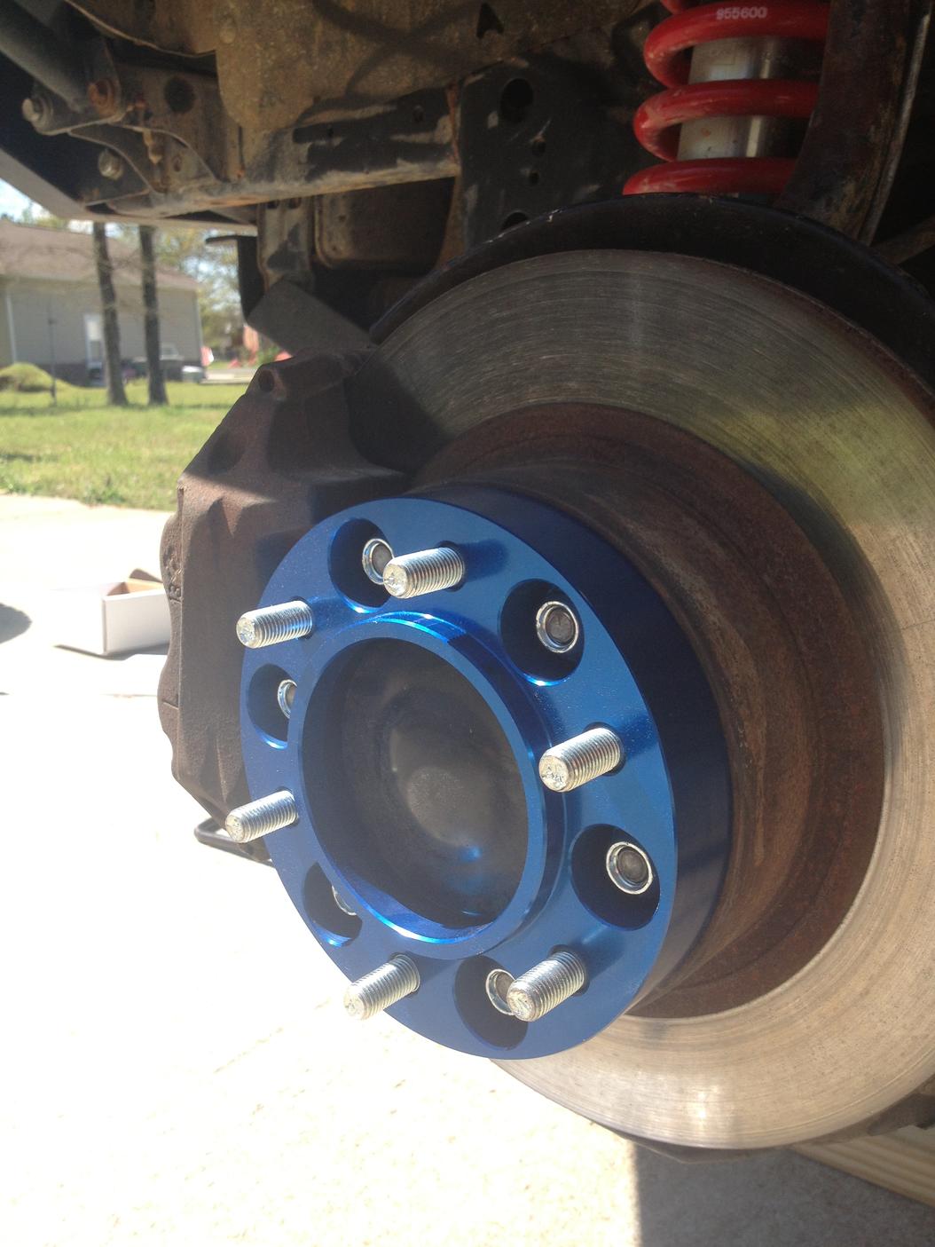

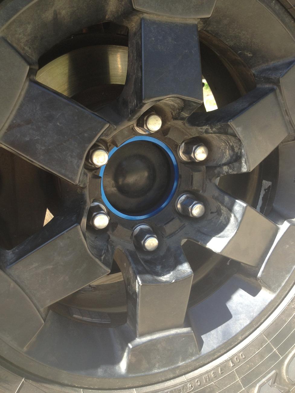

My Spidertrax spacers arrived last night, and I installed them today. Install was pretty simple and I clear the UCA by plenty now, but they did cause some rubbing on the back of the fender near the pinch weld. Ill have to do a little cutting and pounding to get them to clear and I won't be able to go that until Sunday because I have prom tonight and tomorrow night. I'd rather be working on my riggggg. :ybrick::ybrick::ybrick::dammit:

I didn't realize they have made .75" hub spacers until I saw someone selling some in the classifieds. So of course I jumped on those and they are exact perfect clearance on the UCA. They also cut down on the rubbing on the rear of my fenders in the pinch weld area, but I'm still getting some rub when I flex it hard which sucks because I wanna wheel.
