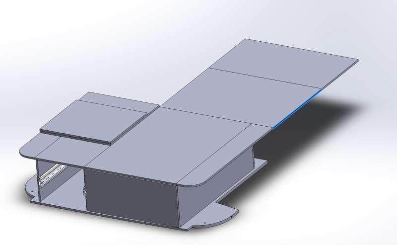

With that said, I sat down and started doodling in Solidworks, and here's what I've got:
This shows the passenger's side bed extension folded out, while the driver's side is stowed. The left module is likely to be a big drawer, and the right module will probably be two smaller drawers.
One thing decision that fell out of this design was the use of a base plate. I just can't justify using the extra 1.5 inches of space needed to keep that thing, when I never use it. Using a purpose-built baseplate will give me a bunch of that space back, and will let me have make much cleaner mounting options for the drawers. There's some downsides, like figuring out how in the blue blazes I make this thing fit right, but that's food for a future post.
At this point, I'm dealing with something that's moved beyond being a weekend project. This is going to take a while for me to complete, and so I'm dividing it up into manageable chunks and will give each their own post.

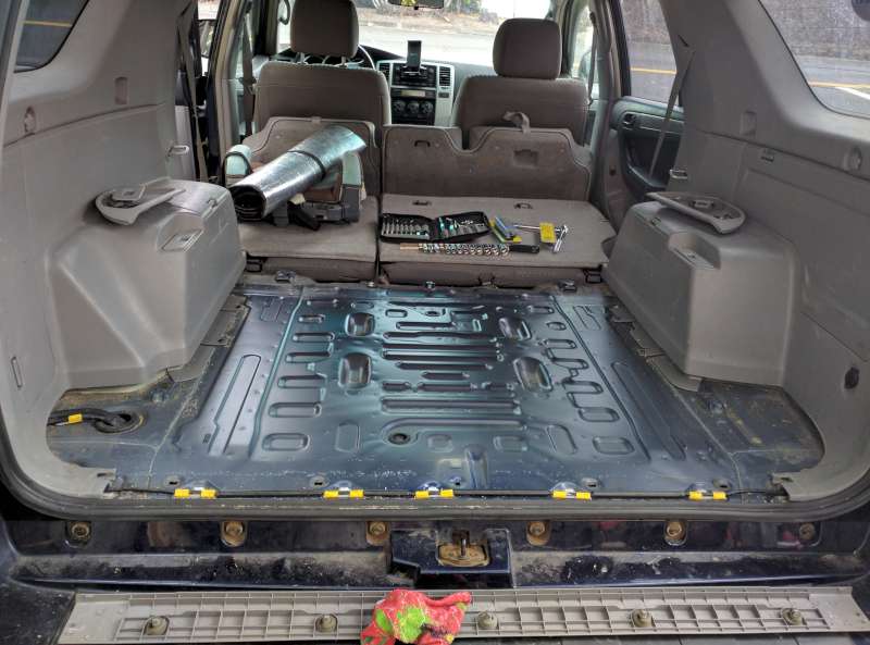

Anyhow, the first step was to remove all the existing junk flooring from the 4Runner.

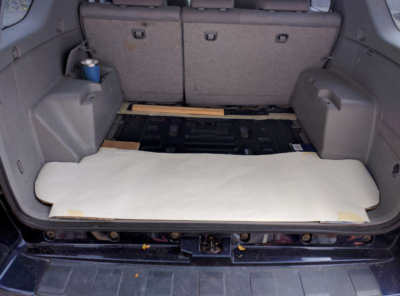

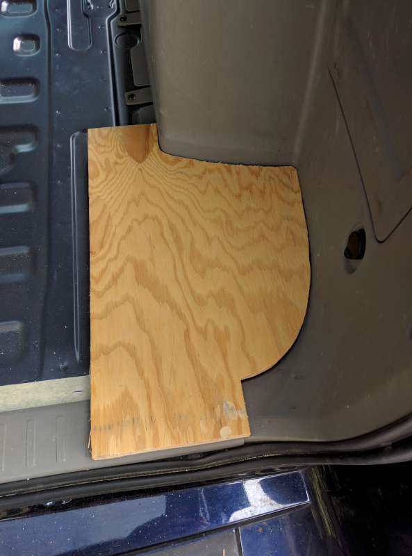

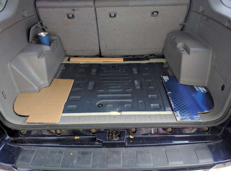

Next, take some measurements, and make some templates for the really complicated sections:
Then test the templates on some scrap wood:

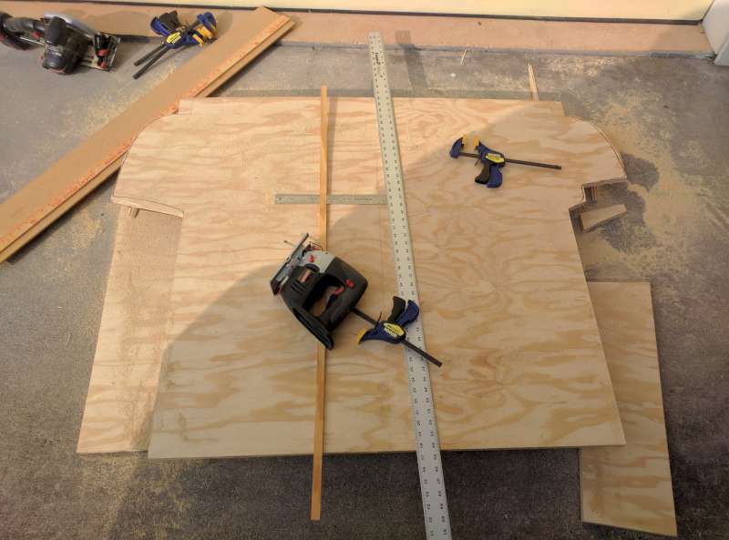

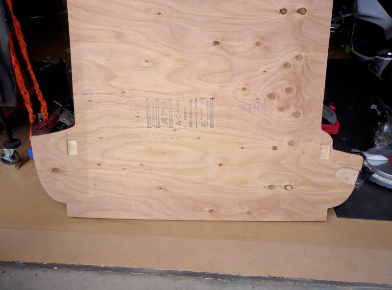

With fit confirmed, the next step is to make a large scale template that will be used to mark the plywood:
Once I've got the plywood all marked out, it's time to cut things and then sand all the edges smooth:
Contrary to what the picture shows, I did almost all the cutting with a portable circular saw. This let me get close to the line, then I used the table sander to get things right where I wanted them.

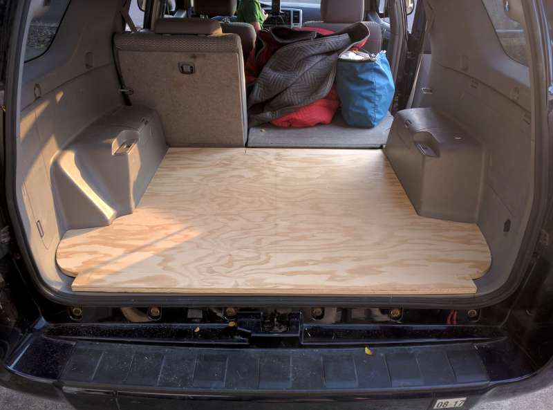

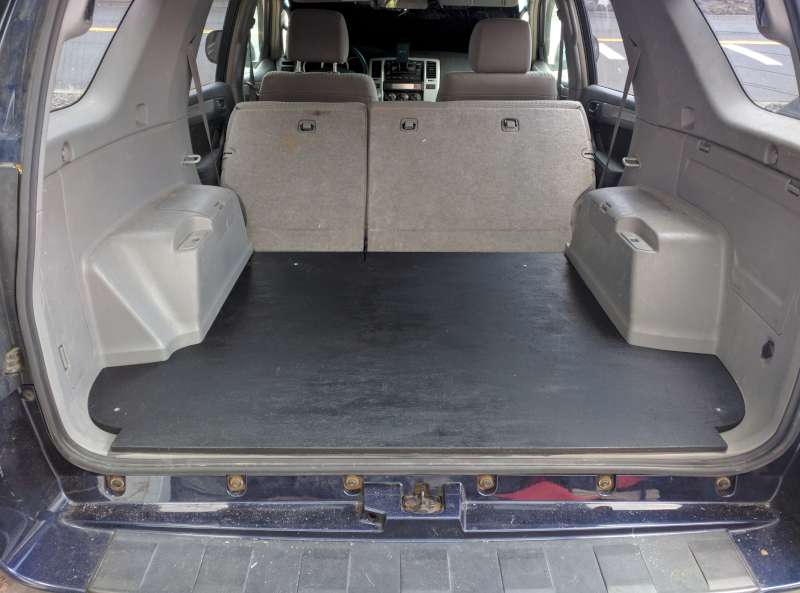

Finally, time for a test fit:
Not bad!

Note the cutout shown on the right-most edge of the base plate in this picture. This was for the wiring harness that comes up through a grommet in the floor. I also have an air line that passes through this, so there's some extra space cut out there. You also can't see three other recessed cuts along the top edge. They match the various protrusions near the rear seats.
One thing that had some potential for trickiness was getting the screw holes in the right place. I ended up cutting the head off of a screw and putting a point on it, then threading it into the appropriate hole. When the plate was placed on top (and pounded) the makeshift center punch left a mark on the plate in the right place. Then it was simple to drill in the right place. A countersink was added to the top surface, and then I used M6x1.0 x 40mm flathead screws to secure the thing.
And that's the worst of it. I then sanded the board, applied some spakling to fill the gaps and dents, sanded it again, then painted it with Duplicolor Bed Armor. After some drying time, I installed it over some thin rubber cut from a bicycle inner-tube to prevent rubbing, and we're in business:
The fit is really nice: nowhere is there a gap large enough to fit a popsicle stick into. When the trunk closes, the base plate extends to within a milimeter or so of the door's surface, so there isn't enough space for things to fall in there and surprise me when I go to unload the groceries. (I've lost a couple bottles of beer that way, which was a travesty. :shocked: Now you know the real reason for this project...)
Overall, planning and making the templates took the most time. Once I got down to cutting wood, I finished everything up in a weekend. Let's call it 8 hours of actual work.

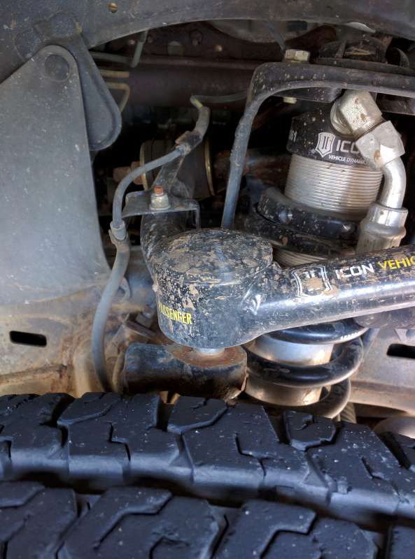

3D Printed UCA covers
I got a bit tired of cleaning crap out of the UCA ball joints, so I printed some covers:
Want to print your own UCA covers? Here's the file for use with Icon's tubular uppers (may work with other products, but no guarantees).

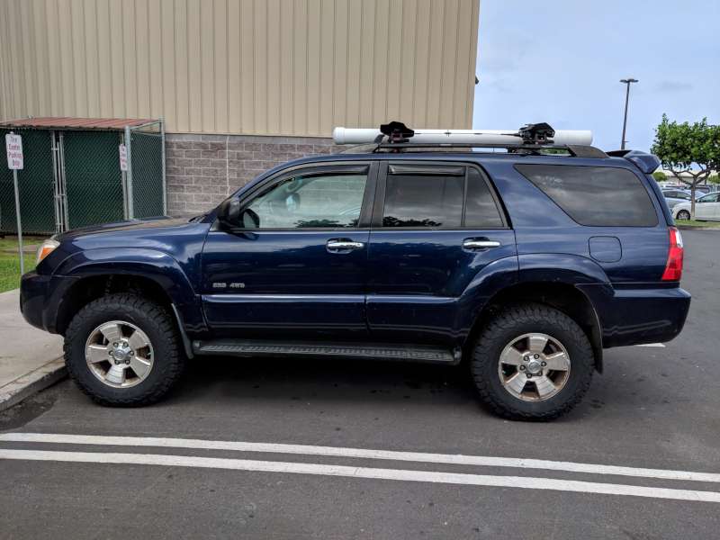

Anyhow, here's the car before:

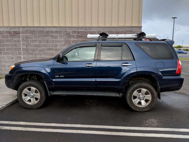

And here's the after:
I've run through a tank of gas since they've been installed, and my gas mileage has definitely taken a bit of a hit. The new KO2s are also substantially heavier than the old tires, so there's a noticeable change in the handling (acceleration in particular) of the car. It's not a problem, just noticeably different.

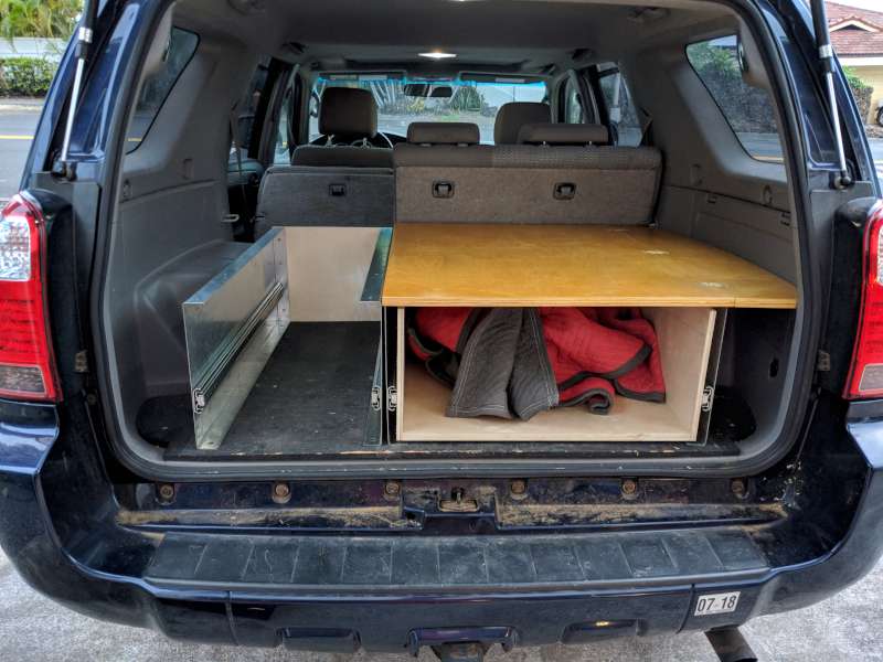

Hey Inv4drZm, it's been a while, but I finally made some progress on this. Here's a picture to whet your appetite.
I'll be posting the whole writeup in the next week or two . . .
