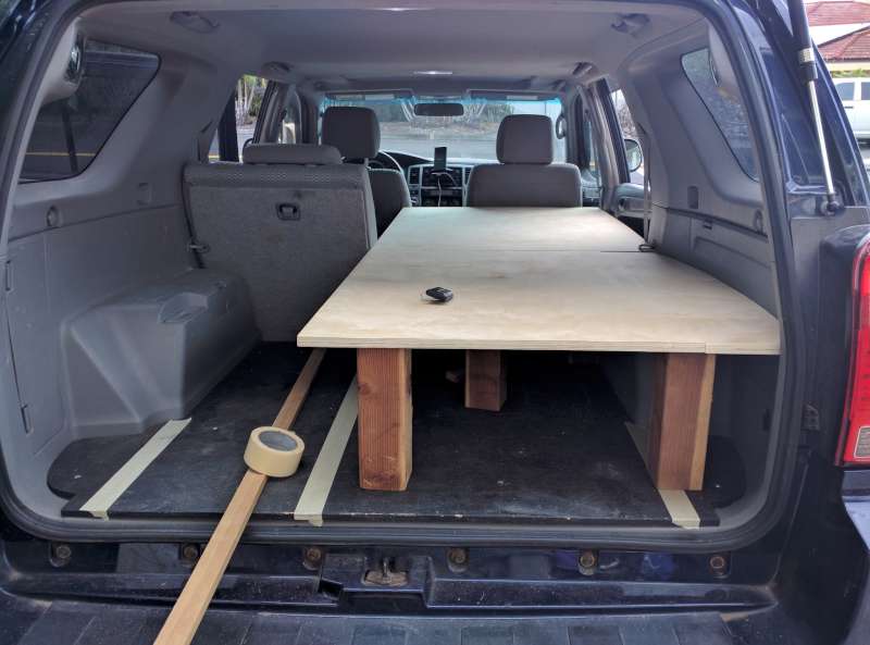

I also want a sleeping platform. Since that will help get the wife out on camping adventures. The Centipedes here are really amazing.
Oh, I also want it to look good.
So in a previous post, I had worked up a design for a system that I though met my requirements.
After letting things turn over in my mind for a while. I've made a plan, which includes some changes to the design shown previously.

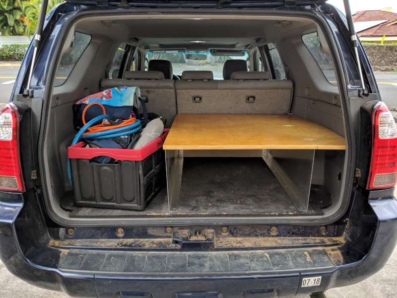

So the first decision was how HIGH to make the the drawers. I found that if I made the bottom side of the sleeping platform 12 inches up from the baseplate, it cleared the wheel wells with a bit to spare and the forward panels (sleeping platform extensions) would rest nicely on the folded up second-row seats, creating a level platform from front to back. This let me start cutting panels for the sleeping platform.

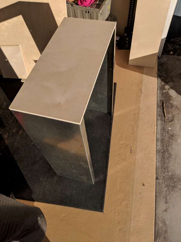

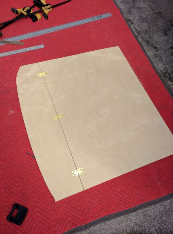

I started with the Starboard cabinet top pieces and bed extension panel:
Being picky really makes life complicated. I had decided that I wanted the platform to extend neatly to the edges of the available space (so that things can't drop down into crevices). This meant that some parts, like the extension and wing panels are highly contoured. Of course, there's no pattern available for these, so I needed to do quite a few cycles of "Test fit, mark, sand" to get parts to fit right.
After getting these pieces cut, sanded, varnished, and hinges installed...

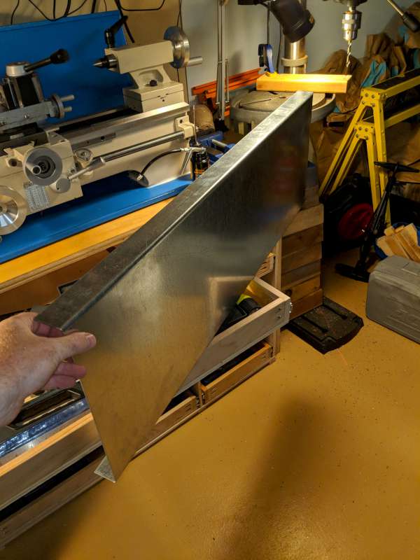

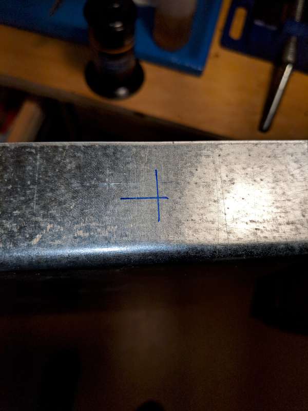

...I really couldn't do more (useful) work until I had the cabinet sides. As I mentioned before, I had decided to go with metal sides. So I went to a local shop that specializes in HVAC and architectural metal parts, and had them whip up four pieces out of 16 gauge galvanized steel. A few days and $250 later, I brought the parts home:
Marked them:
Drilled them:
And then did some test assembly:

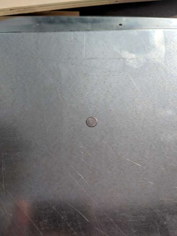

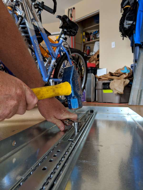

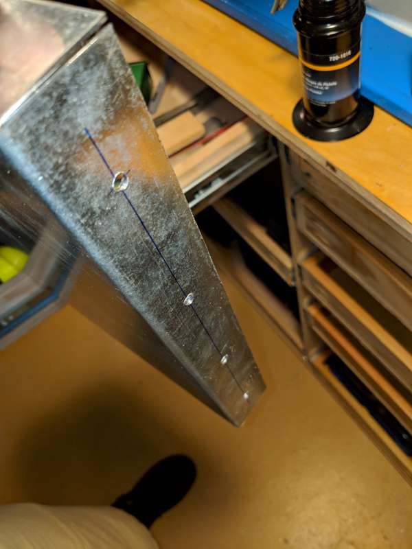

The next step was to get the drawer slides installed. This turned out to be more complicated than I thought. The drawer slides are designed to be attached to a wood or wood-like material, using wood screws. Since I was using a 1/16" thick steel panel, there wasn't room for much thread engagement, and I didn't want nuts or washers sticking out on the outside anyways. Plus, there wasn't much space on the inside either!

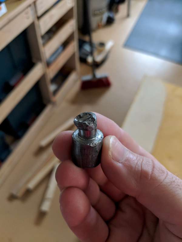

The solution: Solid rivets!
I'll be honest, I hadn't done much work with solid rivets before (I'm more used to pop rivets). I knew that you had to hammer them down some how, but how hard could that be. Combining this lack of practical experience with no restraint in material selection resulted in me having a box of Stainless Steel Rivets. It turns out that these are EXTREMELY hard to hammer down - most folks use a hydraulic press. So I want and talked to a guy at a local machine shop, who was willing to give this a try. There was the added complication that the tail end of the rivet was on the INSIDE, where the drawer slide is, so I was going to have to access this through the access holes in the drawer slide. So I made a little punch out of mild steel, which could be used to press down the rivets.
It didn't go well.
The rivets were significantly harder than my punch, and quickly destroyed it. The solution was to use a more suitable material, so I ordered a pack of ALUMINUM rivets.

So the new aluminum rivets were much easier to work with. They are certainly not as strong, but until proven otherwise, they seem strong enough.
The drawer sides had already been drilled and countersunk for the rivets, so the slides were set in place, then hammered over with a new punch.
This worked much better, and I didn't need a hydraulic press! Here's what the rivets look like from the outside:

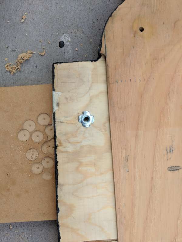

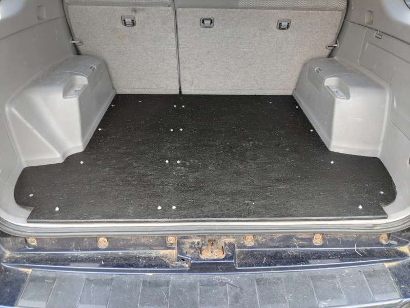

The next step was to make some modifications to the baseplate. I needed to add a way to mount the cabinets to the baseplate, so I marked out some desired screw locations, pulled it out, drilled the holes and installed some M8 hammer-in T-nuts.
(I actually ended up using two sizes. most of the baseplate is 3/4" thick, but the aft edge was thinned out to rest on the existing trim. Refer to my baseplate build post for further information.)
Once those were in place, I put a chamfer on the aft edge of the baseplate since that corner had been taking a lot of abuse, cut away some of the forward edge that had been catching on the second row seat, put a new coat of paint on, installed screws, and reinstalled it in the truck.

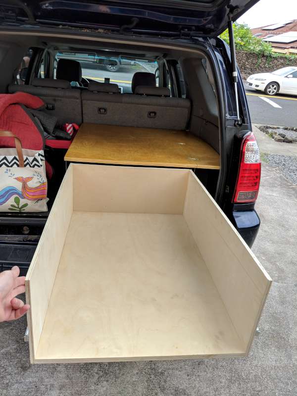

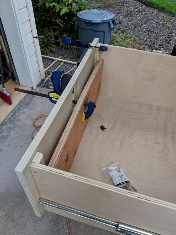

With the cabinets and baseplate all in their final forms, the next step was to put some drawers together, after measuring once and cutting twice (embarrassing, I know), I had the drawer frames ready to go. With some careful shimming, they were attached to the drawer slides:

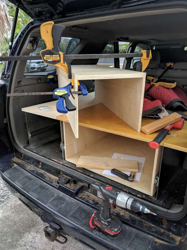

The skeleton of the Port Cabinet was added in:
In order to avoid screws visible on the drawer faces, I used mounting blocks to attach them to the rest of the drawer:

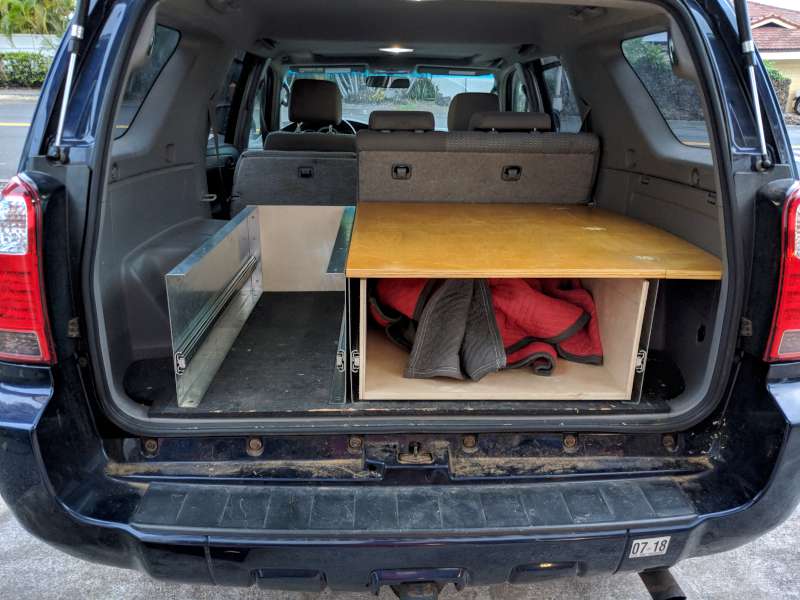

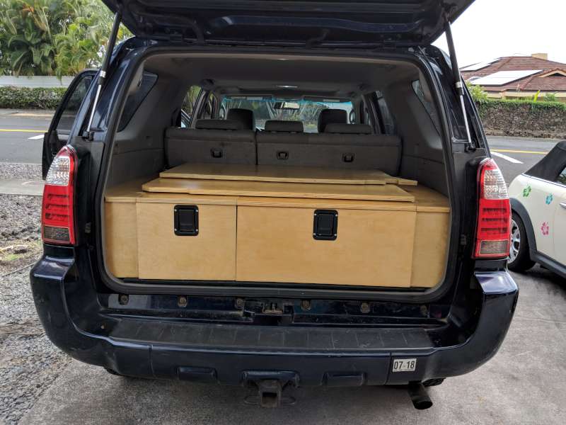

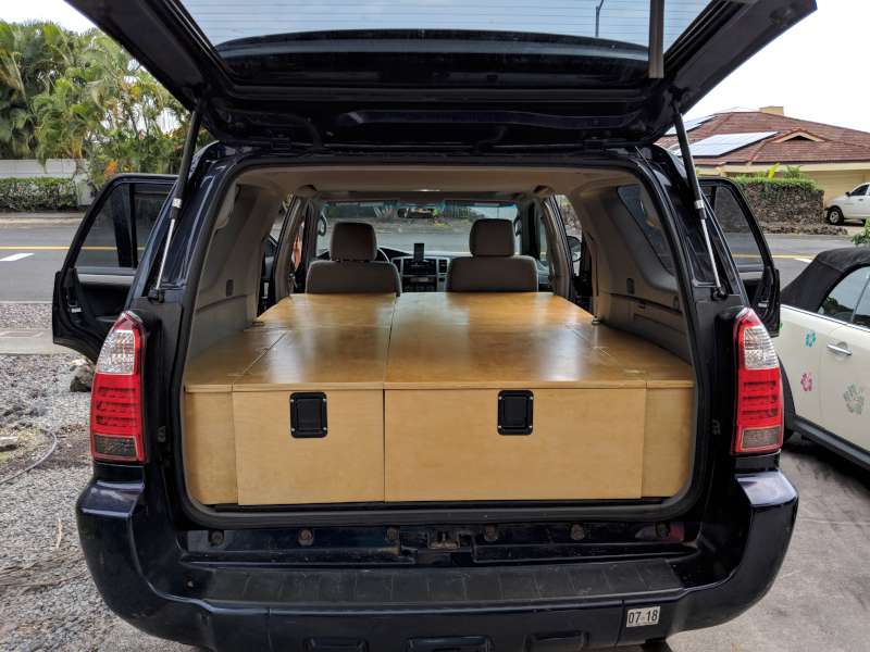

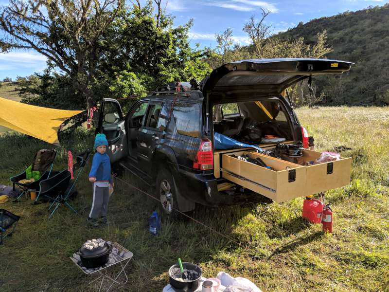

Here's the whole thing, in Bed configuration:

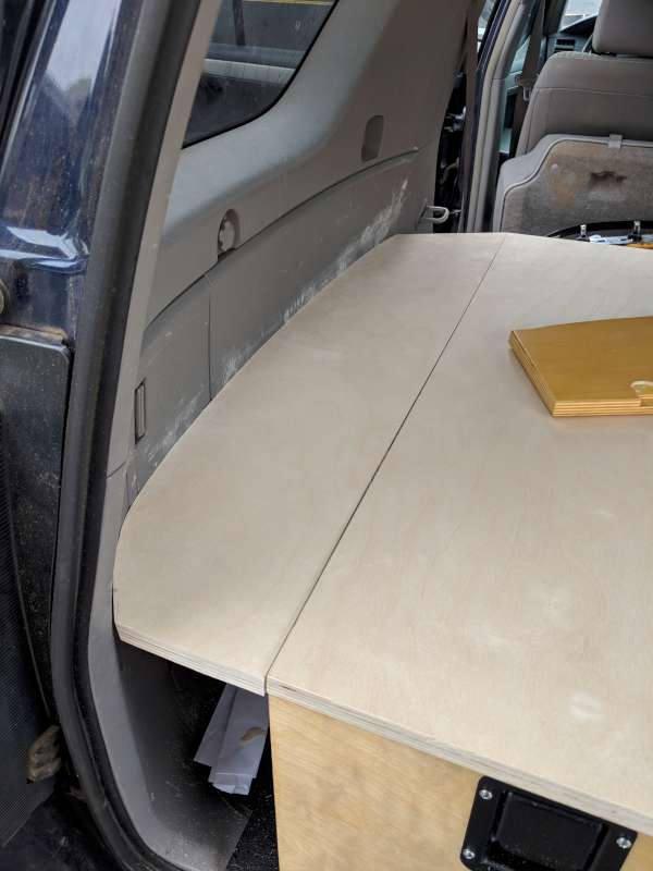

This shows the extension panels stowed in the back so that the rear seats can be up. I put some felt sliders on the bottom of these panels. Combined with the grit in the varnish, they stay right were I put them, which is pretty glorious.
And the Final Test:
It was awesome! They worked great over a two day trip. I'll keep 'em!

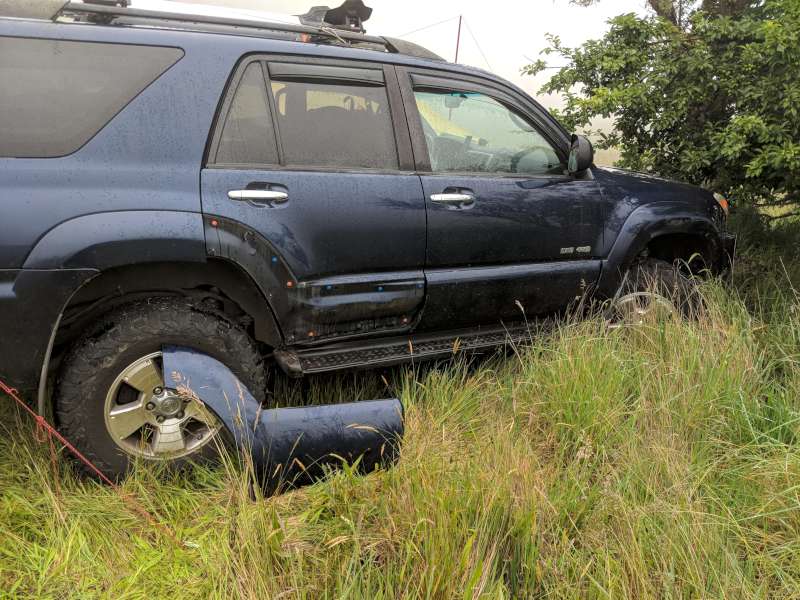

So, I worked like mad to get the rear drawers in place for the camping trip this last weekend. And while it was a great trip, there was one . . . incident.
While going down a hill, a large flat stone rolled over between the passenger side wheels, got caught in the rear running board bracket, and smashed it back and up. It ripped some hardware out of the running board, and pushed the running board up far enough that it popped the trim panel off of the rear door.
Fortunately, there doesn't appear to be any significant damage to the body, and there's nothing wrong with the trim panel that some epoxy won't fix. All the little trim clips are busted though. The local dealer wants $5 PER CLIP :twitch: for replacements (I didn't bother to ask about the rivets). Needless to say, THAT is not happening. So I've ordered a pack of new clips and rivets for substantially less of amazon. Should be a pretty easy fix.
The running board is probably toast though. So, time to start figuring out which is my favorite set of sliders . . .

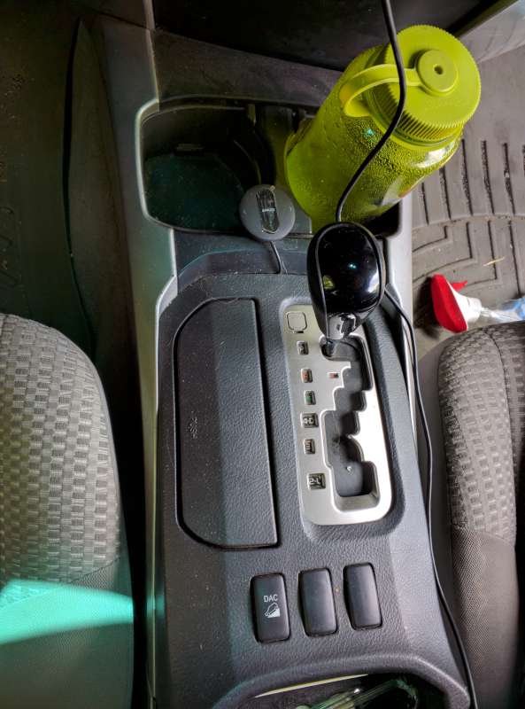

Well, I was installing a bunch of other electronics, and I came across this little gem: the Anker "SoundSync Drive" Bluetooth Adaptor
Now that I have the USB ports, right in the console where the AUX in port is located, it's hardly worth calling this a mod - I simply plugged the thing in.
The only real question was where to mount the puck. After some thinking, I ran the wire under the center console and have the puck sitting right on the center divider for the cupholder.
A little configuration of my Android phone and we're in business. Here's what I've got going on:
Now, the phone connects whenever I start the car, and plays through the AUX setting on the radio.

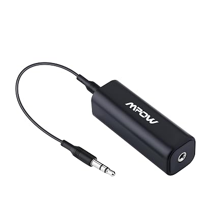

There is some alternator whine on the line, which I'm going to have to take care of, but that's a project for another day. (I'm open to suggestions if you have an easy to deal with it!)
So... if a year and a half isn't too late for a response, try using a ferrite core around the audio cable. https://en.wikipedia.org/wiki/Ferrite_bead
That *might* help with the alternator whine.
The "real" fix often has to do with your ground source and ground loops, and running your power wire directly from the battery, but given that this device is powered by a USB cord, I don't see much chance of a "real" fix.

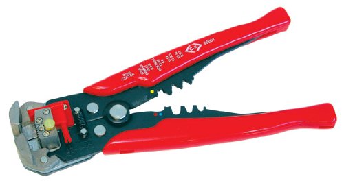

Often using a wire stripper like this .
can allow you to open a space in the wiring
without cutting it and without too much hassle. Sometimes carefully using a box cutter, you can remove a little more wire coating if necessary. Yes, it takes longer to strip, wrap, solder and tape, but the results usually tend to be more reliable. Over the years I have many intermittent problems problems from those taps. They can become loose where they tap into the main or add-on wire, and this can causes lots of frustration. Occasionally, I've even had the wire eventually break where the tap is installed. -- Just a suggestion.

So I got one of these, and it made all the difference!
It does seem to attenuate the audio a bit, but the alternater noise is almost completely gone (only noticeable when the volume is WAY up). I think we're good! Thanks for the tip!
(It's amazing how much better the audio from my phone sounds now. $9 well spent!)

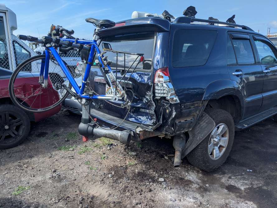

Well, last week last week Bilbo decided it was time to head to the Havens and sail off into the west.
I was rear-ended, and while the damage was limited to the rear right corner (and my bicycle and bike rack), the insurance adjuster decided that the wound "tis not so deep as a well, nor so wide as a church-door; but 'tis enough, 'twill serve". :rip:
I'm going to leave this post thread active and if others have questions about what I've done, please feel free to reach out. I'm still working on seeing what my next vehicle is going to be.
