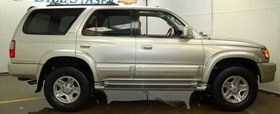

As purchased:
Officially named "Fenix" (based on my wacky rules for naming vehicles) but affectionately nicknamed ""YODA"
Purchased Jan 27th 2011
'99 T4R Limited Auto 4-Speed
Millennium Silver Metallic
3.4L 5VZ-FE V6 4x4 with 129k miles
Rear E-Locker

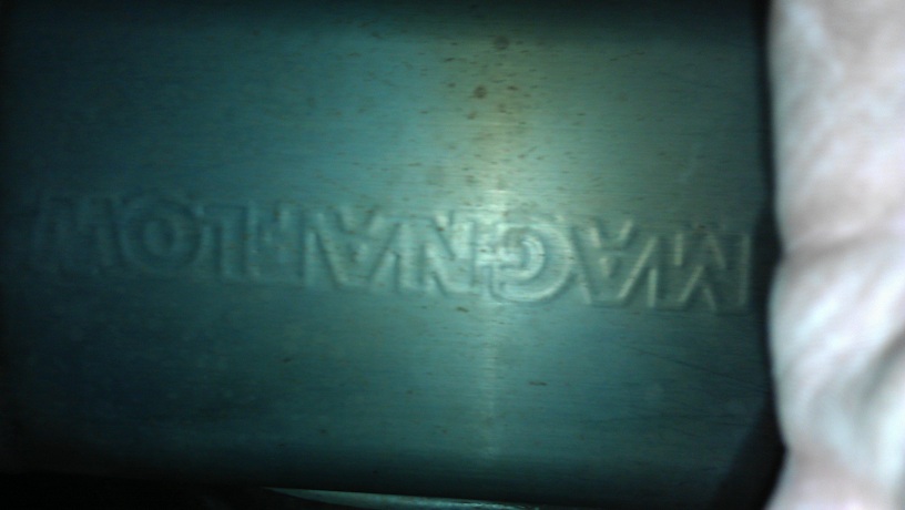

Muffler Replacement
First mod was more of a necessity. I had to replace the rusted out stock muffler so I went with a 14" Free-Flowing Magnaflow. It works but I can't say I'm a big fan of the sound. It's a little noisier than I would like it to be (wanna trade???).

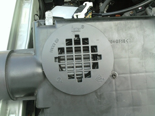

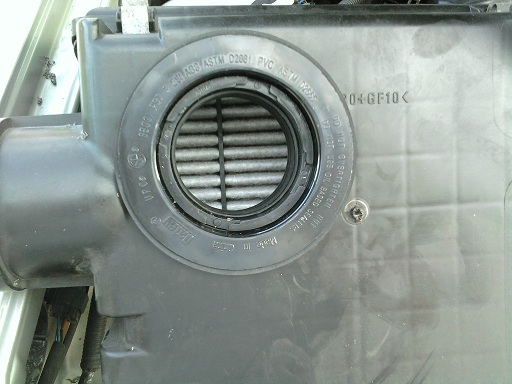

Air Box Mod
Decided the air box mod was something I wanted to try. I decided on going with a little smaller hole (option to add another if I wanted to later) and it was a pretty simple mod to do. Also performed the blue/gray wire mod so I can use my e-locker on my schedule; not Toyota's.
I was drag racing ricers in no time! Caution-I'm rarely serious... :nono:
Made a slight difference; nothing major.

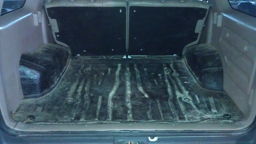

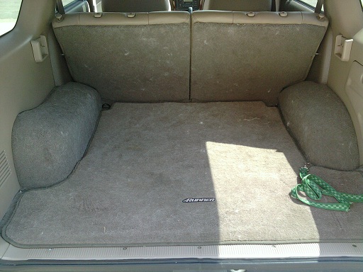

Herculined Cargo Area
Next mod was out of pure laziness. I have a yellow lab that does plenty of shedding and I swear that factory carpet is the world's best dog hair entrapment device. Once it's in there it's pretty difficult to get out. To remedy that situation I decided to remove all the carpet from the cargo area and Herculine it.
It works really well and makes cleanup (of anything) quick and easy. I've even been know to open the rear passenger doors and take a hose to it. :happens:
Rocks, rain, mud and the muffler do add additional interior noise to the cabin without the carpet's buffering effect. I drive A LOT and it doesn't bother me but it is a noticeable difference.
Problem Area
Solution (It's dirty and I still need to wrap the back seat pieces for a cleaner look)
Also tinted the windows to combat the heat in TX.

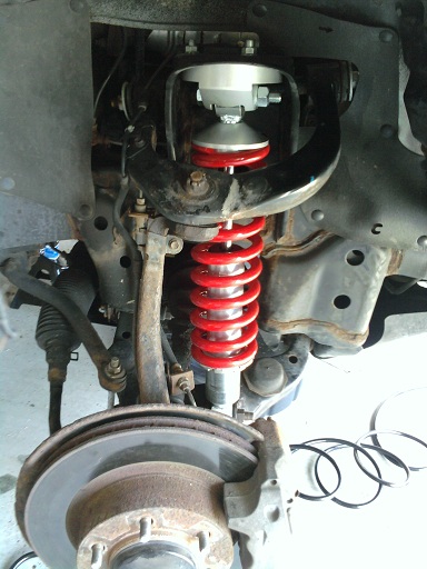

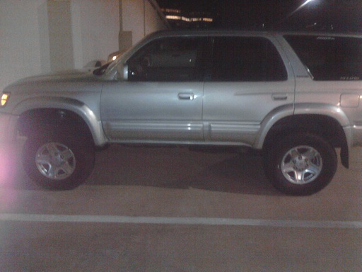

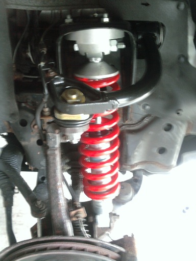

Lift Time!
I finally bit the bullet and decided on a Toytec Ultimate Lift! :guitar2: I'm glad I did because it gave me a chance to address a couple of things while I was at it. Ditched the stock running boards during the process.

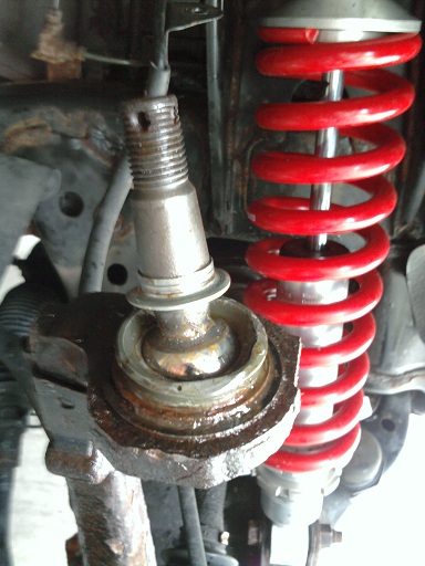

Ball Joint was on it's last leg

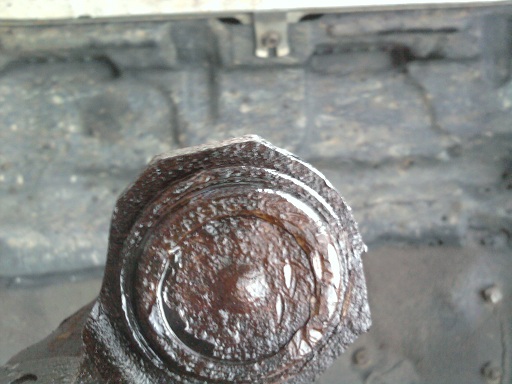

Found some rust that needed attention
Old UCAs got upgraded to some from Light Racing to make space for some planned upgrades down the road

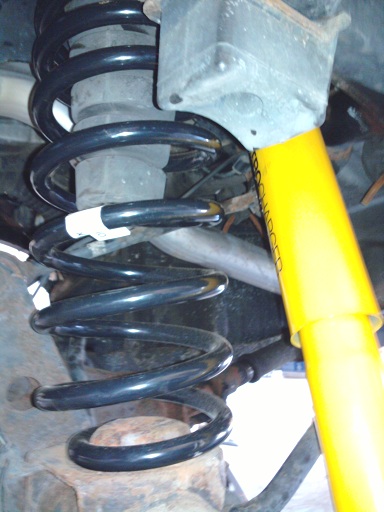

New Shocks & Springs in the rear
Crappy cell pics late at night but I was so excited I didn't care

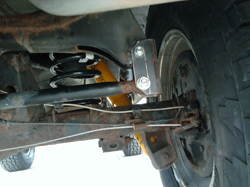

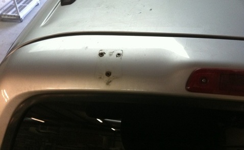

Picked up the panhard drop bracket from Toytec and had it welded on a few days later

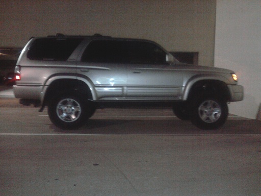

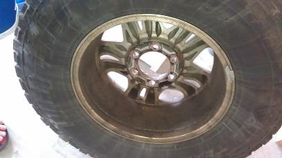

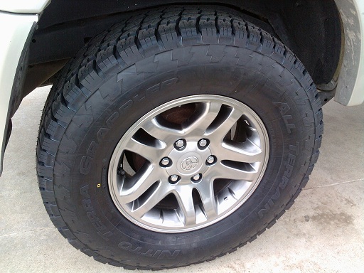

Tundra Rims & Tires
I've always loved the look of the 17" Gunmetal Tundra Rims so I picked up a pair and then wrapped them with 285/70/17 Nitto Terra Grapplers!

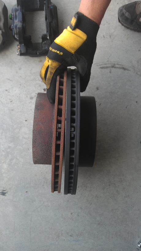

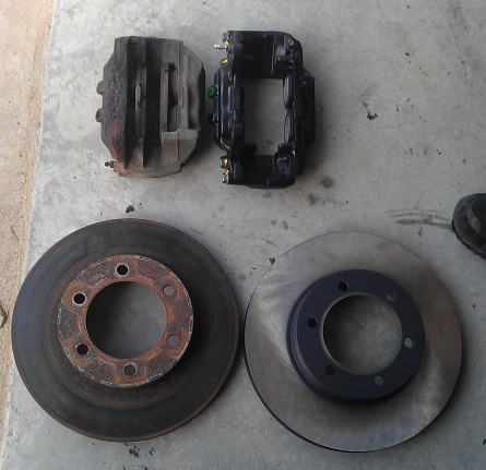

Tundra Stopping Power
Had the well documented rotor warp after 116k on the rig so it came time for a serious upgrade. I went with reman'd 231mm (13WL) Tundra calipers from NAPA and Toyota OME Tundra rotors.
After the install I couldn't bleed the brakes for the life of me and finally took it to a shop. After some digging they figured out the culprit was a faulty seal within one of the calipers. After a swap-out, re-install, drum adjustment and brake bleed the rig was back on the road.

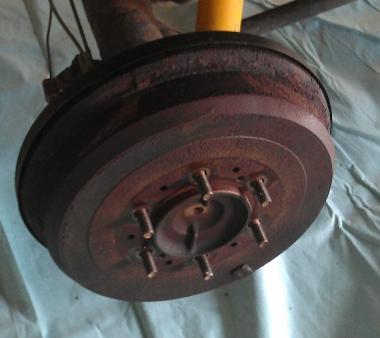

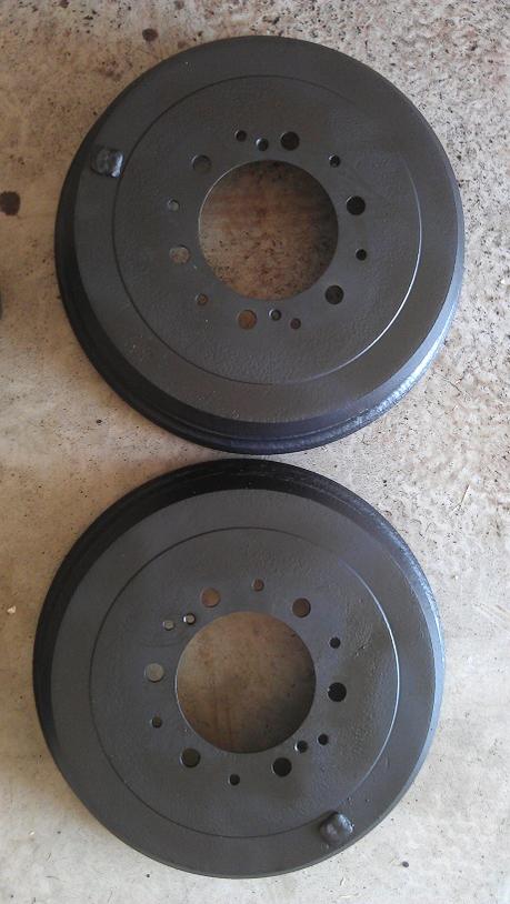

I also took the opportunity to rebuild the stock drum brakes on the rear end considering the parking brake didn't work. Cleaned them up and painted them as well.

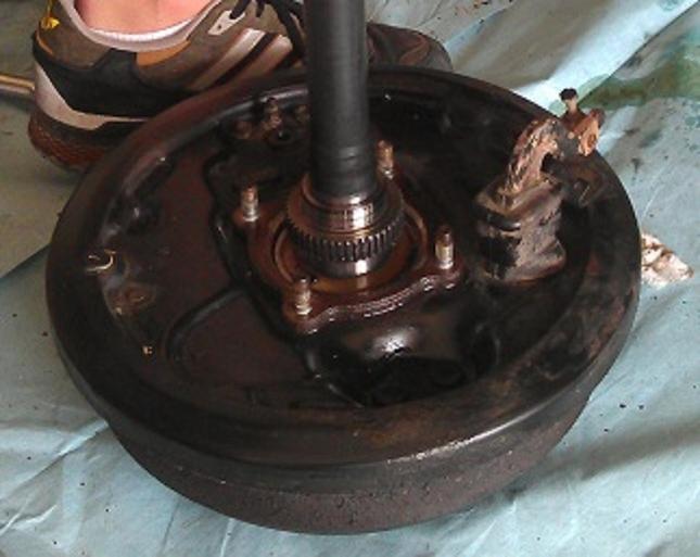

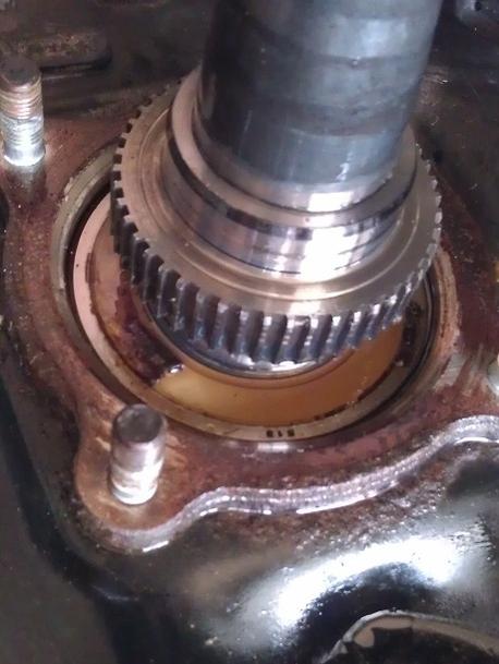

Rear Axle Rebuild
I got hit with the famed rear axle seal leak.
Since I'm a big fan of the "WHILE IT'S APART" mentality I basically rebuilt the whole axle with new seal, bearings..etc so I was sure it would be solid going forward.

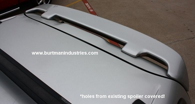

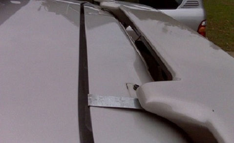

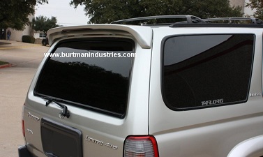

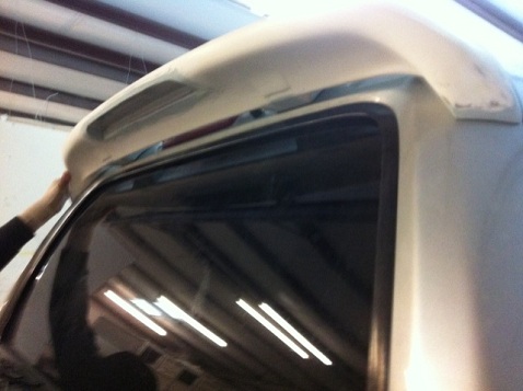

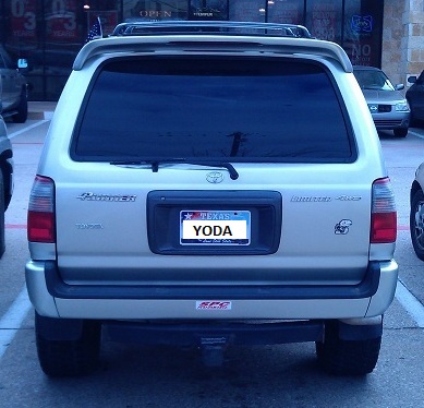

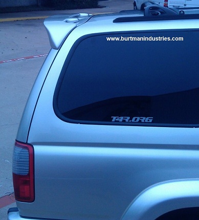

Jaos Style Rear Spoiler
I intended to upgrade the look with LED brake lights but didn't like the option of leaving the original third brake light in stock form when I couldn't find a suitable LED upgrade for it so I held off.
I have always like the Jaos style rear spoilers on T4Rs; especially with the integrated LED third brake light. I DID NOT like how the orignal design mounted to the rig as it used a metal tab to orient it on the top side and it didn't cover the stock mounting holes that were left when removing the stock deflector. :nono: :barf:

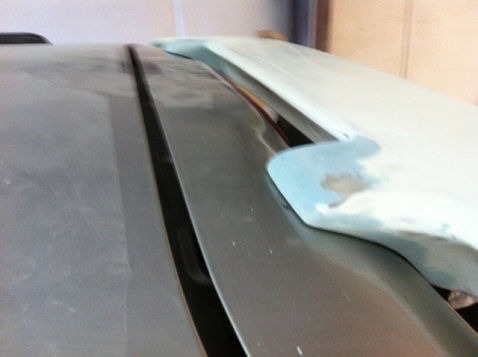

When Burtman Industries decided to address those issues and needed a guinea pig for mock-up and testing I decided to go along for the journey. :snacker:
Finished Product - I love it!

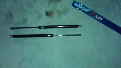

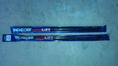

Lift Supports / Hatch Struts
My stock hatch struts are still lifting the rear gate about 65% of it's opening height but I would like it to open all the way. I swapped out my stock struts for Monroe 901446 Max-Lift Hatch Lift Supports. They performed exactly like my worn stock struts did. :bash:

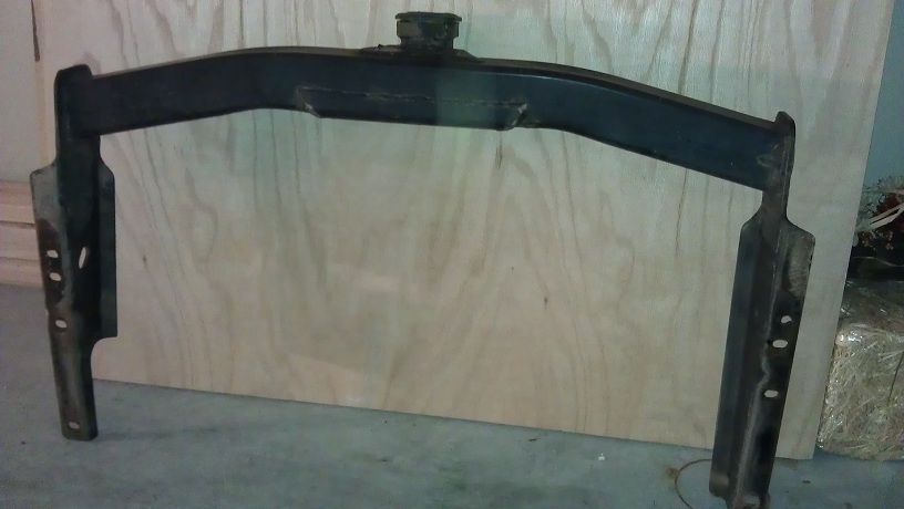

Hitch Removed
Decided the hitch had to go. I rubbed it some while off-roading but have plans to replace the rear bumper with a swing-away.

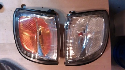

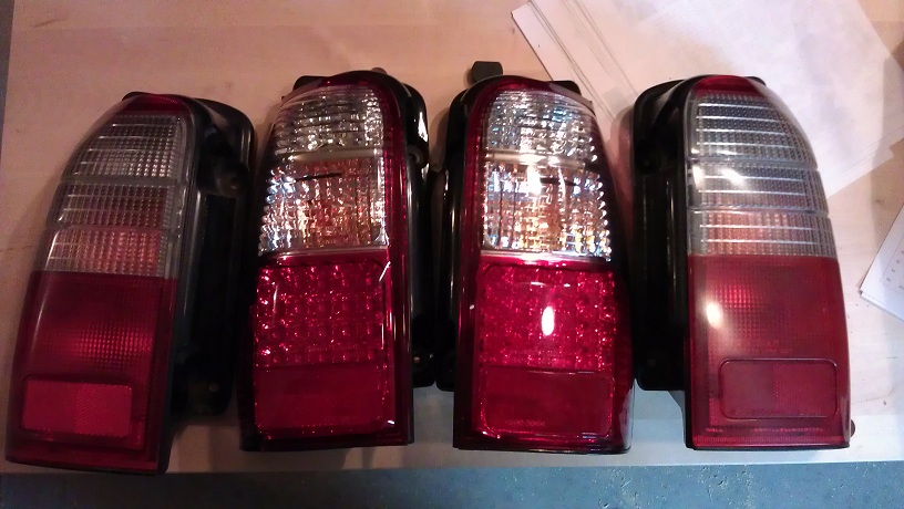

LED Tails & Clear Corners
To match the LEDs in the rear spoiler I picked up some Clear LED tails from Burtman Industries. I didn't want to stray far from the stock look but I really think the LEDs look clean.
I also went ahead with replacing the amber corner lenses with clear ones. I'll take care of the turn signals when I replace the front bumper.

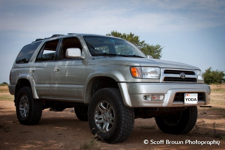

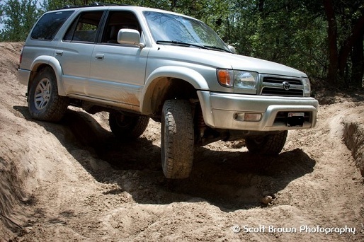

Mmmmmmm. Love the look of shiny new coilovers. Dig the list too. Can't wait to see the process.

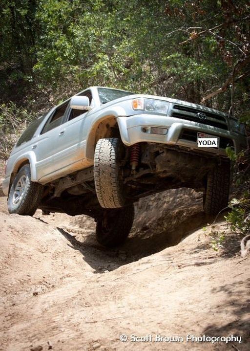

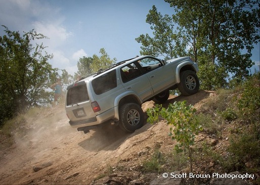

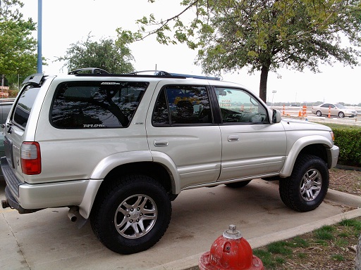

Thanks; I've really been pleased with the Toytec Ultimate Kit! So far I've really only posted pics of the work...so here are some of the fun with the suspension at work.
A big thank you to Scott Brown for capturing these pics. Next time I promise to disconnect the sway bars!!! :rtfm:
