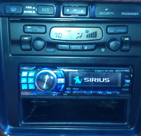

Finally got my new radio deck installed so I have Satellite Radio again!
While I had the center dash apart I tore into the climate control module to clean up the contact points. Since buying the rig the auto climate module has functioned correctly to control the temperature setting but the buttons didn't work very well. They had to be pushed extremely hard, or pushed in conjunction with the "mode" or "off" button to get them to work. :confused:

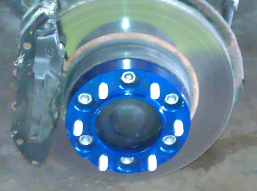

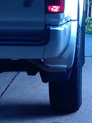

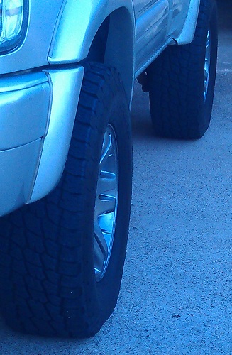

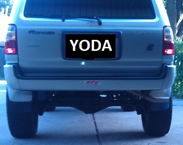

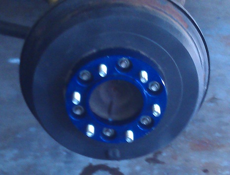

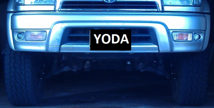

Wanted to bump the wheels out to the edge of the fender flares so I slapped on a set of Spidertrax 1.25" wheel spacers and am very happy with the results. :guitar3:

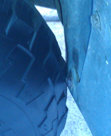

Have a slight bit of rubbing on the front drivers side inner fender molding to fix. And never mind the missing badges....next mod in progress. :artist2:

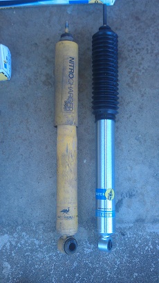

Shock & Spring Swap
Finally got around to swapping my OME 891 rear springs out for the softer OME 890 springs. Also swapped the 60028 Comfort Ride shocks for Bilstein 5100's.
One of these came with a really buggered up nut to use. I didn't notice it until after the first shock was installed and the second one was impossible to get tightened down properly. Learn from my mistake; make sure you run the nuts all the way on & off before trying to install anything onto your rig. News flash, the upper shock mount on these trucks is complete crap; given the chance I would backhand the guy that designed them. :confused:
Anyway, I failed to do so and it literally would've saved me a whole lot of blood, sweat and curse words. :redbrick: :ak472:

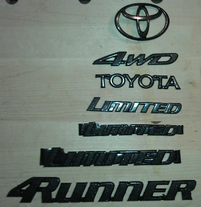

Also got around to taking the badges off the truck and getting them painted. I'll put up some finished pics once I get them back on the rig.
Went with Rust-oleum's Black Night Metallic.
Then covered them with 3 coats of clear Polycrylic.
I think they look pretty good but the pictures are pretty poor. What appear to be little bumps are actually metallic flake in the paint. I will try to get some better pics in the daylight and on the rig.

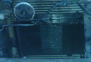

FINALLY got around to swapping out my stock radiator and eliminating the dreaded pink milkshake problem. Phew, I have been slacking on getting that done and I'm happy to have it completed! :party:
I had another thread going to discuss options and opinions, thank you to those that contributed. I ultimately decided to save some coin for other things in lieu of having an aluminum replacement radiator made for the rig at this time. I think the cooling system is something most people seriously overlook and did not want to neglect the rig while replacing the radiator but I felt chosen solution is up to the task.

Once I upgrade to a supercharger I will probably swap out the radiator for a better aluminum two rail one and remount the SPAL fan while swapping over to an electric water pump.
:pimp: I really like how it turned out but it was definitely an adventure. I also wired the fan up so that even when the truck is turned off and the key is removed the fan will continue to run until it brings the rad temp down to under 185*.
Rip had some solid advice I chose to follow in swapping out my stock thermostat for a 170* thermostat. I went this route because on these trucks when they start to get hot they have a hard time coming back down to normal temperatures without a lot of air being forced through them. This way the thermostat will open a little earlier to circulate the coolant in the radiator a little more frequently. I live in Texas and it's always f'n hot down here so I'll keep an eye on it and see how she does. So far so good; tried my hardest to get the old girl hot afterwards and no dice; the gauge wouldn't budge and I could barely get it hot enough to kick the electric fan on. :bluejump:

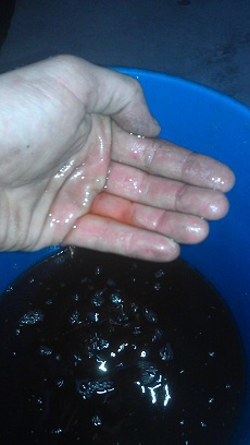

Coolant definitely needed to be changed out. Was pretty brownish/pink and watery when I stuck my hand in it. Went back with a 60/40 mixture of Dexcool & H2O.

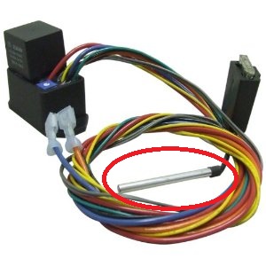

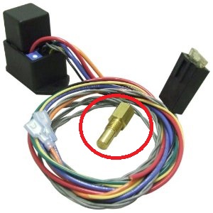

NOTE - If you wanted to be slick and use a probe in place of the 14mm engine block drain plug, THIS METHOD DID NOT WORK FOR ME. :happens: I failed to realize the way that plug is designed is so you don't have to remove it for the coolant to drain. It has a smooth "plug" after the threads and a drain hole on the bottom to allow for draining w/o removal of the plug. Made perfect sense once I removed the plug and tried it. I couldn't see the actual drain hole beforehand. :dammit:
I prefer tapping directly into the cooling system liquid for an exact reading with option 1. I had to settle for the second option of running a probe into the radiator fins because my super sneaky approach did not work.
One possible future solution I came across. By building up the neck of the coolant return tube (requires aluminum welding resources) you can tap it for a spot to screw in the thermostat probe. :girl:

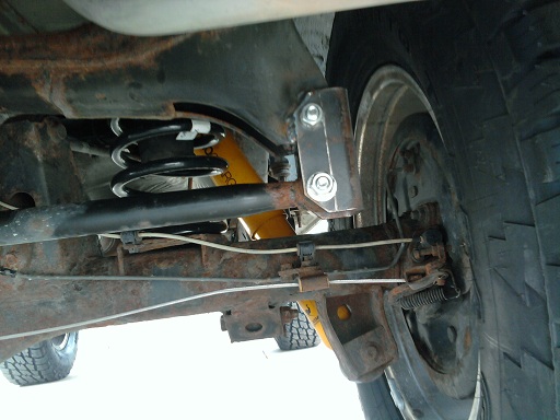

Picked up the panhard drop bracket from Toytec and had it welded on a few days later
Hey just wondering did the drop bracket help that much? I'm looking into buying the whole rear adjustable links set from toytec and they have the drop bracket and pan hard bar in the set......which doesn't make sense because if your going to use the drop bracket cant you just use the stock bar. would save me $$$ if I don't have to buy the adjustable bar :naughty:
