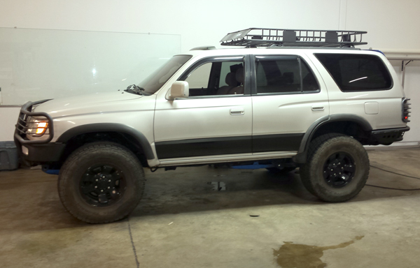

lol that would be good, i have not done that but here are some things i have been doing

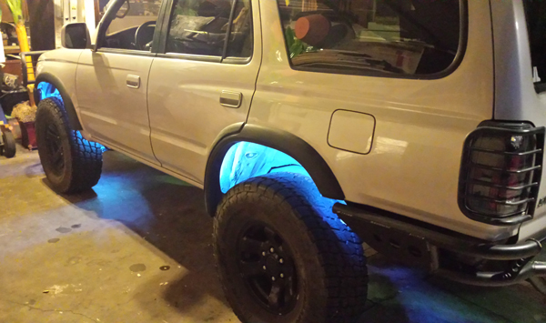

i put some under glow... i mean rock lights lol :drum: that can change lots of colors and white
and i just finished putting this black stripe on the side
In all seriousness i think it'd be amazing. Do it in plastidip so if you don't like you you can just peel it off

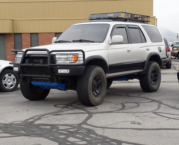

im got some one inch pucks to level out the front of the 4runner that i will be putting on soon and then maybe a set of rock sliders or maybe a solar panel :whistle:
1) what front bumper do you have now? I think this bumper plus the hoops is going to match perfectly to your ride (with your rear tube bumper):

1 the front brush guard is off a land rover that was in the junk yard and modified by my friends and my self to make it fit, so i could have a cover over my lights so that next time i hit a bird i wont loose a light. so i think i will just be keeping what i got for now.

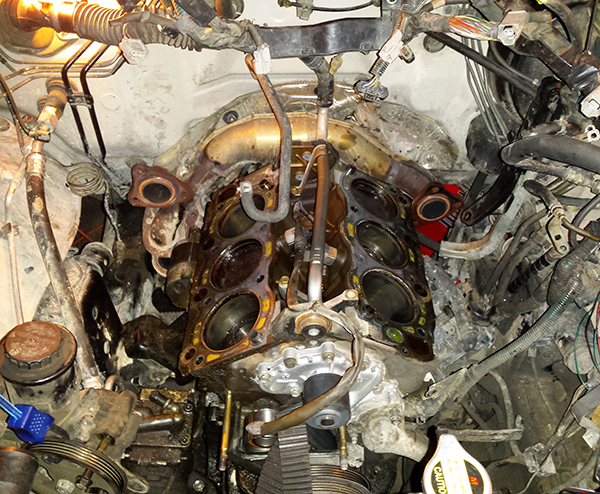

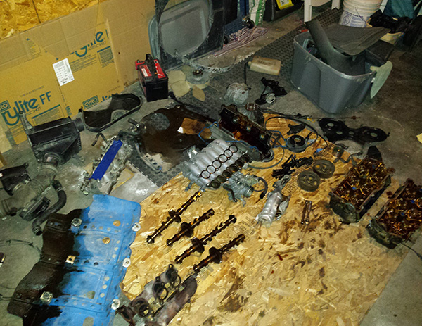

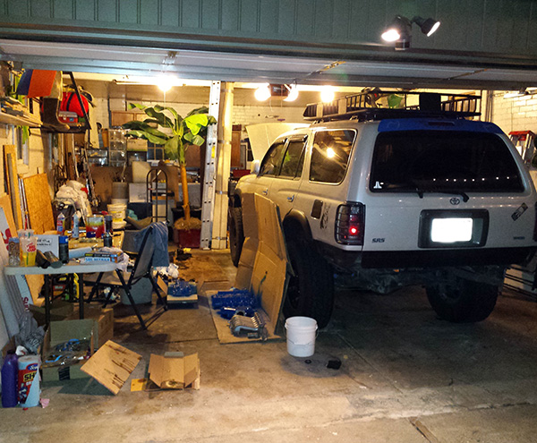

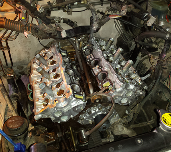

i have not posted in a bit, both my main computer and my 4runner desided to start leaking at the same time so i have been dealing with that and that means i have stuff to post! i ordered lots of parts and kits and what nots, so i parked in my garage and started ripping parts off. got the heads cleaned and resurfaced and now i am putting it back together hopefully i will be done tomorrow... hopfully:lol:
Brother not to be an ass but I hope you never hit a mule deer with that brush guard. It's going to do some damage if it ever happens. You fab skills are not bad. Ever though about a plate bumper for it.

i also hope i dont hit a mule deer but i got it just for birds, so as long as it stops a bird from braking my lights again then i will be happy, but i most likely will come back to reinforcing the brush guard.

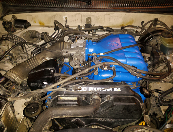

got it all back together and it was looking good, when i started the engine it runs smooth but has a clicking that seemed new, sounded like it was coming from the front of the engine and the temperature started to climb to half way, in the one minute i had it run. there is also the check engine light on for the first time, trying to make sense of what is going on

once the coolat serculated the temp was normal and I I drove it to a shop to get the code reader hooked up and it said the cam position sensor was not getting a signal so I checked the wire and found it was cut. I think the wire got caught in the belt other then that everything is running smoothly

turns out the wire got pinched by a bracket and that is why it was cut fixed it and now all is good, in the world under my hood.
was going bad... but fixed it all
so after a bit of running the engine one of the cam brackets came loose and started to make some noise so i took the valve cover off and found that there were not a decent amount of threads for the bolt to grab so i drilled it out and taped the bolt hole but my new tap broke off inside the head so i tried to drill it out but could not without F-ing up the head. after that i realized i was going to need a new head so i got one pulled from a junk yard and got new valves and springs and every thing replaced with a chemical bath and a resurface. i spent the last few days putting it all back together and finally i am done! it runs smooth, no leaks, and it feels like it is 10 years younger :rockon: woot!
