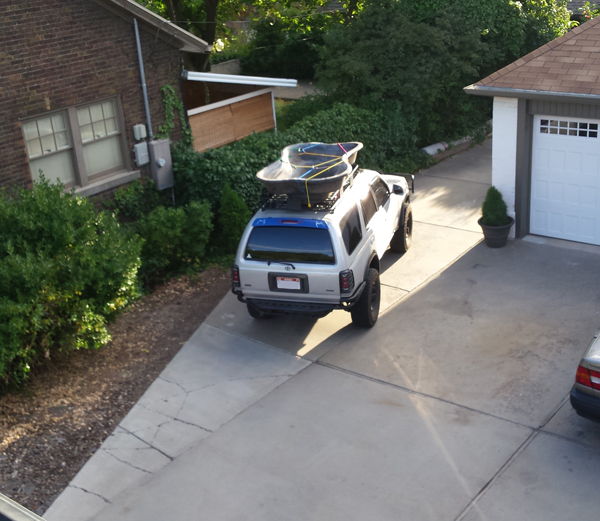

I don't have any pics handy of my crap all loaded up and I forgot that I also have a 125lb RTT up top but I usually have an 80lb dog, probably 75lb 105qt Yeti cooler loaded with ice and beer, 40lbs of tools and maybe another 50lbs of gear and as you can see in this pic I've got some pretty good reverse rake going on. I don't think I've got my coilovers cranked all the way up to 3" up front and unloaded I usually have 1.5" of rear rake. Not sure what the dilly is with your springs but LC springs don't hold weight well at all, and it's not just my springs I've seen a lot of other trucks with the same issue going on. I'm on the hunt for 861s right now that might be overkill for Merlin though.
Oops here's the pic

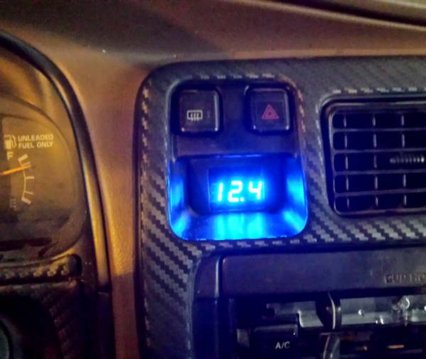

here is a volt meter that replaced my clock

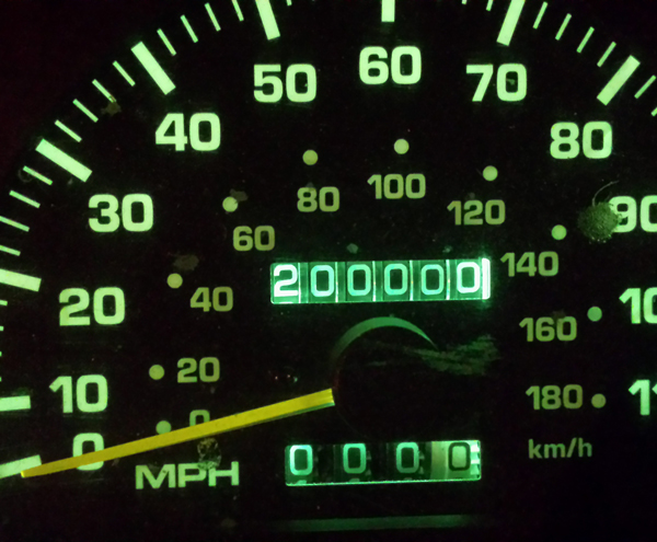

i hit 200000 miles the other day so i decided to celebrate with some mods lol
