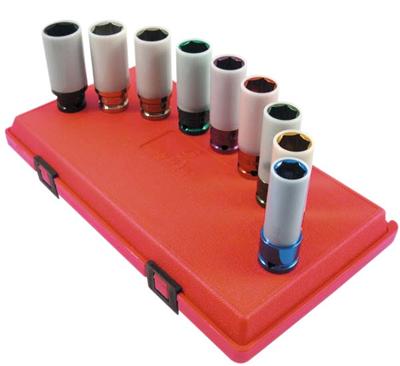

Sunex, Grey Pneumatic, and Proto all make thin wall impact sockets. I would consider getting the ones with a protector sleeve for rims.
Hey AJ, what lug nuts are you using with your wheels? I have Extended Thread Gorilla spline drive and they come with an adaptor/key style that an impact socket goes on to. Anyway,you could use the chrome sockets on an impact but depednig on the amount of torque it provides it may be to much for the chrome socket. Should be fine breaking them loose though it is not ideal. The thin walled impact is what I also would suggest.
You don't have to get a whole set. Just get the size you need 21mm or 19mm. Whichever fits your lugs

Hey Guys!
I was only planning on using the impact wrench to break the lugs, and not tighten. I have the Sunex impact sockets, and they're really beefy. I'll check out the thin walled version, but I suspect it'll still be too large for the Method Wheel holes, which are really small.
