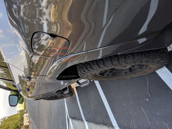

Hey guys! So I'm running the TRD Pro wheels on 275/70/17 BFGs right now with 1 1/4" spacers. I'm in the market to pick up some Method wheels, specifically the Roost 308s in matte black. I love the look I have now with the tires are pretty much flush with the fender edge.
The Method Roost has 0 offset with 4.75" backspacing. First question, will the edge of the tire be close to what I have now (the image link didn't attach but you can kind of see it in my profile pic). Secondly, the width of the Roost is 8.5", and I'm wondering if the 275/70/17s are going to fit properly and look okay. If you've got this combo tire / wheel size I'd love to see it.

I appreciate the reply. I'm glad you mentioned the tire size because that was the other concern. Hopefully someone can offer some pictures of any 8.5" Methods with 275s; I'd like to see what the profile. I love how the tire bulge out a bit now but it's not a deal breaker. Thanks again!

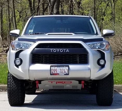

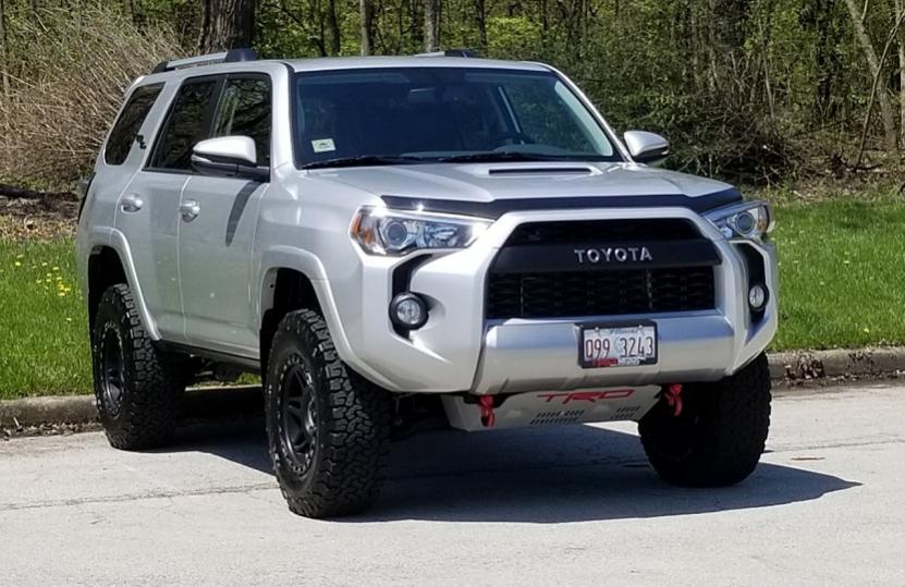

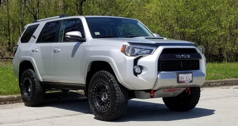

17x8.5. 0 offset - Method MR312s w/ 275/70/17
I'd have to take a better picture to show it's flush with the fender... the angle of the pictures aren't that great.
I have the Bilstein 5100s set to the top with OME Med springs. 2.5" front and 2" rear.
I moved the fender liner forward and removed the mud guards and I have no rubbing at all.
