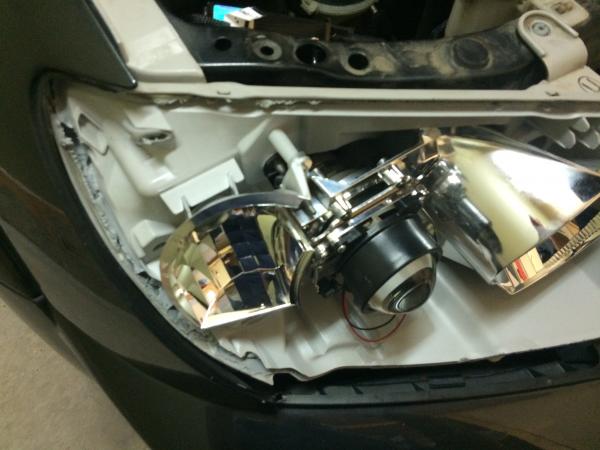

Problem 2. My projectors don't line up properly with the shroud. I don't know why. Everything bolted together cleanly. We used the projector plate supplied with the kit to attach the new projector to the housing. It should have been simple, and it was, except for the fact the projector doesn't line up with the shroud.
Mounted for testing purposes:
All sealed but somehow the projector doesn't align with the shroud:
My lighting doesn't appear to be affected.
Ideas?

I'd definitely call and ask about the alignment issue tho....that definitely does not look right. Is it possible that the inner housing/reflector piece was installed incorrectly? Please keep us posted.
I think if you took the truck out and realign the lights. It should solve it, I just live with my retrofit, it's not as perfect if you stare at the headlights, but I don't care that much when it's dead set on the alignment and it's not hurting my output. My output is way better than the md2s when I started.
I had the same issue with my retrofit from TRS. I bought their complete 4runner retrofit kit too and I was very upset when it didn't include everything needed to complete the retrofit. Luckily it was on a spare set of headlights so I was still able to drive my 4runner. At first TRS tried to claim that no one else had ever had the issue. But after several emails they finally agreed to ship me the rubber grommet free of charge. Mine also didn't align perfectly with the holes in the headlight, but that was fixed when I went to aim them. it still isn't 100% but you really really have to look to notice.

Yes we agree. I have not seen pictures of CPT2nr88's headlights, so I cannot comment on them. But the alignment in the picture provided by bdubbin is unacceptable IMO. I hope it aligns itself better once he properly aims the headlights (assuming this hasn't been done yet).
i would also agree, but posting a shroud alignment picture before the headlight is properly mounted means nothing. when i used to do retros, the reflector bowl would look pretty bad until i properly aimed the headlight. once aimed, everything looked like it did OEM.
