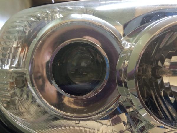

All sealed but somehow the projector doesn't align with the shroud:
My lighting doesn't appear to be affected.
Ideas?
The lights are already aligned in the second picture where the shroud is mis-aligned to the projector and everything is sealed up. That's the final outcome for now.
so after you mounted the headlights on the truck and properly aligned them, your projector looks like this in the shroud still?
is your shroud properly seated in the lens? i have seen several retros where the retrofitter did not properly seat the shroud and since this shroud is attached directly to the lens, it will make things look off.
post a quick pic of your cutoff against a wall at minimum 25' and a pic head on of your projector/shroud misalignment. maybe we can help from there.
Yes
I didn't see a way to adjust the shroud? I assumed when I put the buytl on and pushed the two pieces together that they would come together and seal and that would be it. How do you seat the shroud in the lens during the process?
I'll try to get a picture of the cutoffs shortly. Thanks.

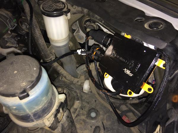

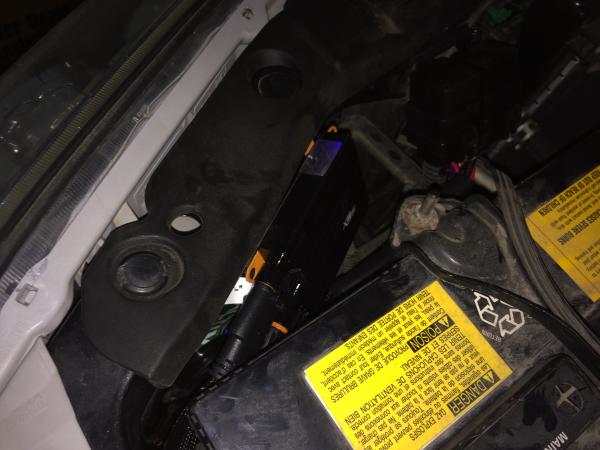

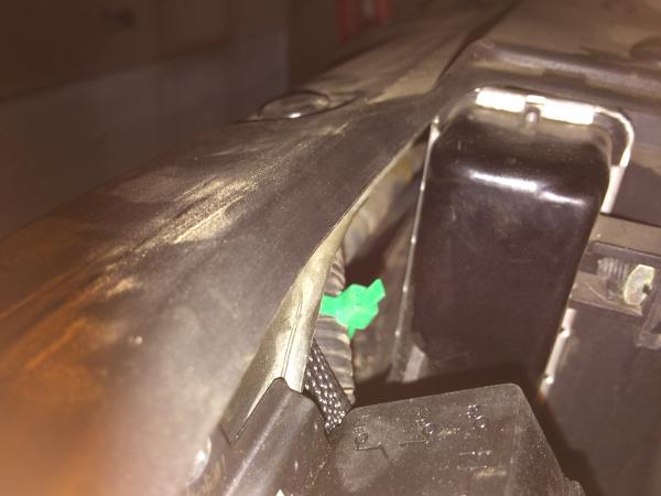

Does anyone have any pictures of how they mounted their ballasts and routed their harness?
Left side (battery)
- The ballast is mounted to the metal bar and is in front of the battery.
- The wiring harness is mounted to the right of the ballast on that same metal bar (hard to see in the picture).
- The cable is tucked up under the metal bar. Some other cable is already strung through there so the wiring harness is zip tied (green) to that existing cable. You can see the top of the wiring harness in this picture at the bottom.
Right side
- You can see the cable coming out with a fair amount of slack available
- ballast is mounted over the low beam projector on the right side (similar to the left).
i havent personally opened a set of 06-09 headlights. i do know with the tacomas, there was a little tab the shroud needed to clip into in a sense for the shroud to fit properly. the shroud could be installed incorrectly in the lens and still seal up. you only time one would notice is when everything was buttoned up and it looked slightly off on the top of the headlight.
u have a shield problem, its suppose to be more sharper, but these are great upgrade from stock, i wanted more performance and more light, so i swaped the morimoto to the rx, big difference. the morimoto have to much foreground and not enough distance.
I'd recommend opening up that headlight again just to double check the inner housing. You never mentioned the other headlight... but is this alignment issue present in both sides or just the one side?
It's the same thing on the 06-09, there's a clip on the side for the shroud as well, it's kind of tricky if you don't take your time and really look. I had no issues with my morimoto full retro kit, but I remember the shroud being tricky to get to sit the first time I tried to reassemble

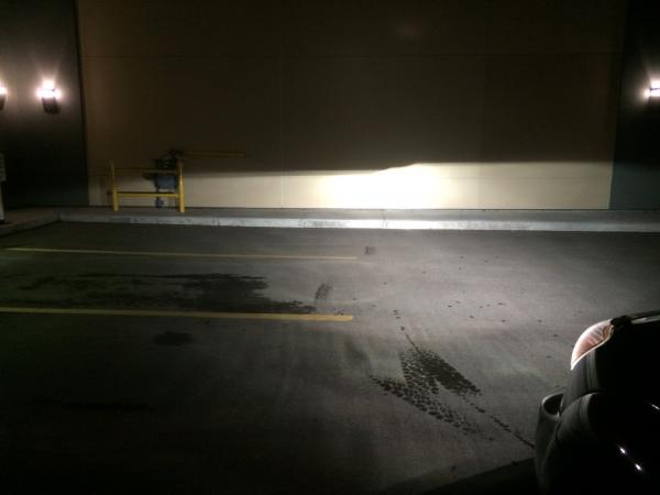

I finally remembered to take a picture of my cutoff at night. There is very little color in it. My friend has a set of their H1 mini projectors and it has a ton of blue along the cutoff. Mine are worse than my G35 projectors before I color modded them.
Here's a picture from last night...
I didn't measure but you can see the parking stalls to gauge how far from the wall I am... at 7' per stall (7*3') plus the sidewalk (4') I'd guess I'm close to 25 feet away.
This is my first experience with this so I'd appreciate positive criticism over slamming the newbie. :)
yep, not aimed properly. fix that and you should be good to go! There are all kinds of writeups on how to properly aim them, just search google and follow the one that makes the most sense to you.
It is hard to tell from the picture, but is that with both headlights on?? Or just is that just showing the driver's side? Something doesn't look right.
