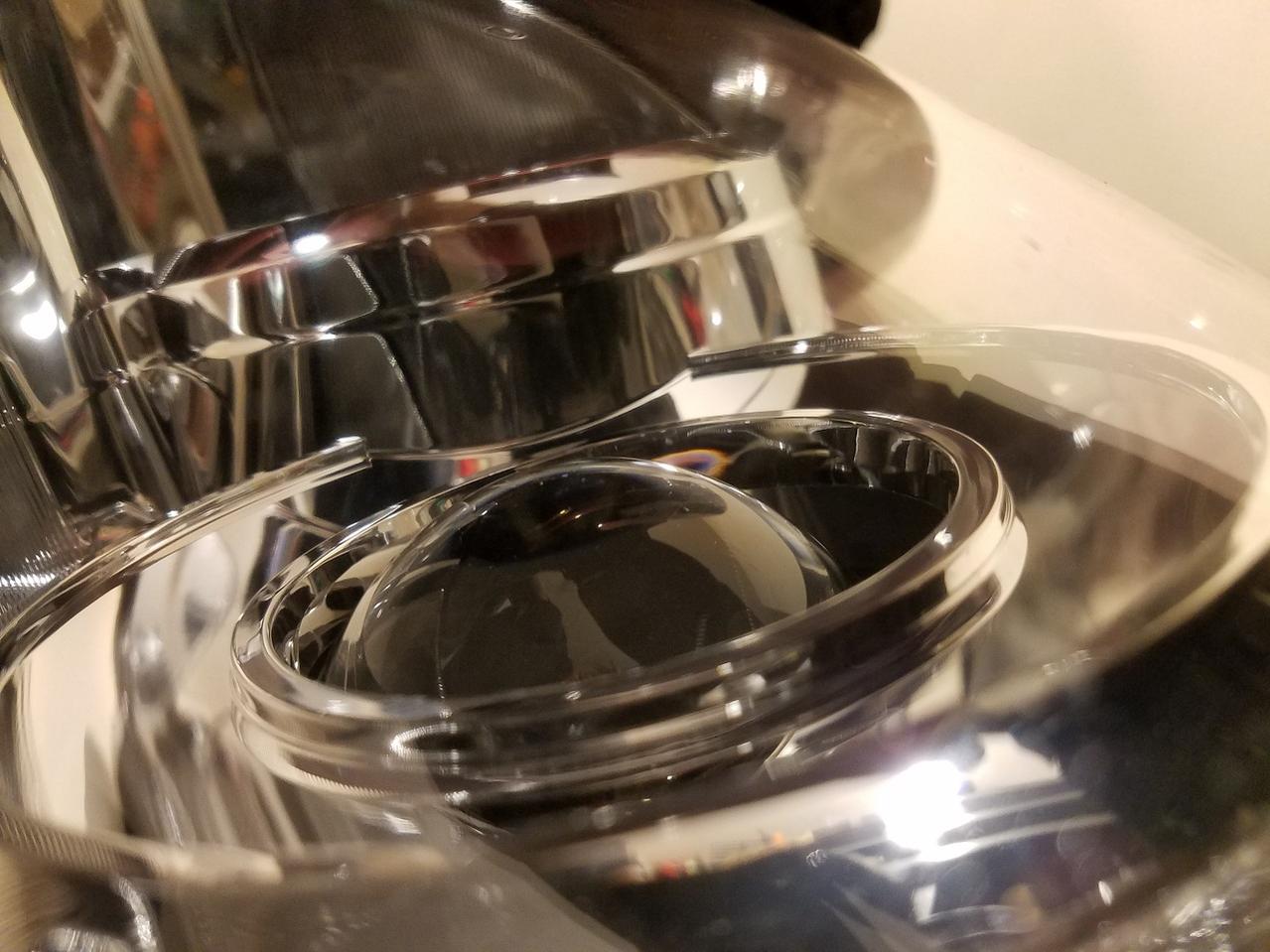

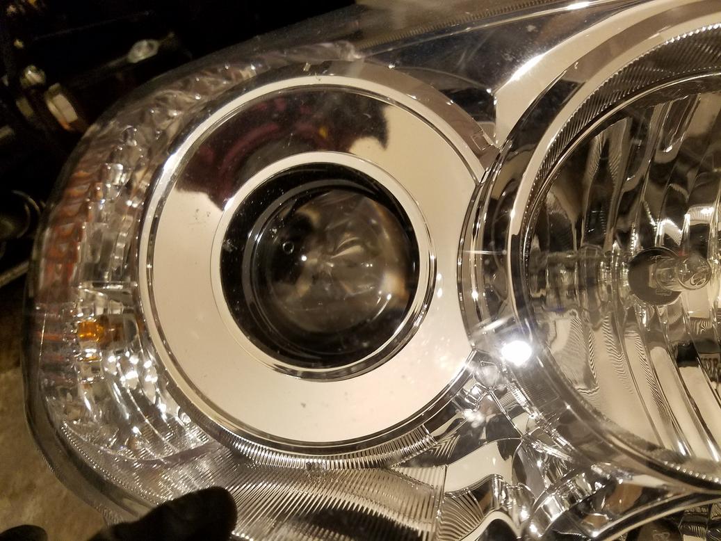

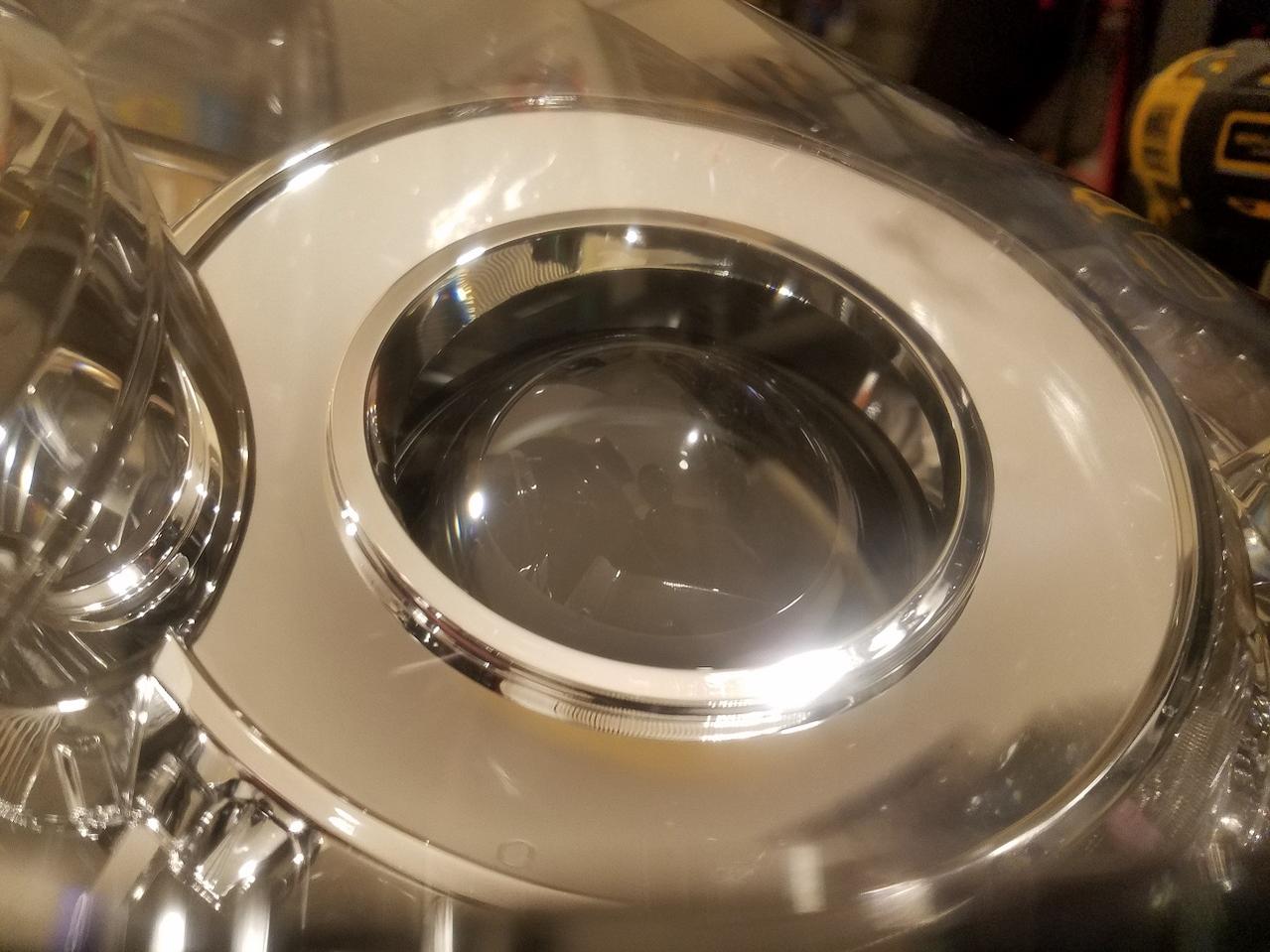

Decided to attempt this Sunday before our Colorado trip in a few days and it was a complete failure. I found it nearly impossible to determine precisely where to cut and where to drill the holes. My lens was pretty badly misaligned from the factory before I even opened the housings so even getting it perfect would leave it poorly centered.
Upon opening the housings turn signal snapped off along with both alignment tabs. Then once the cutoff plate is trimmed I'm trying to line it up to drill holes and realize you have to perfectly align the X, Y and Z axis freehand with no reference point since the housing isn't lined up to begin with. Basically just trial and error putting the shroud/lens on and checking for alignment.
Tried my best aligning it, but even the best attempt was more misaligned and it's also set back about 3/4" like someone posted about previously. At this point I resorted to drilling into the main housing and using small standoffs directly to it. The housing material is very delicate, crumbled and immediately broke off once attached, further ruining the housings.
In the end, even if I managed to perfectly center it with a fairly precise plate by eyeballing it and using hand snips, the OEM housing is horribly misaglined still so it wouldn't work. Gave up late Sunday night and ordered a pair of TYC replacement headlights assemblies with 2nd day ship. Of course FedEx is closed so now they won't arrive till after trip departure. Shouldn't have ever touched these housings, especially before a trip, at this point I'm scrambling to find a housing or cutoff plate before the trip :( (Yes I know, my fault for risking my only headlights)
First Two pics:
Closest I could get it aligned. It definitely sat further down in there than stock, would need to come about 3/4" forward to be flush.
3rd Pic:
Untouched OEM Toyota Pass side projector/shroud alignment. This is how they came from the factory!
