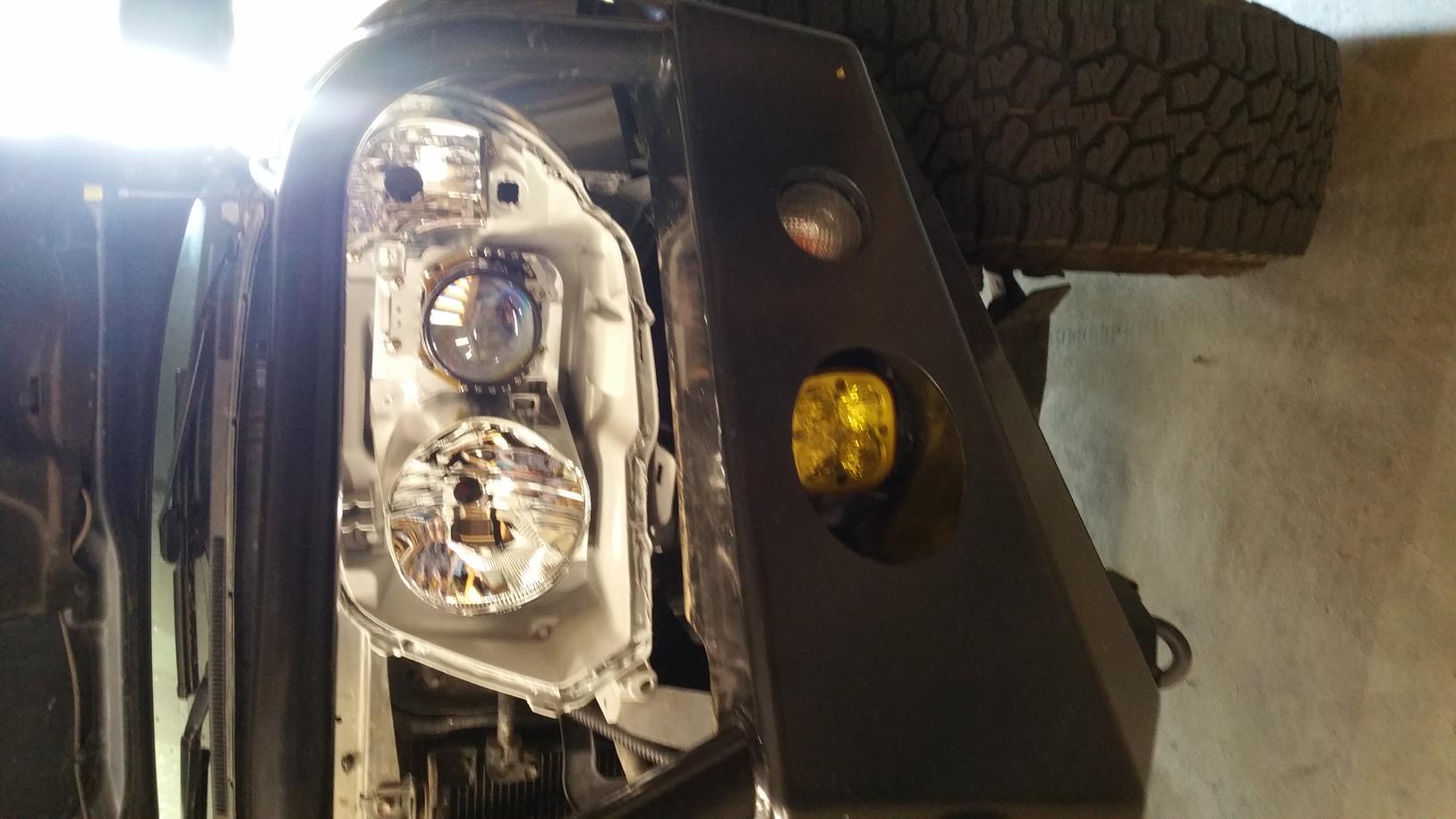

I have a couple rough ones, but I have to tear them back apart this weekend to shim them. I can't get them aimed far enough down to not blind others. I'll take more pictures then and post. It's definitely not as clean of an install as the 4runner

I just did another new retrofit on the 4th Gen.

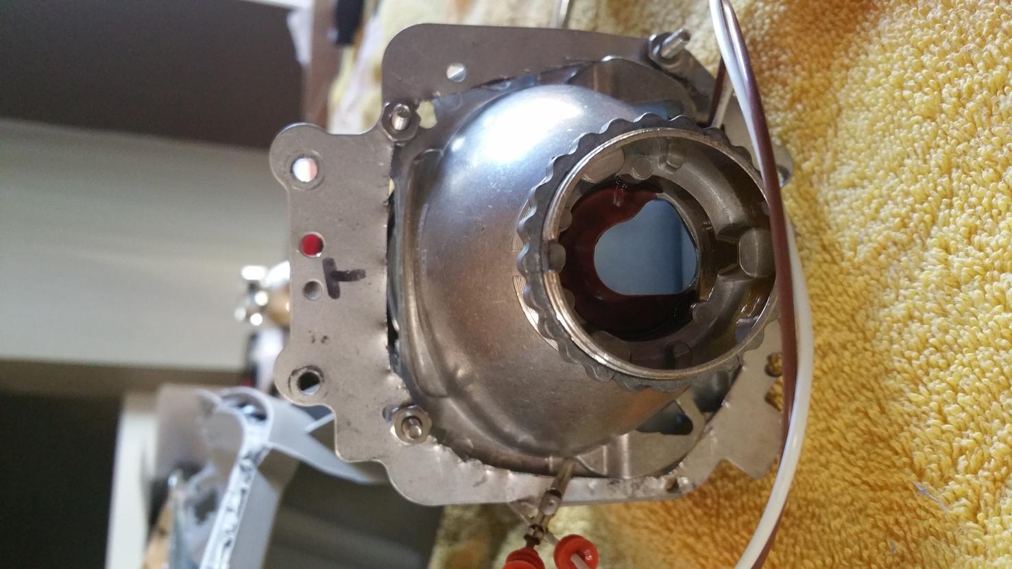

Morimoto D2S V4.0 with CBI bulbs. I reused the brackets that came with the new headlight projectors. I used tin snips to cut out the center and re-drilled new holes to match the 4.0.
The light output of these is amazing. Worth the 8 hours to retrofit.

Here are the brackets I made up using the OEM projector plate. Easy. Measure 10 times and make sure it's centered in the plate and then drill your mounting holes to line up with the D2S 4.0 projectors. These are soooo much nicer than the Acme D2S projectors.
