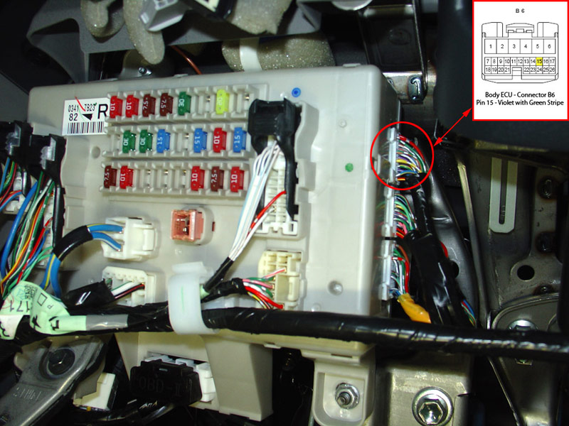

Hey guys, have been busy lately and havent been around much. But I was working on the rig today and did a real quick mod that I have wanted to do for a while now and thought I'd post it up.
That Key in ignition door chime gets real annoying at times and was begging to be disabled.
It really is a minute mod and took much longer to write-up then to do the mod. You just need to cut one wire.
I think the pic below tells the story but for those who want step by step details they are on my site as usual. You can click the pic below to be taken there. Let me know if you find it helpful! :nerd:

You just have to have a strong desire to fix an issue and then study the FSM's to see if it is possible.
Yes, it disables the key in ignition / door chime always. You could splice in a switch where the cut was made and mount it somewhere accessable if you only want to disable it when working on the rig or listening to the stereo or such. I did not want that functionality so I didnt do it.
