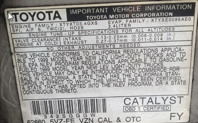

This is what it said under my hood top left.
Engine Family XTYXT03, 4 GXS
SIF, A/F S, TWC (2), HO2S
Not sure about HO2S (2) - Didn't see the listing with parenthese (2).
I've attached a photo. Hopefully it will show up for you to review. :thanks:

Look what I wrote. The HO2S (2) is for the Federal, which has 2 Heated Oxygen Sensors and NO A/F. The Cali. has ONE A/F Sensor and ONE HO2S, so no (2) for you.
Yours is beyond doubt a Cali: One Air/Fuel Sensor, Two Three-Way Cats, One Heated Oxygen Sensor.
[MENTION=10169]TheDurk[/MENTION]
That was it! I replace the Air/Fuel Sensor. All is back to normal. No more check engine light. Just in time for my next smog test only check. Thank you!
