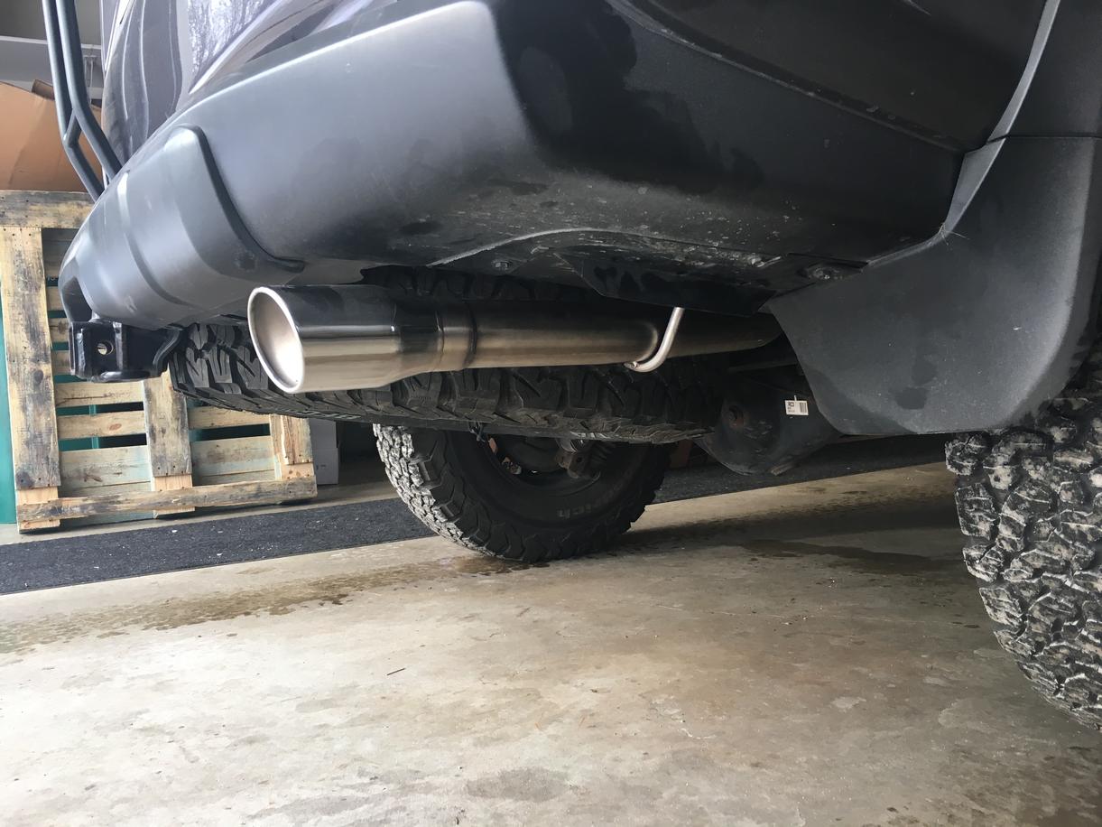

-Borla Exhaust (made a video comparing stock to borla sound)
My Research & Install Thread for the Borla exhaust:
http://www.toyota-4runner.org/5th-gen-t4rs/229765-borla-exhaust-intall-comparison-stock-video.html

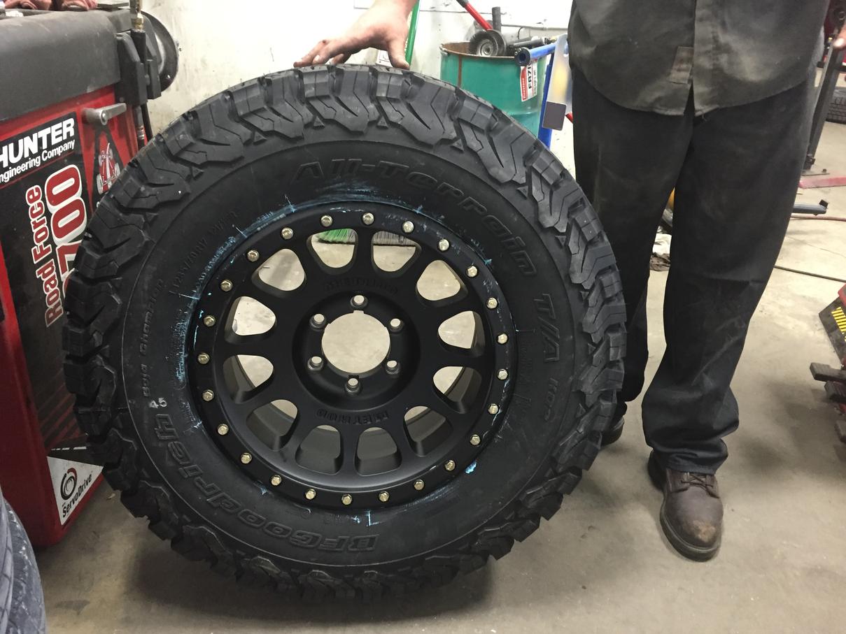

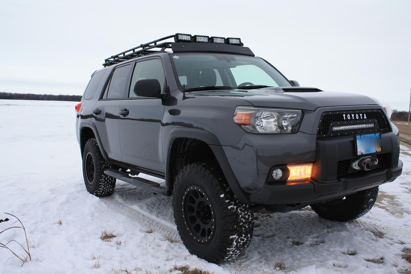

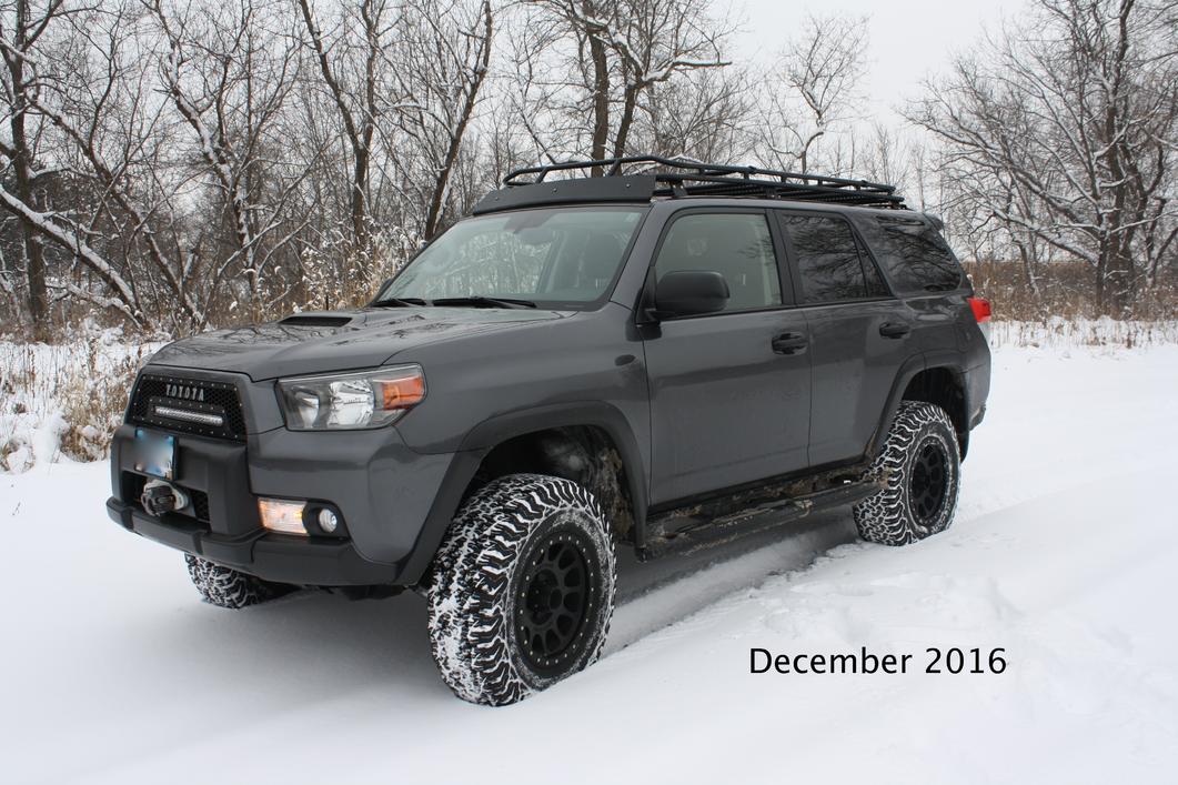

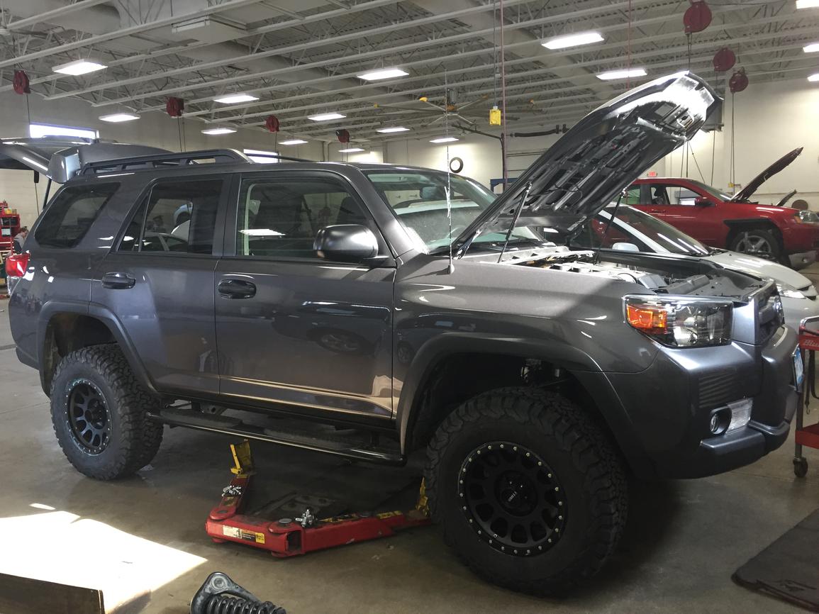

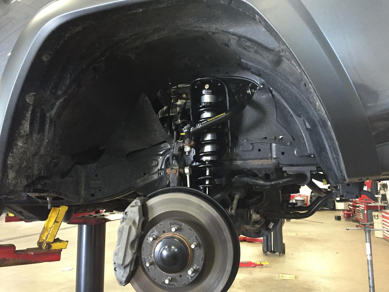

From the Garage to Rig
1) Icon stage 2 lift kit with tubular UCA's (3.5" lift front, 2" rear)
2) Method NV 17X8.5, matte black
3) BFG KO2 285/70r17, laces in
Here goes nothing. I have to get her aligned. I will post the final pics when I get some good ones!

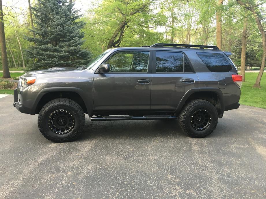

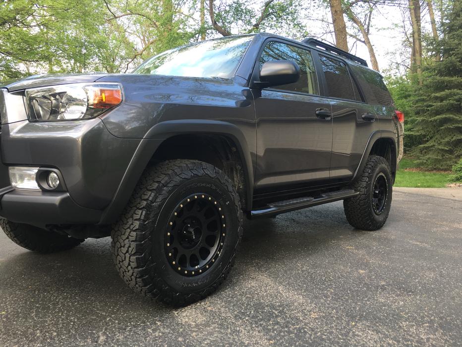

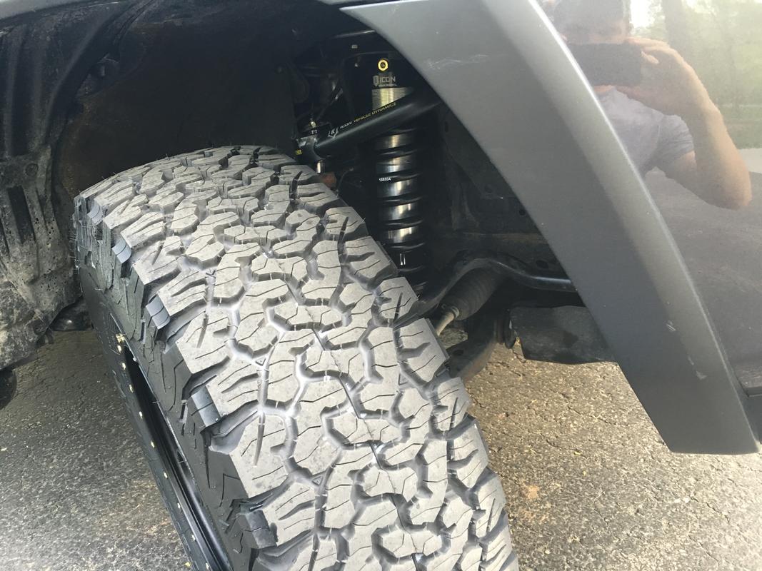

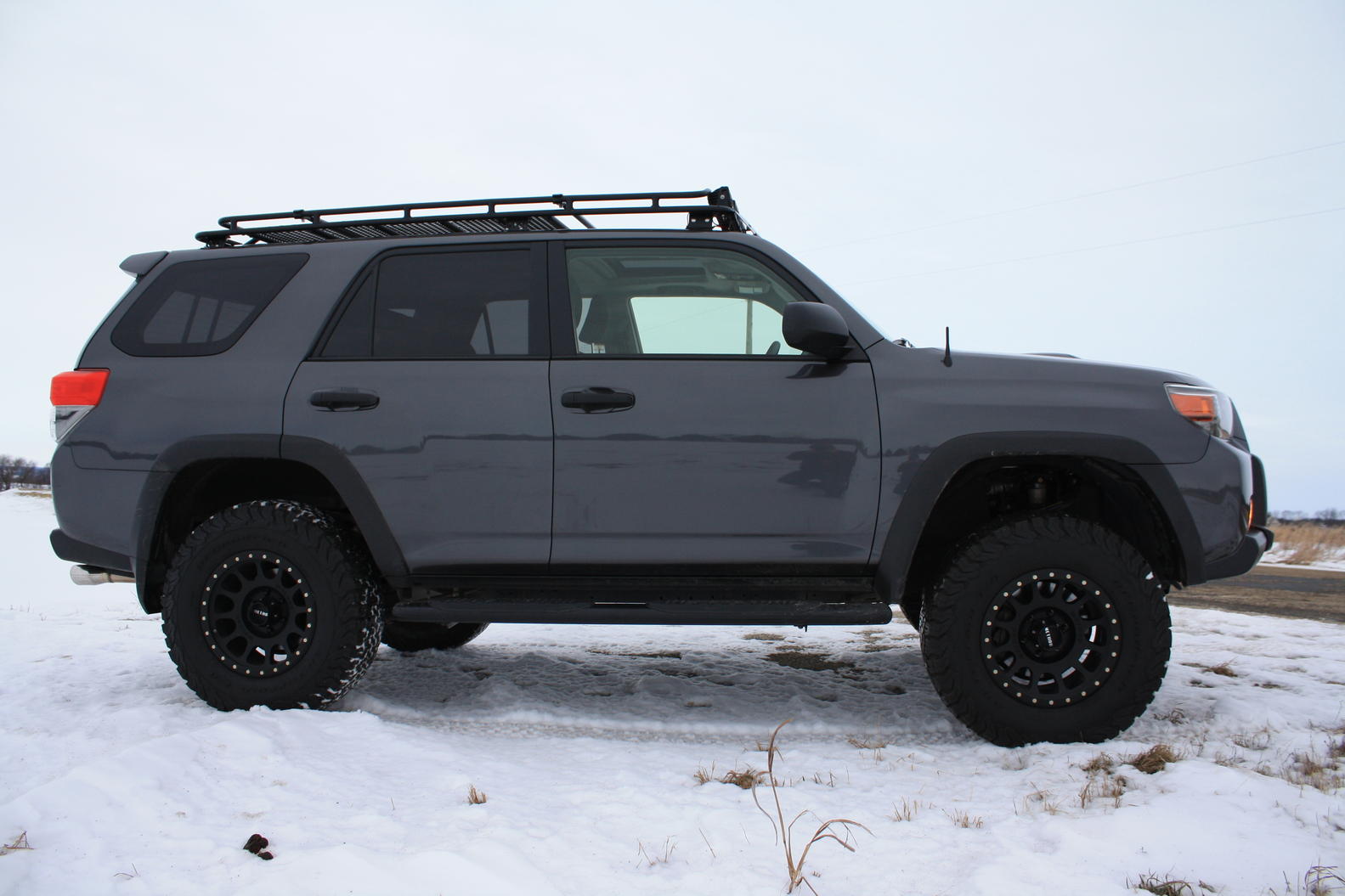

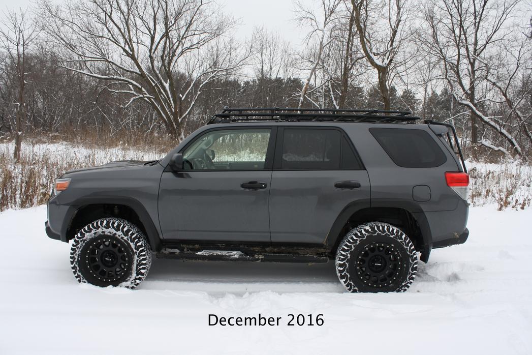

Stage I done
Very satisfied with the setup. Happy to field any questions or comments. Again:
1) Icon stage II with tubular UCA's
2) BFG KO2's 285/70r17 (mud flaps gone, Harper7 fender mods, no BMC)
3) Method NV 17x8.5
*** No they don't rub ;)

Does yours have KDSS? How does the Icon ride? I'm kind of leaning toward going that route.
I do not have KDSS and just installed recently. After some limited use, however, I can say the following:
1) The icon rides beautifully. It brings the front end up and "allows the front end to run over things," so you will notice a little more of a pillow when you jack on the breaks. Responsiveness is mildly muted, too, if you throw some bigger tires under there, but this I accommodated for during the first drive and never noticed again. That said, it takes some of the body roll out of the ride and for all other purposes appears to be comparable to or better than stock on the road. Completely awesome off road...
2) The tires I selected add to this: The BFG KO'2 are all terrain, not mud, so they aren't as aggressive and ride quieter than the biggun's you hear humming down the freeway. That certainly adds to the ride quality so please consider this.
3) No regrets. Be patient. Icon, like many other reputable suspension manufacturers, is on backorder and if you order today it won't be around for a month. Worth the wait. If you are thinking about it and have the money, you will be happy in the end:)
Let me know if something else comes up.

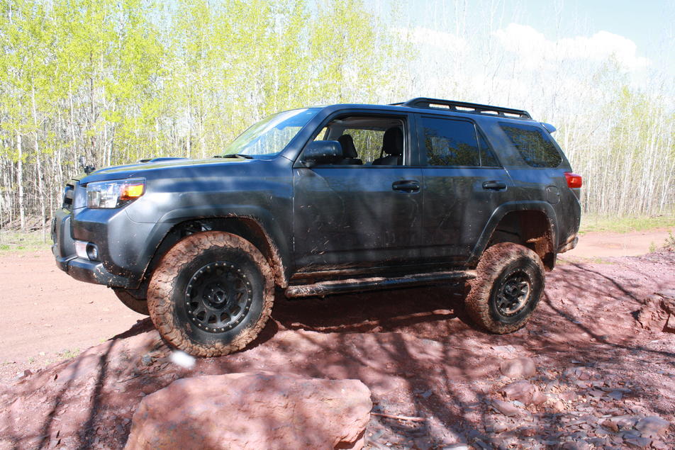

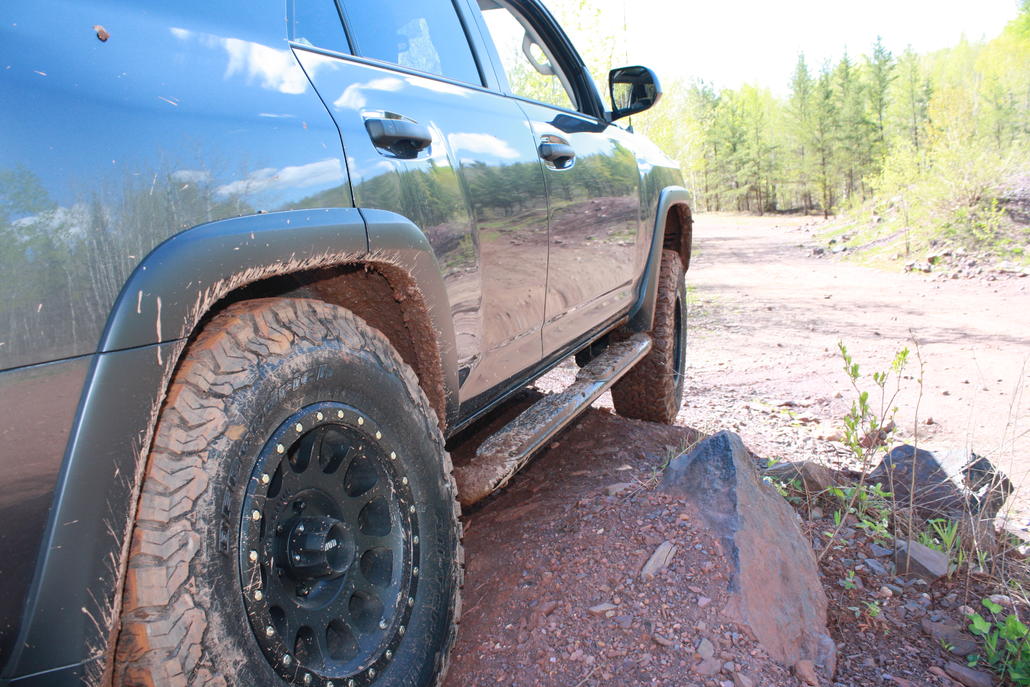

Getting out there, Iron Range

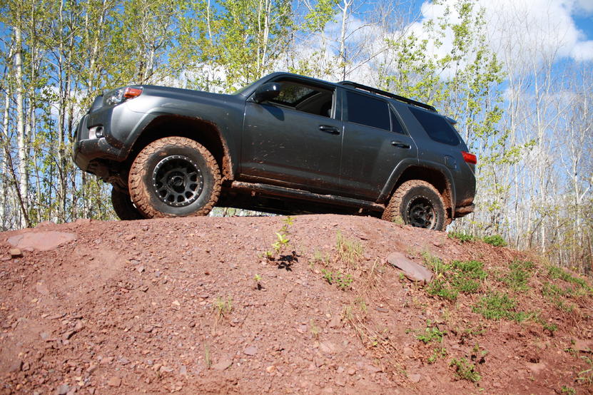

Got out to the Iron Range, MN today to challenge the wheels/tires/suspension. The Icons worked like a dream, BFGs got a little slick after a heavy dose of mud. Rode all of the easy and difficult routes, saved some of the expert and rock crawling routes for after my winch install. Fun Times! (No, dude, they didn't rub :becky:).

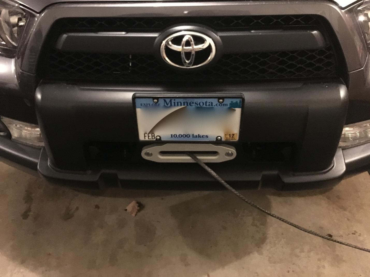

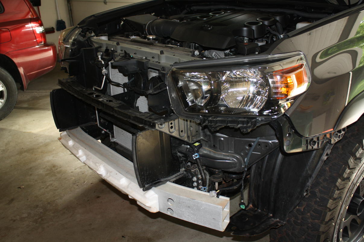

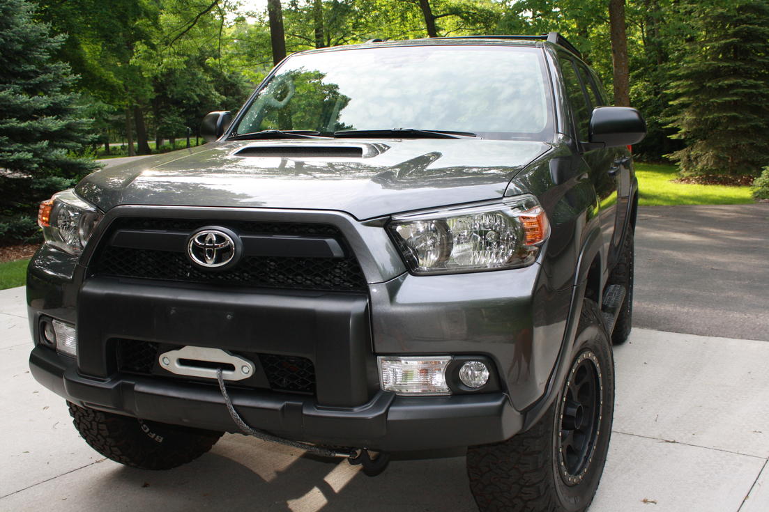

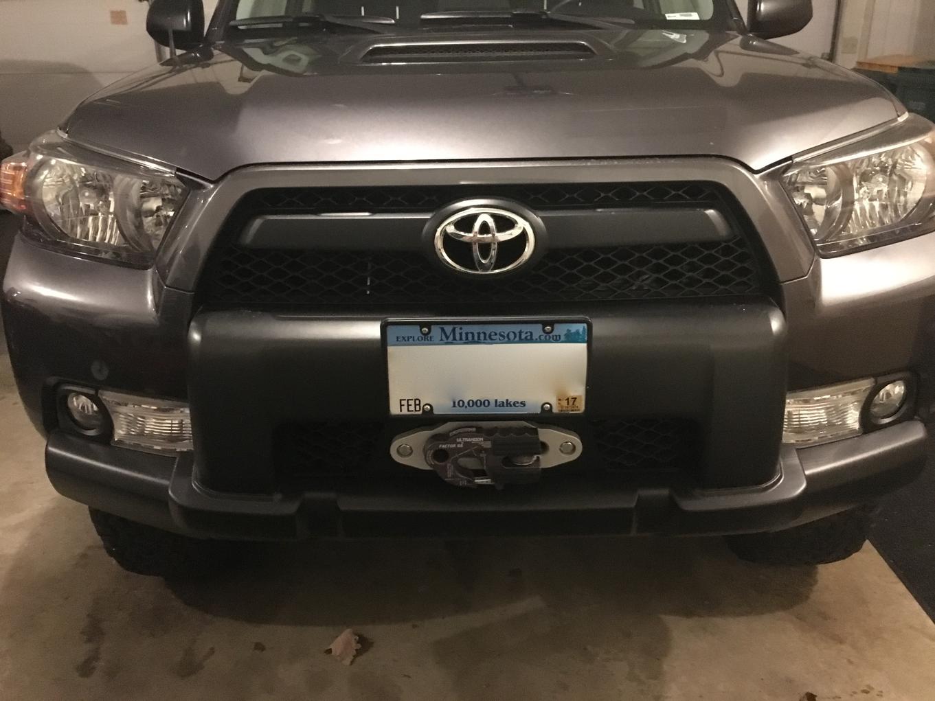

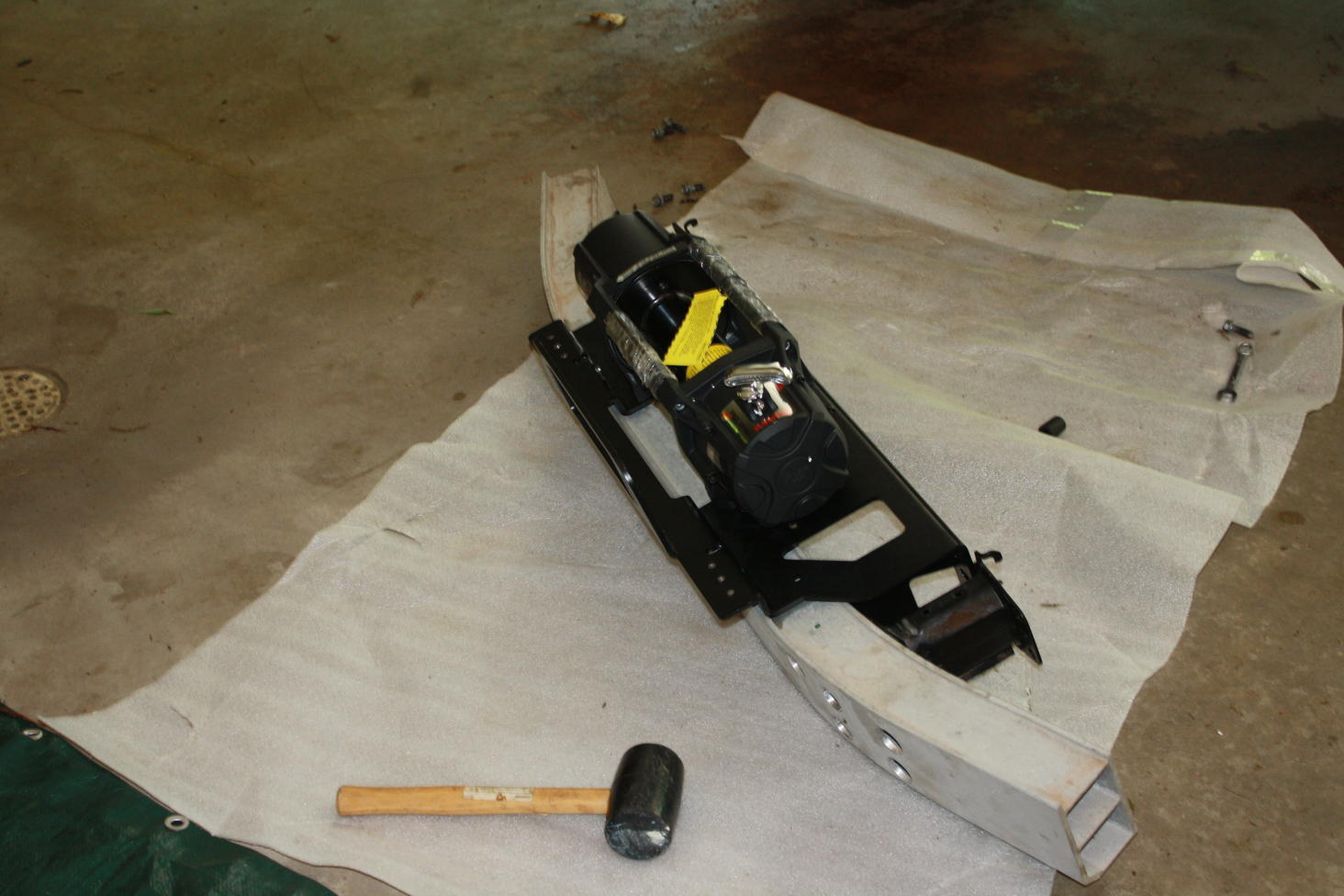

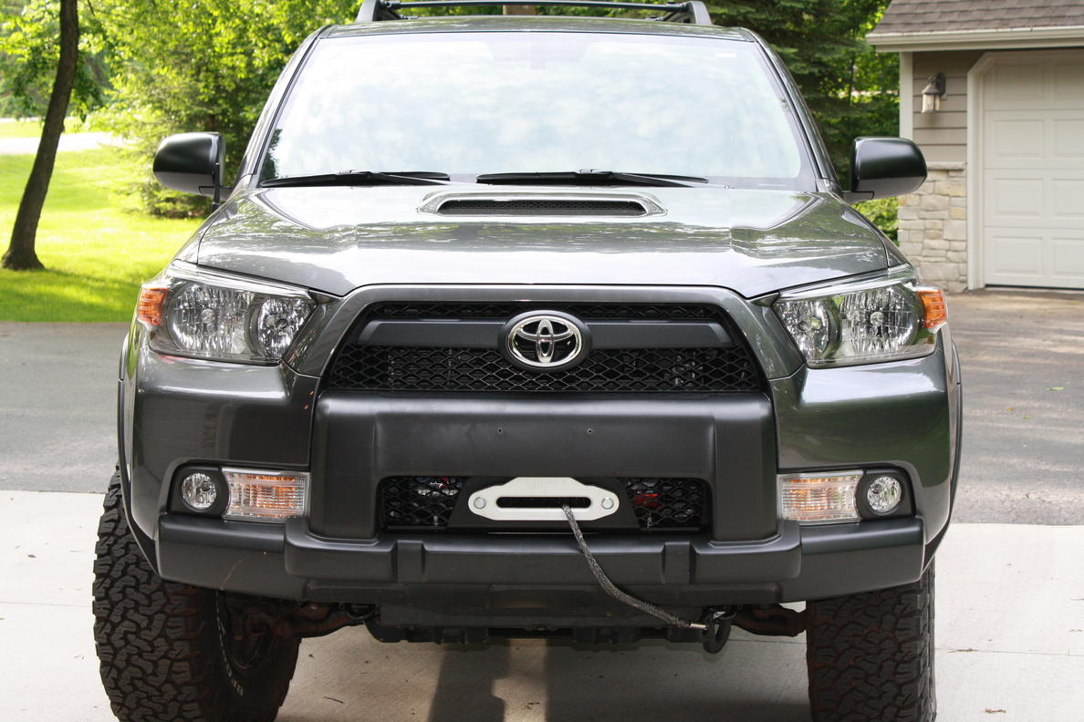

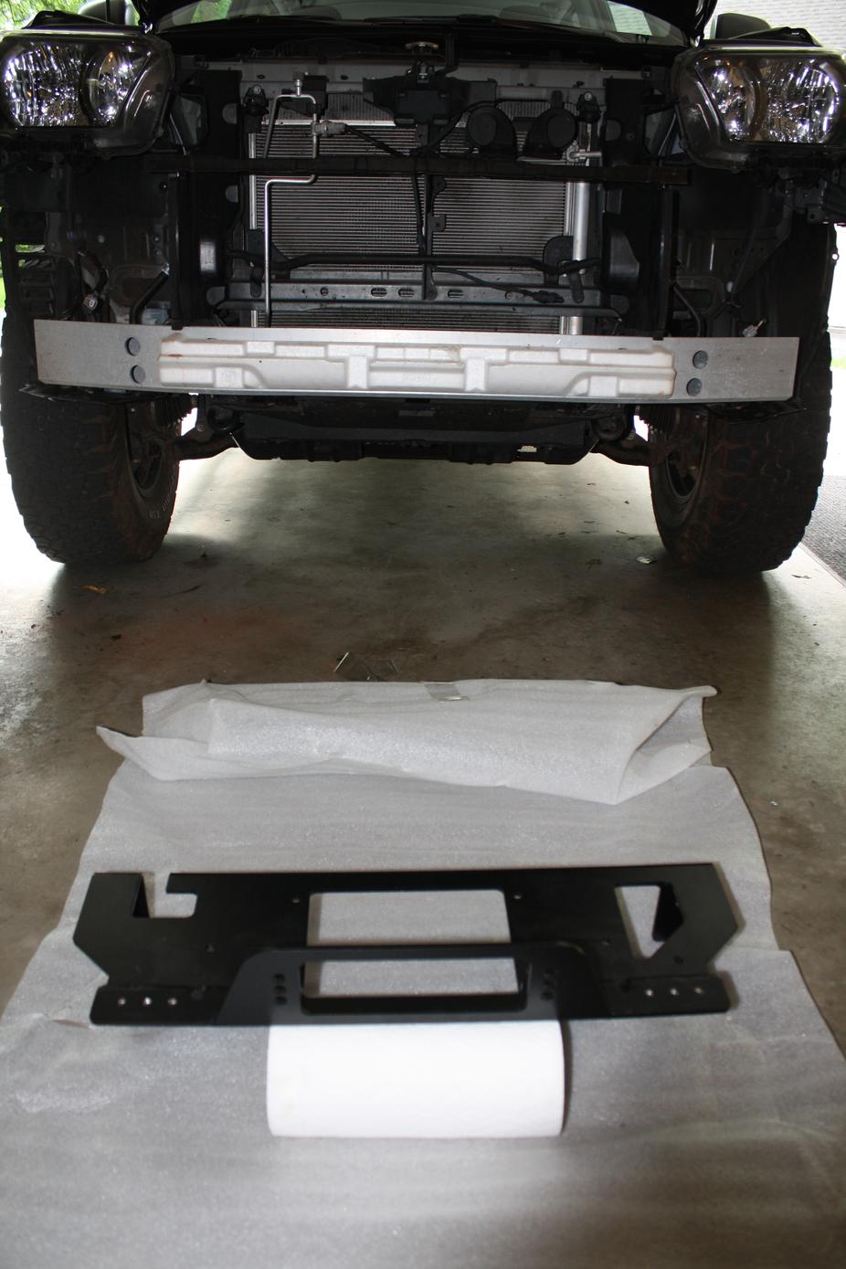

Budbuilt Winch Mount with Smittybilt Winch

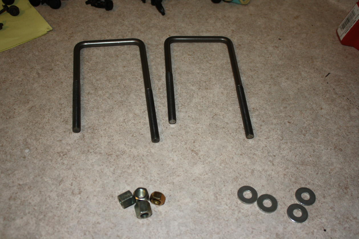

Took the day (literally) yesterday to install the bud built hidden winch mount with the smittybilt winch. This I researched through the threads and all you need to know is:
1) How to get the bumper off (lots of threads, but a video is king) https://www.youtube.com/watch?v=cm58R6CJKl8
2) How to install the mount (If you email bud, he will literally send you this writeup) http://www.toyota-4runner.org/4th-gen-t4rs/152556-bud-built-hidden-winch.html
Couple things:
1) Bring a darn friend, at least for the part where you load the winch, plate, and front end reinforcement back on the chassis. People have written this for a reason. The assembly easily weighs 125 bounds, more if you have a cable loaded on there already. It SUCKS to lift this on your own at 9pm and have your wife hand you bolts.
2) Some folks have written about removing the middle bolts, but just loosening the outside bolts to slide the mount in. There is no slide, particularly when you are cramming 100+ pounds of winch plus mount directly where your radiator tubing is. You can certainly try, but be prepared to do it exactly how [MENTION=86678]ebg18t[/MENTION] wrote it up.
3) The front end reinforcement bolts are tough, particularly in the setting of corrosion, rust penetrant and a long torque wrench are your friends!!!
4) Get the winch on the plate before you attach the reinforcement (I am an ass, that cost an hour)
5) Get a wireless winch or be prepared to move the solenoid (control box) under the hood using 2-4ga marine electrical wire and the internet
6) The U-bolts supplied are little long. Be prepared to cut the smaller side so that it doesn't abut the winch.
7) There are some brackets holding the radiator tubing (black, crossing the field). Loosen those. The tubing can go up about two inches.
***8) Remove all of the meshing out of the lower valence. My pics show it in, but I have actually trimmed it with a dremmel. This resulted in two 7 inch pieces that I then trimmed on the bottom and sides to "pop" into place. I can push on them and the pop off for access to the clutch and control box. I think this looks clean, and can avoid you having to stare at the ugly bolts and cluster of wires around the winch.
Enjoy!

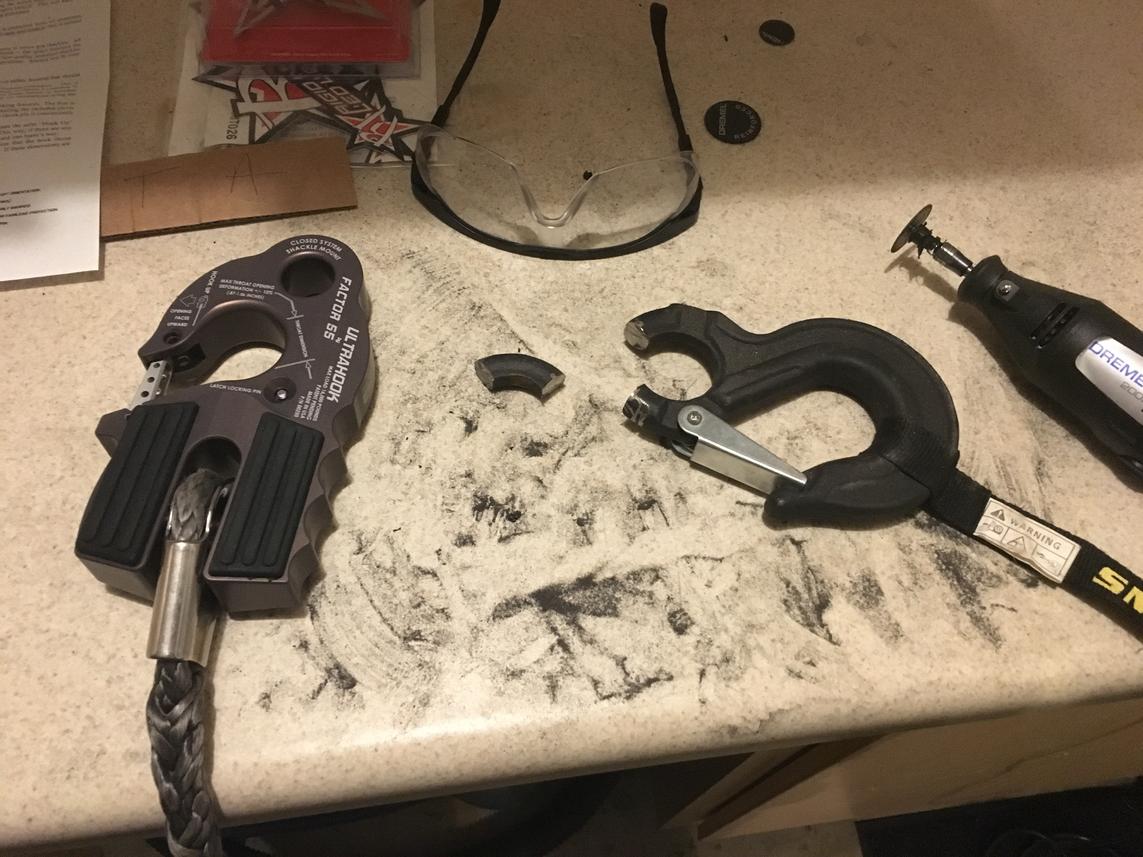

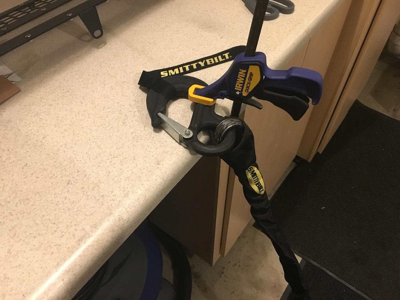

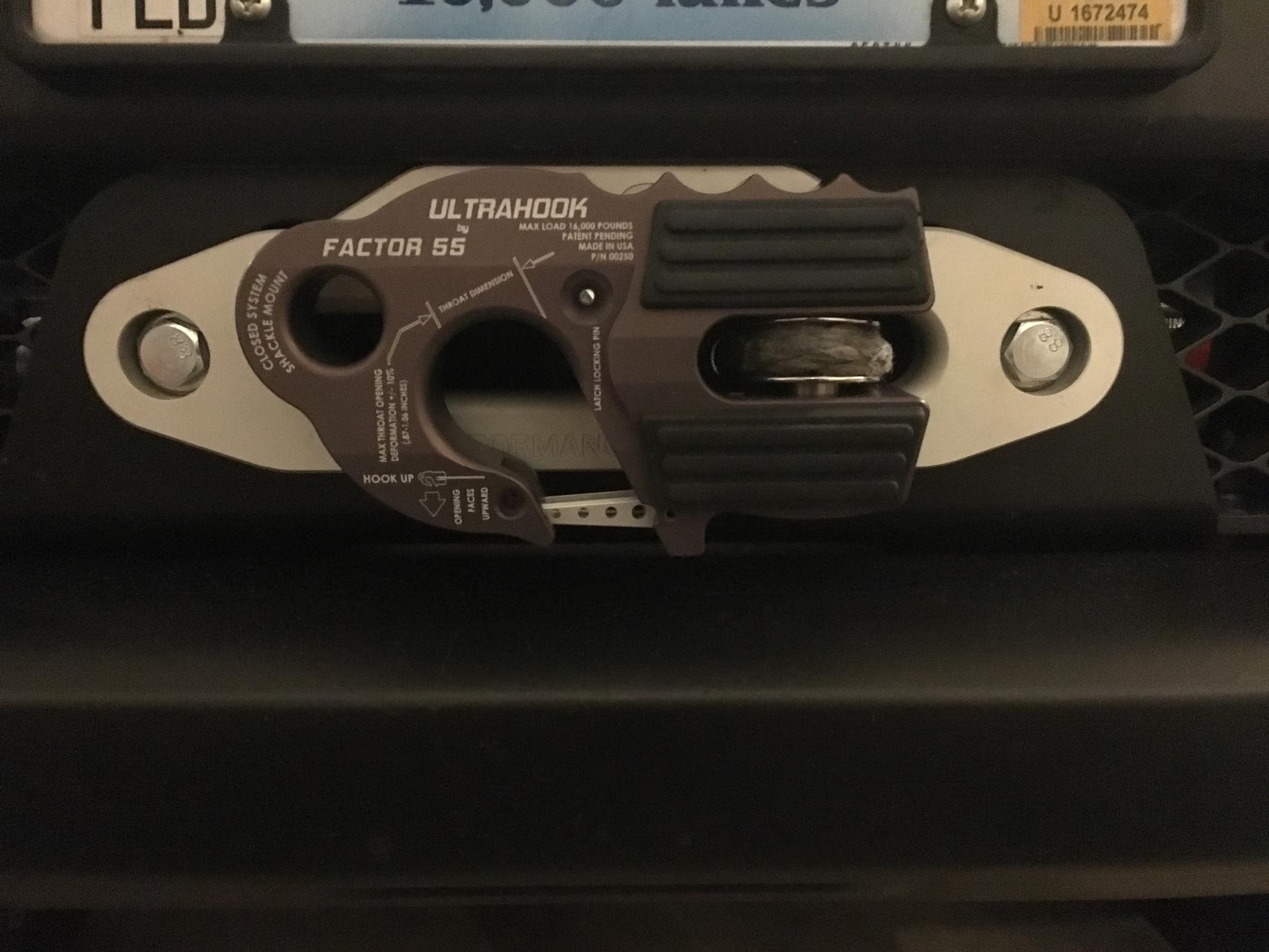

Factor55 Ultrahook Install
Although I felt the price was a bit high, I decided to front the cash for the factor55 ultrahook to have a lightweight, ergonomic, flat-lying winch hook that had both clasp and shackle mount options. The smittybuilt winch hook (that came with my winch) required a little work with the dremel to get off. In the end, I love the Ultrahook look, it keeps the hook off of the frame and out from under the vehicle, and keeps the synthetic rope out of the elements and under tension, which is claimed to be better for it. Let me know your thoughts.... :)

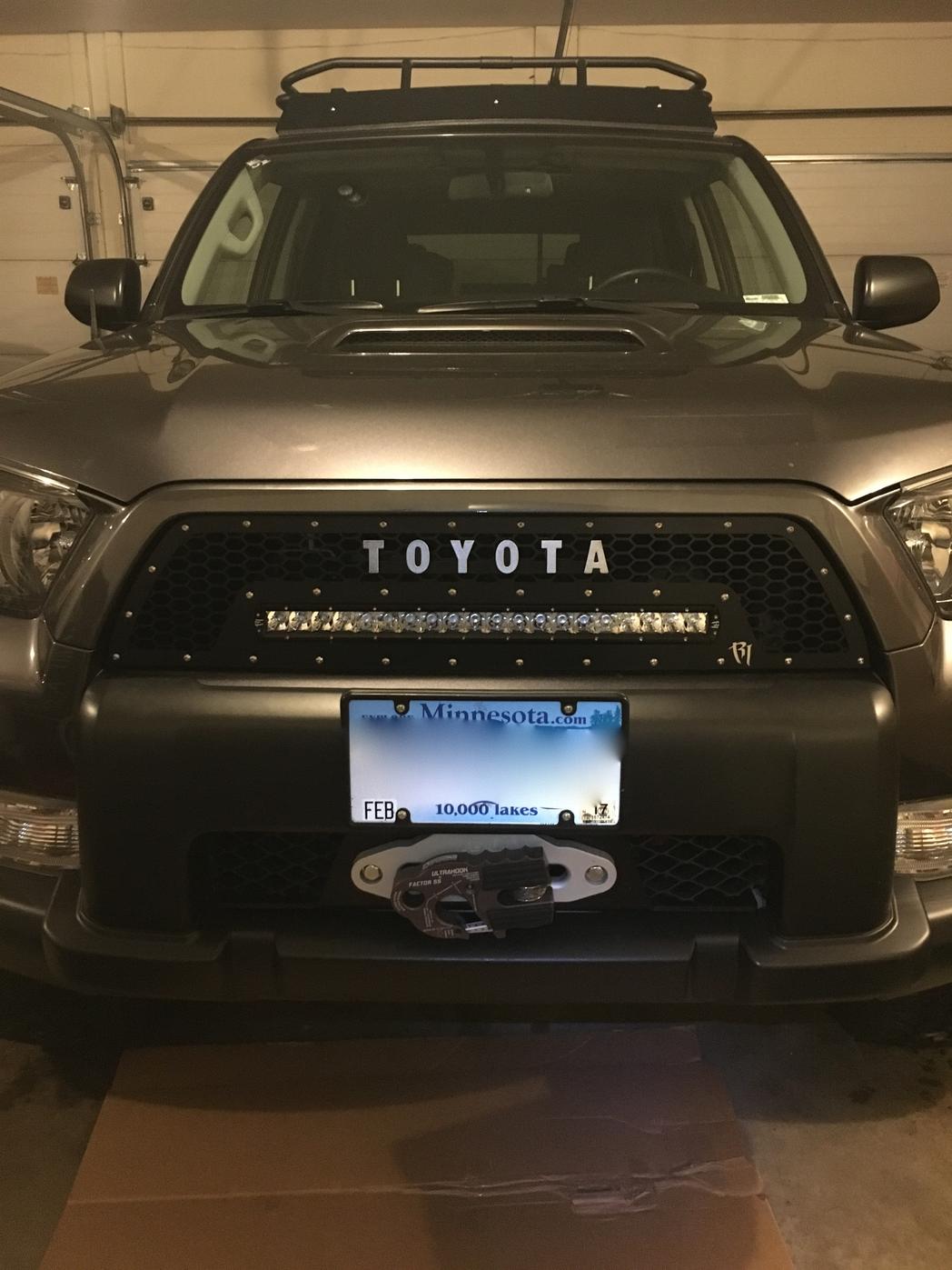

Stage II of Build - Gobi Rack/ladder/deflector, Rigid Grill, Borla exhaust
Busy weekend:
Rigid Grill - http://www.toyota-4runner.org/5th-gen-t4rs/229749-rigid-fj40-grill-mod-2013-trail.html Read the thread, look at the pics, and cast your vote for black versus chrome grill screws if you have an opinion https://www.surveymonkey.com/r/5BSTTMF
Borla exhaust (video!) - http://www.toyota-4runner.org/5th-gen-t4rs/229765-borla-exhaust-intall-comparison-stock-video.html
Gobi Rack - See pic below. really nothing to add technically after reading [MENTION=59081]W8kbrder[/MENTION] 's awesome thread http://www.toyota-4runner.org/5th-gen-t4rs/194234-diy-gobi-stealth-roof-rack-ladder-install.html
I will post an update after I get the shrockworks distribution box under the hood, the AOB switches in the cab, and the rigid E-series lights on the rack.
Enjoy

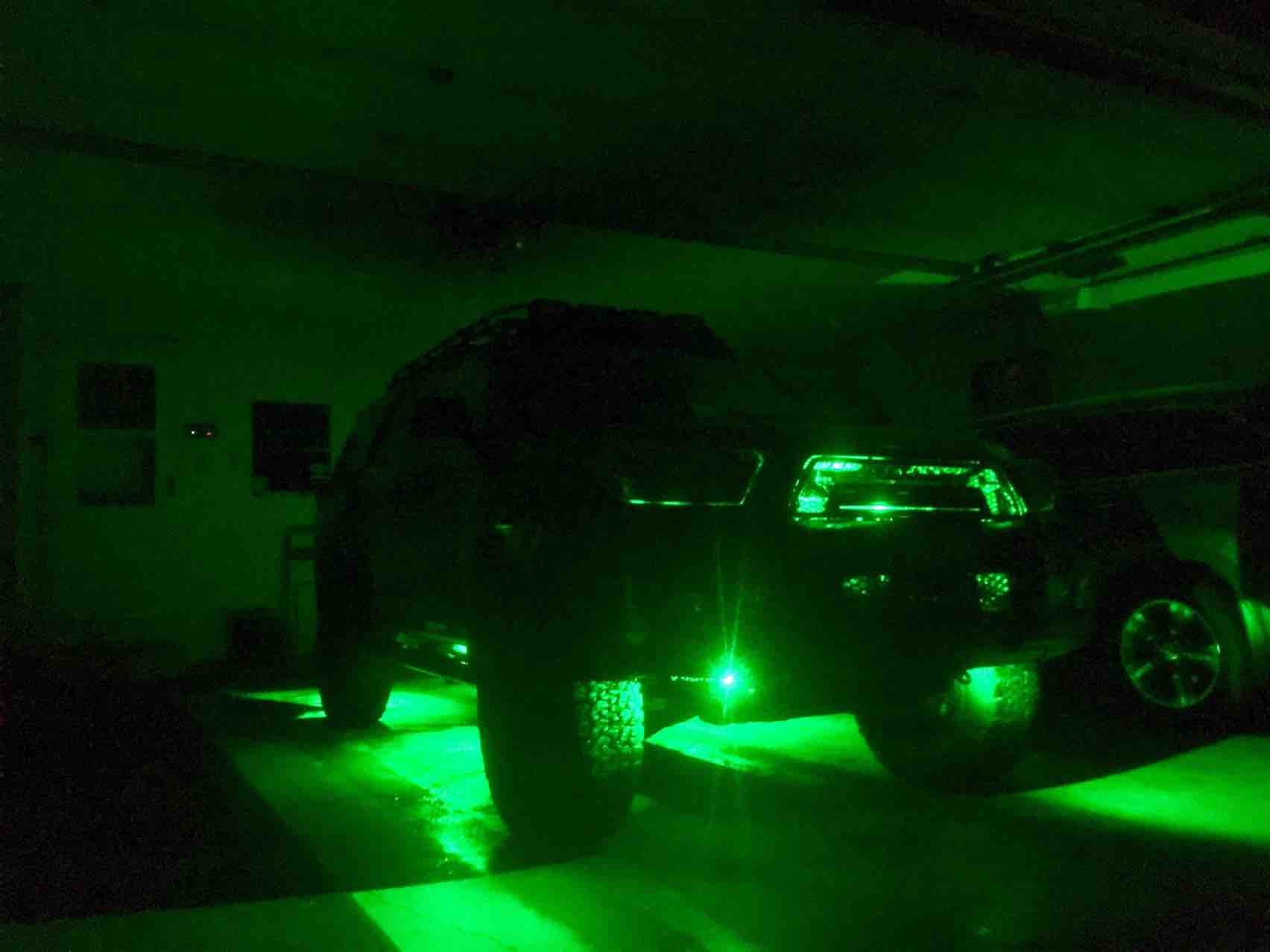

Xprite rock lights installed, 8 pack. They are cheap, fun, bright and have nice red, green, and blue colors (which you can change with Bluetooth). The white is not a true white, so I may change up or add legitimate cool white lights later. I realize they are not for everyone, but I kinda like 'em and my kid is having a blast "Zombie Hunting" on farm roads with his dad.IMG_1894.JPG

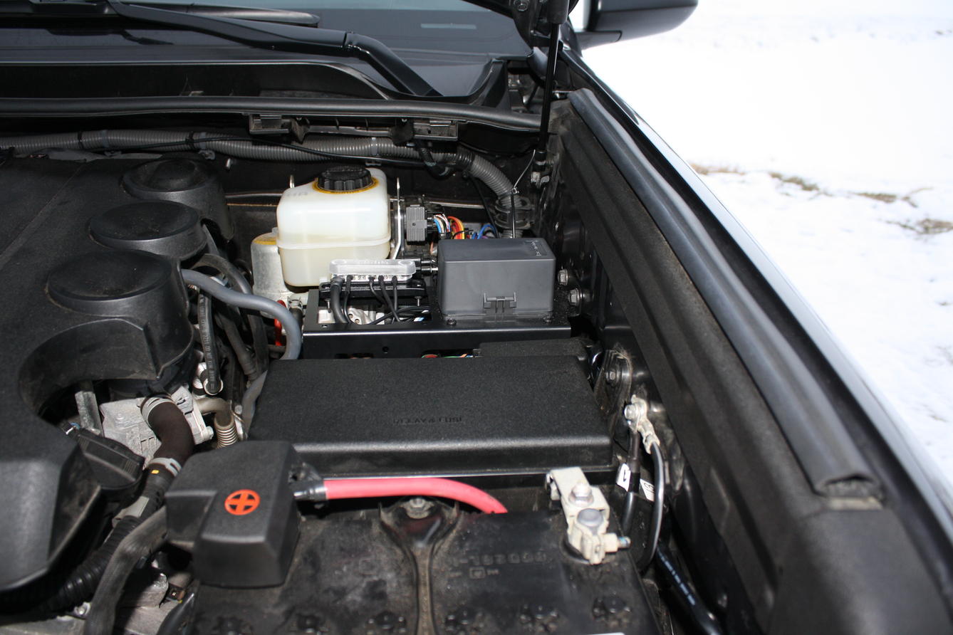

Second stage of the build done. Wifey was kind enough to give me a break from the kids to put the time in. Been posting along the way. Finally got her out of the garage and out for some snowshoeing today. Happy new year!

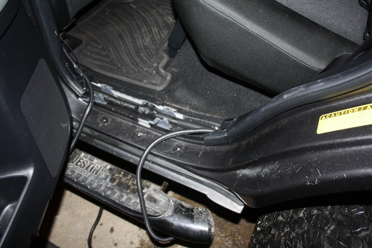

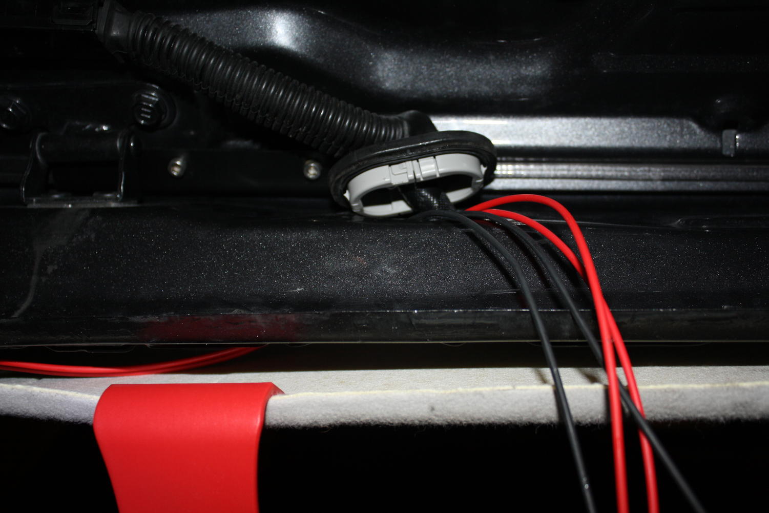

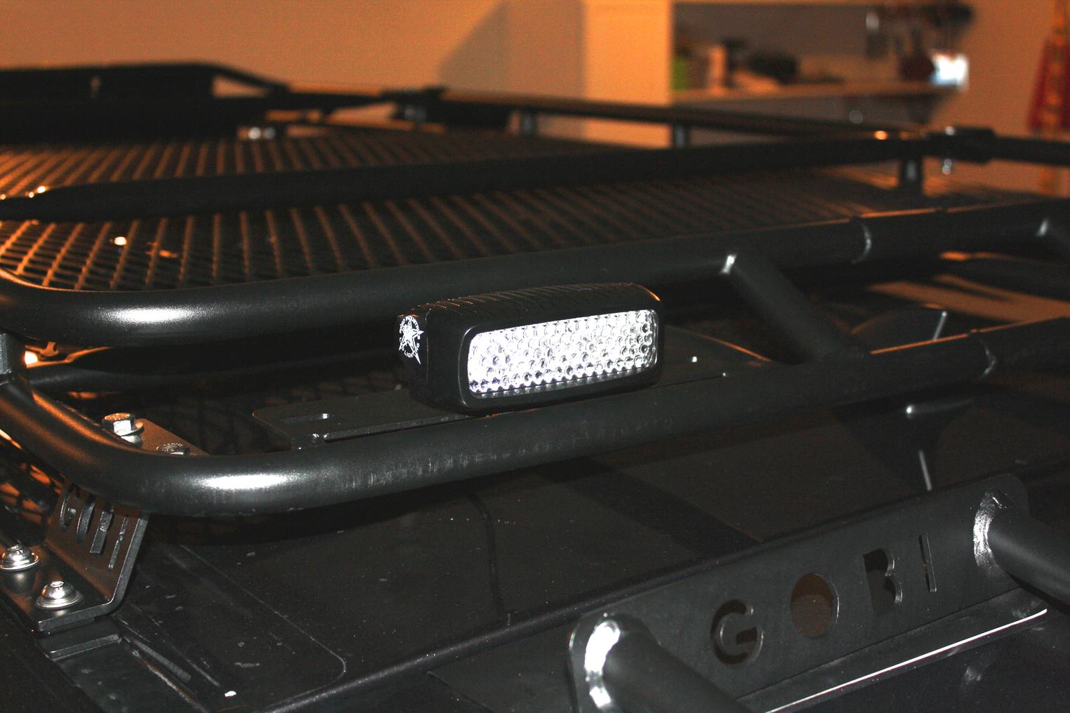

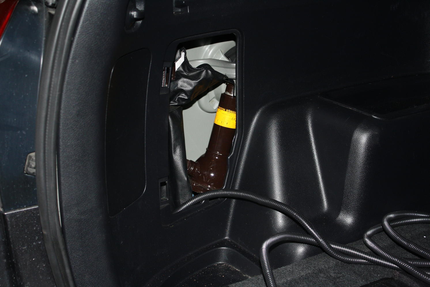

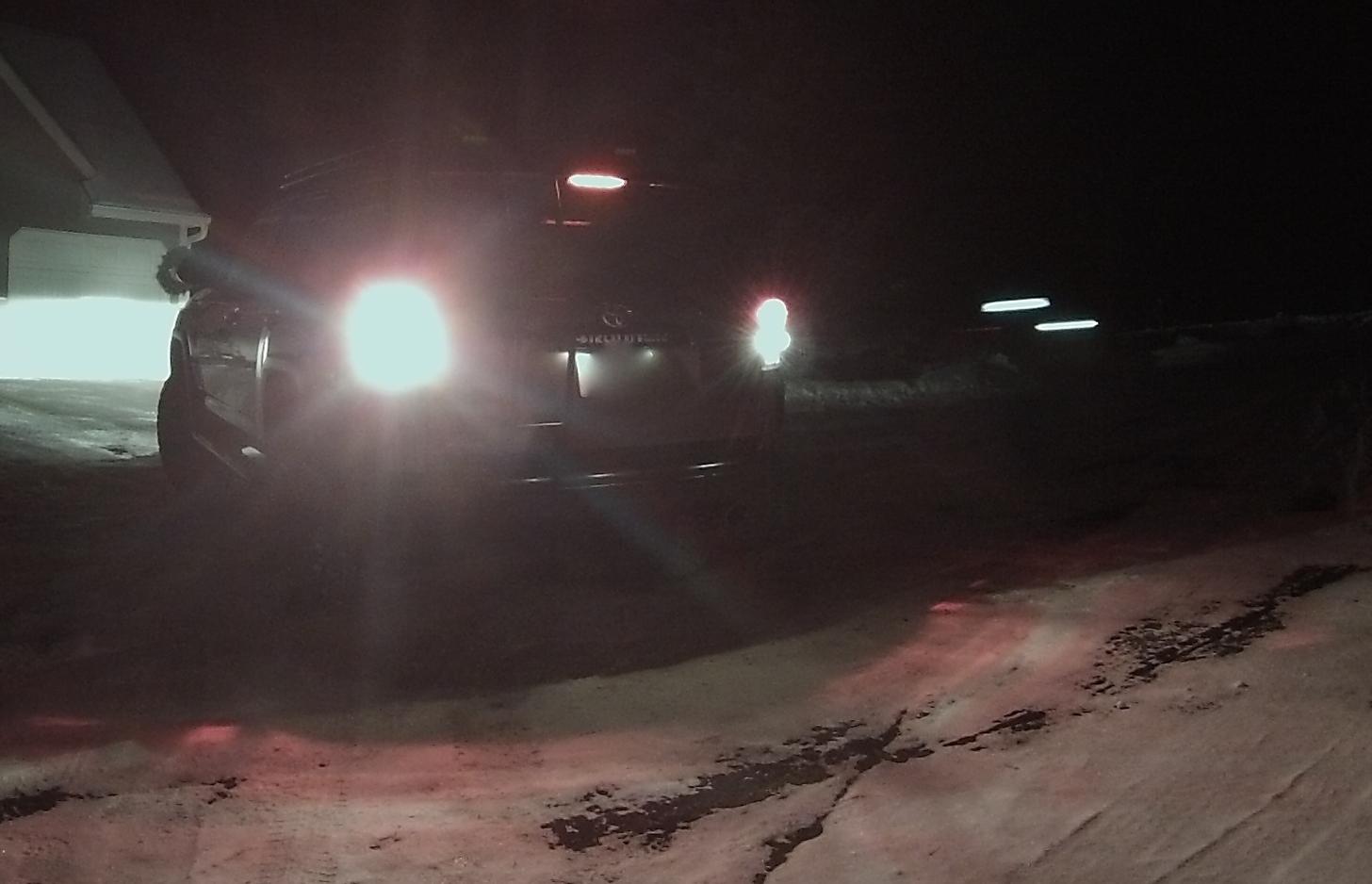

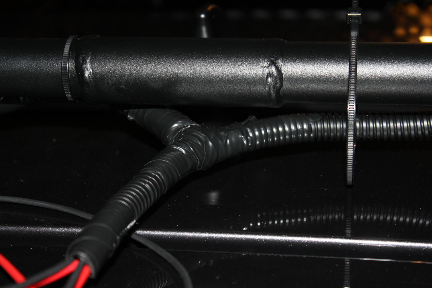

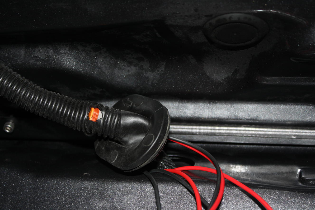

Rigid SR-Q Backup Kit 4Runner
I live around deer, dogs, kids, and dark. I thought that the backup kit from rigid would be a nice fit.
1) I mounted the lights with the provided hardware in the center mounting hole on each side at the rear of my Gobi Rack
2) I pried up the rubber grommet coming from the body to the hatch, after removing the hatch rubber trim and gently prying the hatch roof trim down with a trim tool, ran the harness through the hole in the body then through the grommet itself (through a small hole that I made). I then thoroughly taped the grommet with heat shrink tape. These wires would then run through the gap between the body and the hatch where it does not pinch, be loomed, zipped to the Gobi, then connected to the lights.
3) I ran the part of the harness with the relay toward the driver kick panel, using a trim tool kit to carefully remove the hatch trim, run the wire harness toward the jack storage box, then remove the hatch side trim, run toward the rear passenger door frame floor trim.
4) I ran with the stock wiring long the door frame floor trim, removed the driver kick panel, zipped to other wiring under the dash, and ran toward the center console

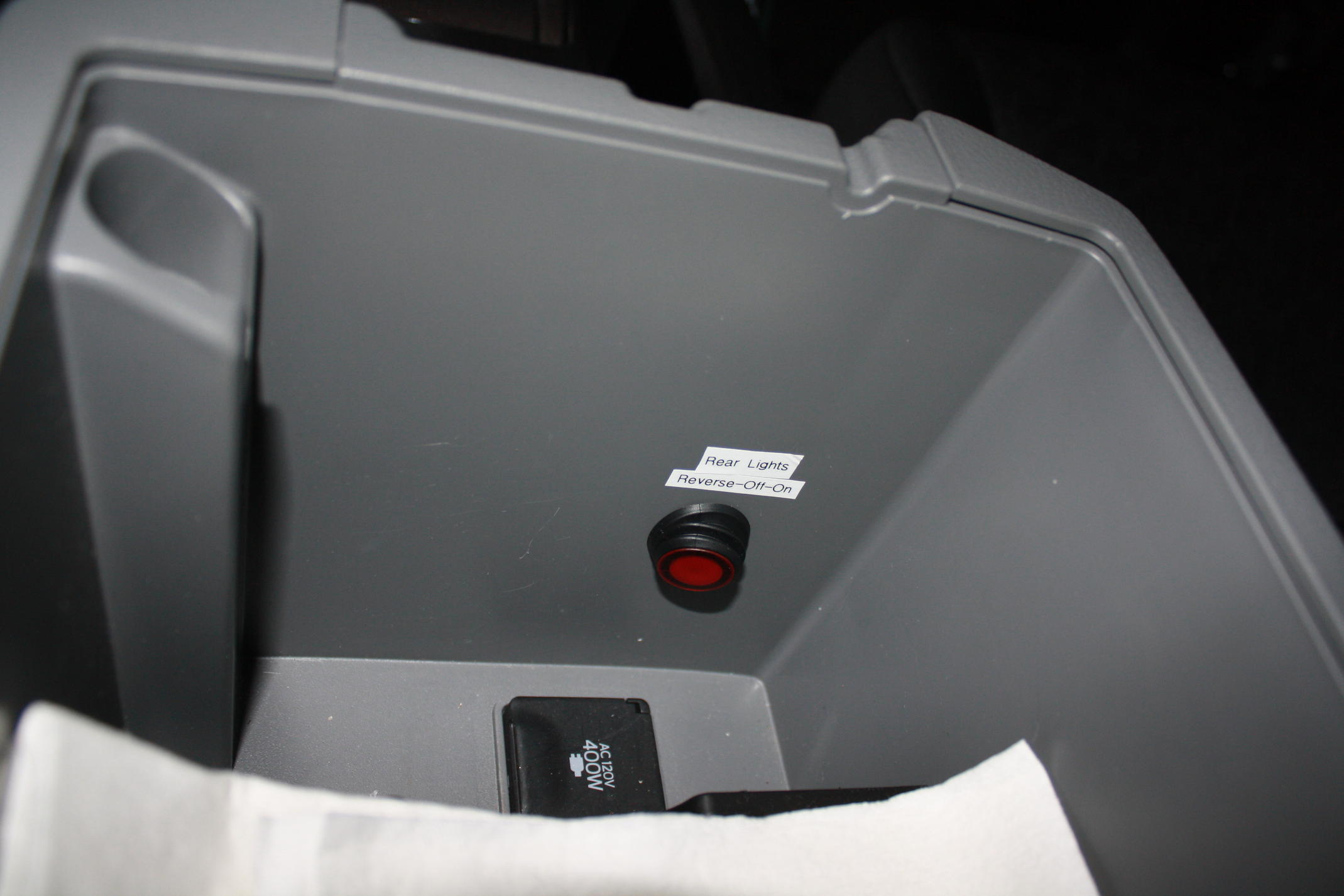

5) The power I hooked to my Bussman RTMR at one of the constant draw outputs, the switch wires off of the relay provided with the harness I ran to the center console storage
6) Leery of drilling my dash, and to provide a barrier from turning these on in the face of tailgaters, I drilled the center console, 3/4", and mounted switch inside of the center console storage box.

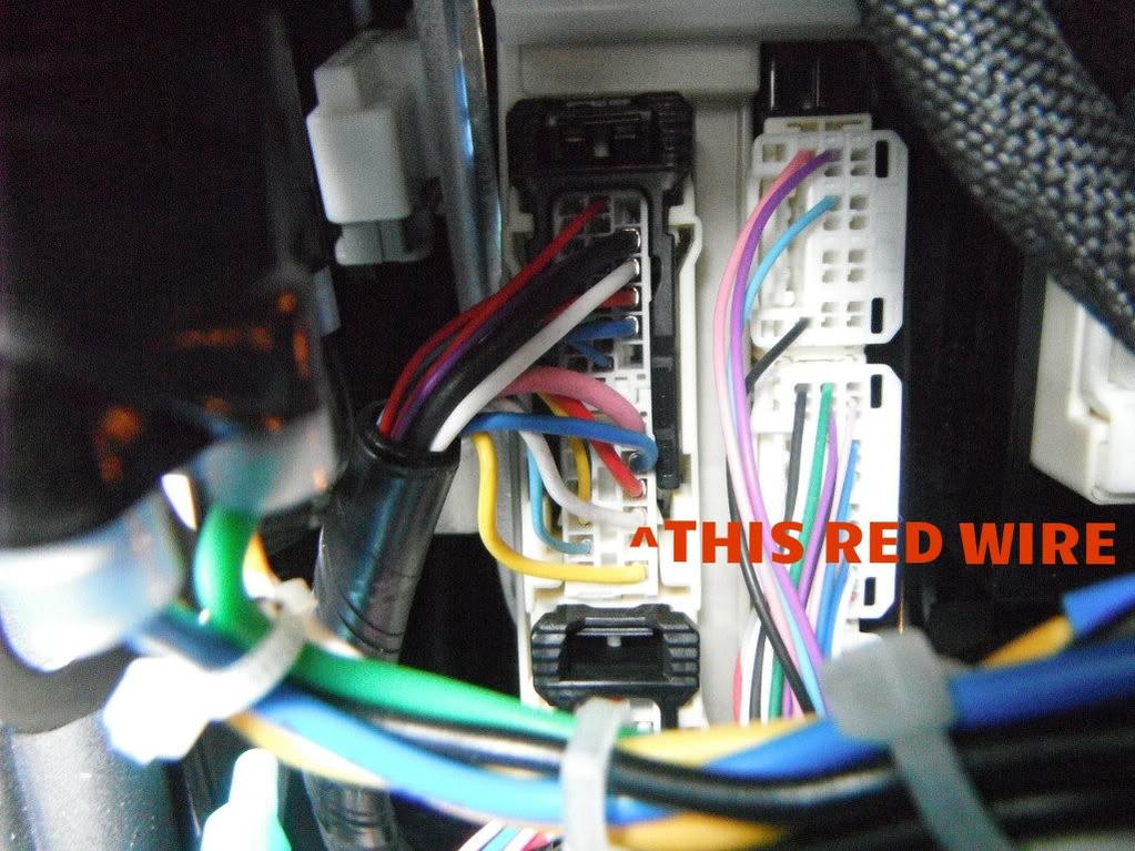

7) I tapped the reverse wire at the kick panel origin, photo provided
8) Labeled and ready to rock
The next post will show the difference. It is substantial!!!

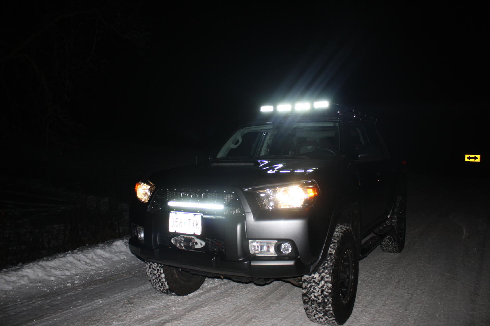

The final Product?
Before (Roof)
After (Roof)
Before (Side)
After (Side)
Before (Rear View)
After (Rear View)
I am loving the extra visibility and the potential for use camping. Lemme know if you have thoughts or questions.
