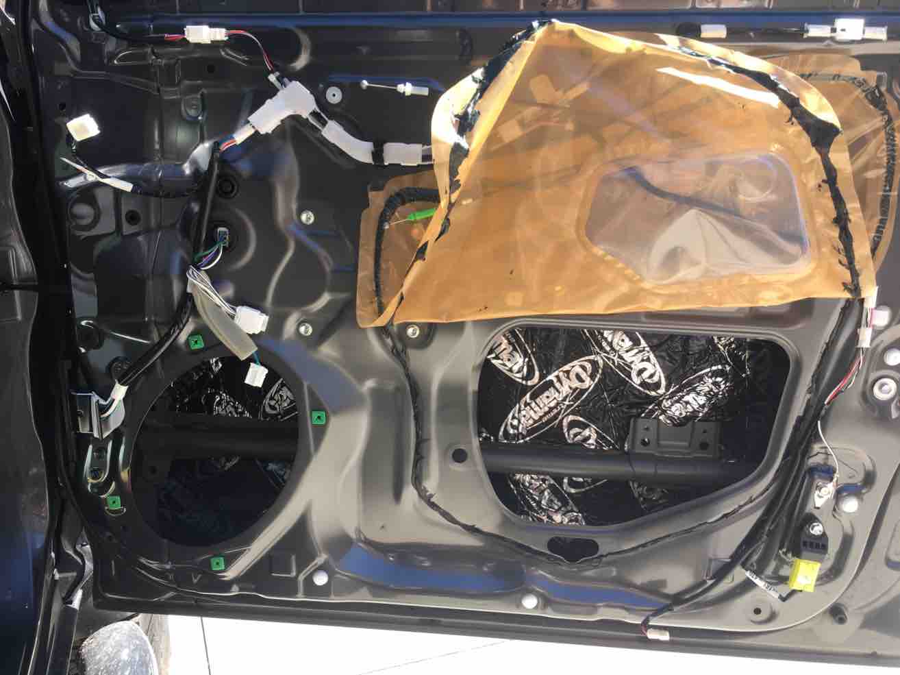

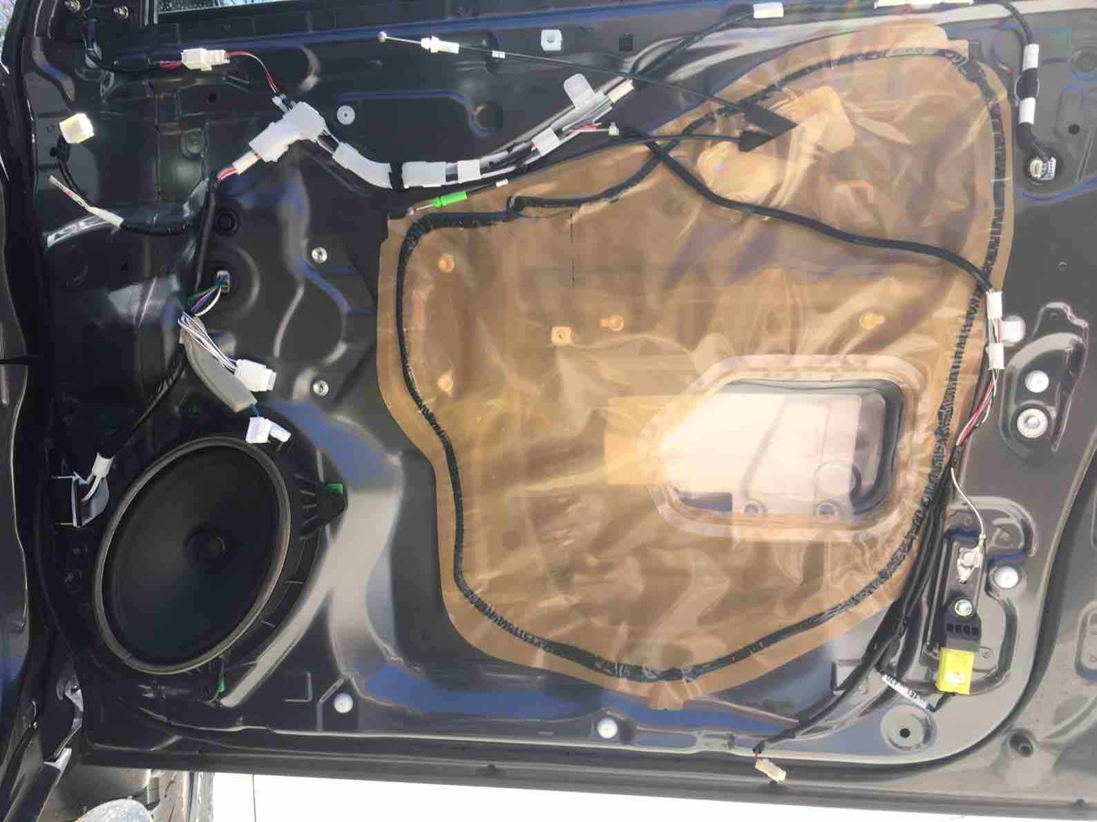

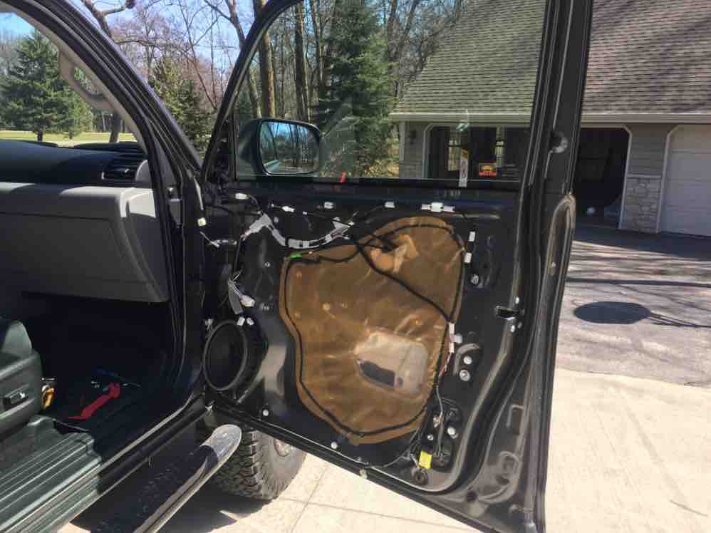

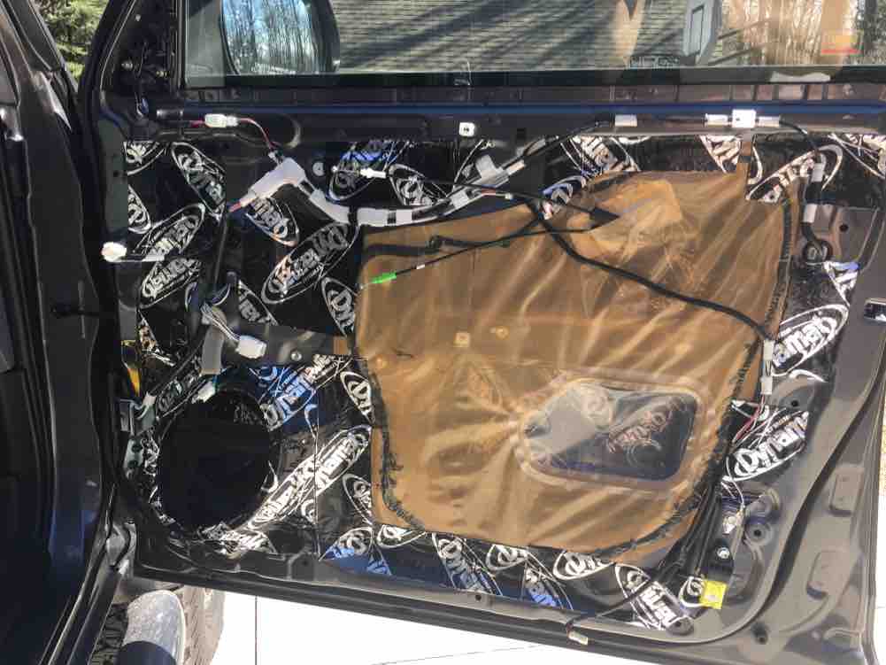

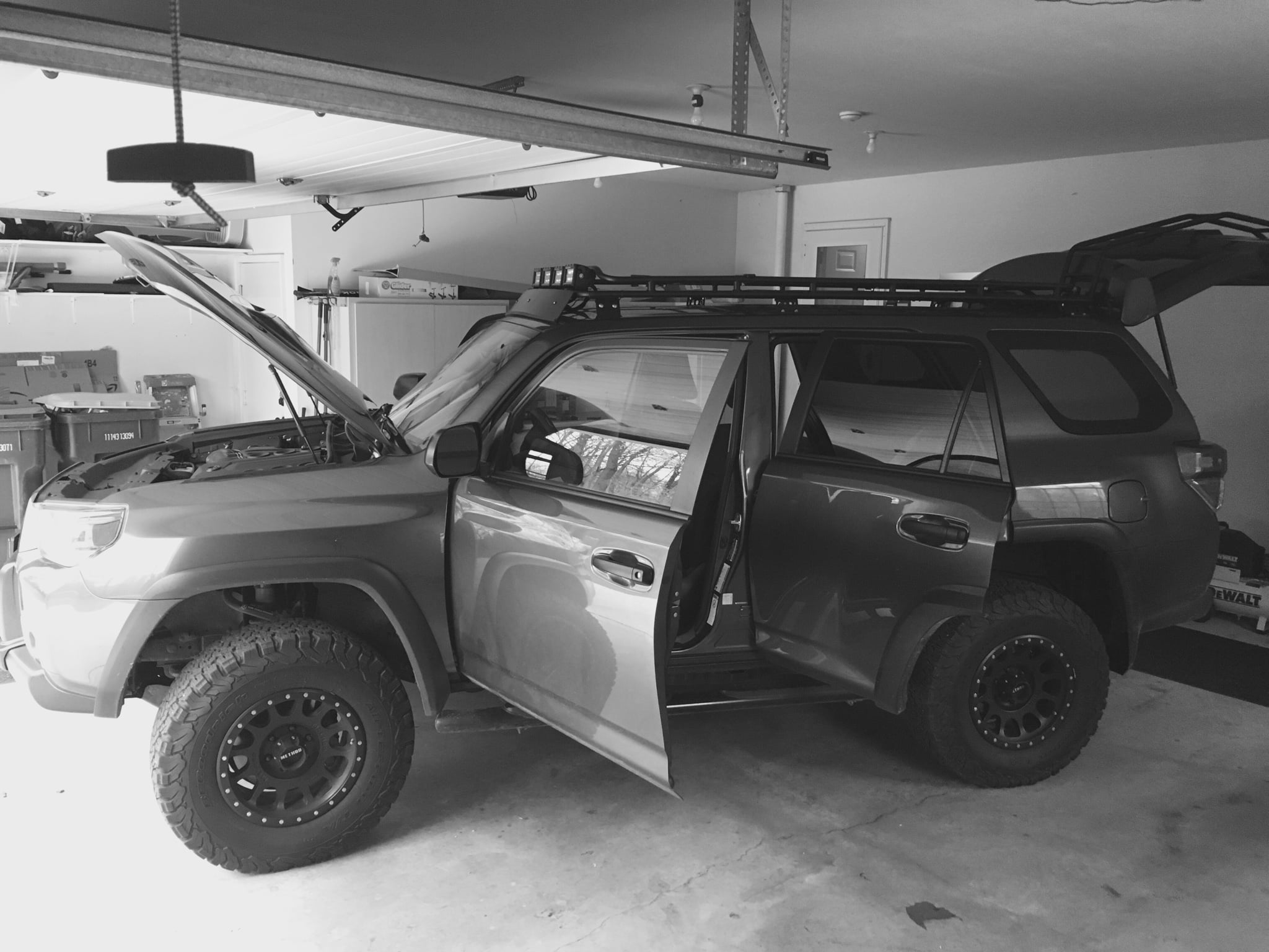

Remove trim: pry off sail piece (opposite rear view mirror, two clips), remove Phillips screws under handle screw cover/handle release/door pull( three). Pry up door from bottom to top (11 clips). Detach wiring harnesses behind handle and light at bottoms of door. Here it is.
You will see some plastic sheeting around the window access point, gentle pry up, it is attached with rubber adhesive.
Boom. Access. Clean with alcohol.

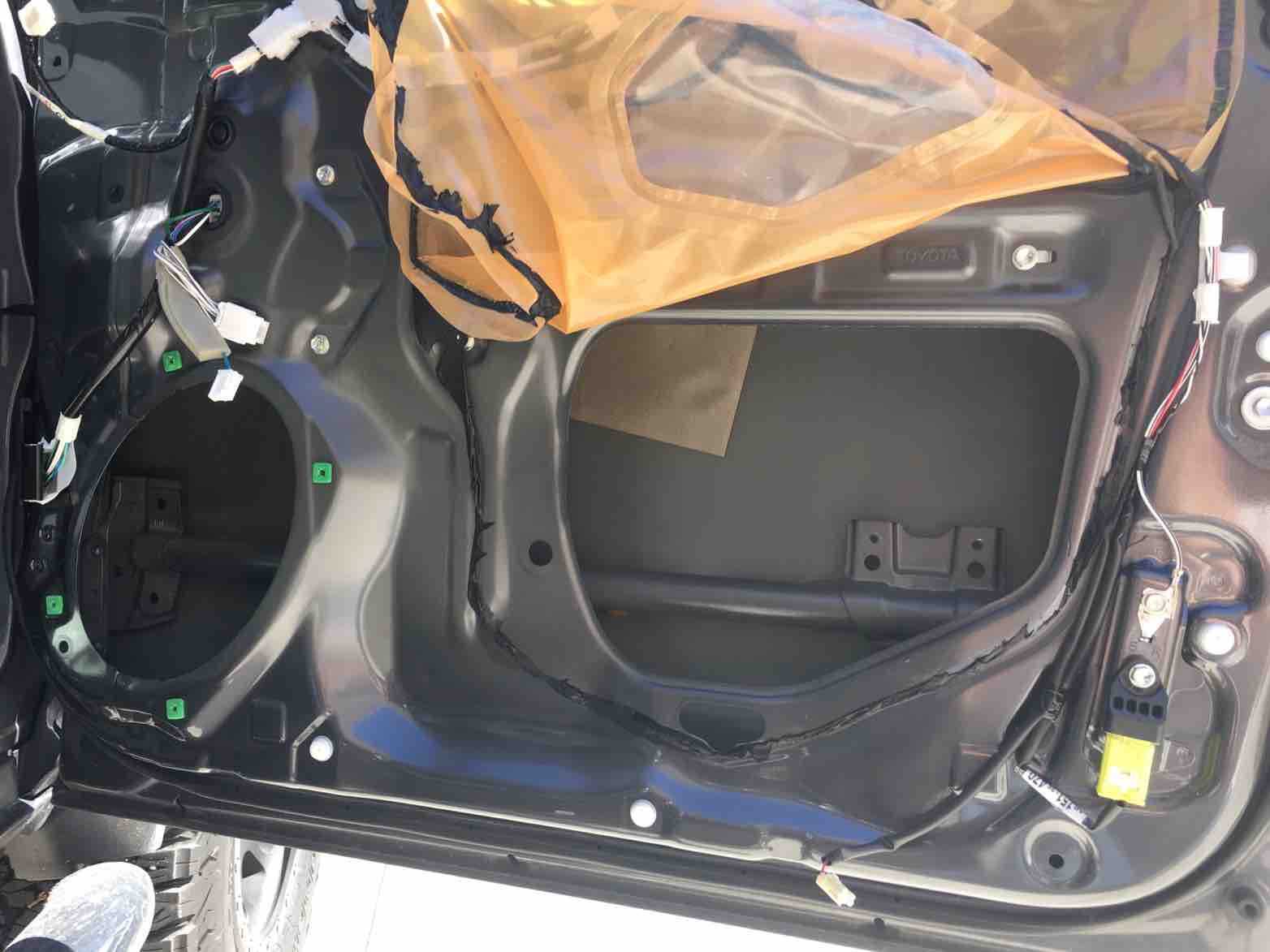

Roll on dynamat to outer door shell. Found it easier to feed it in through window access port, position, pull off wax backing and press to metal while advancing backing off. Stop periodically to roll down thoroughly with small roller. Outer door shell done
Inner door shell done. I didn't cover the plastic sheeting, though one could. I just worry about access to wires and windows if there should ever be an issue.
Insert speakers and reverse steps.

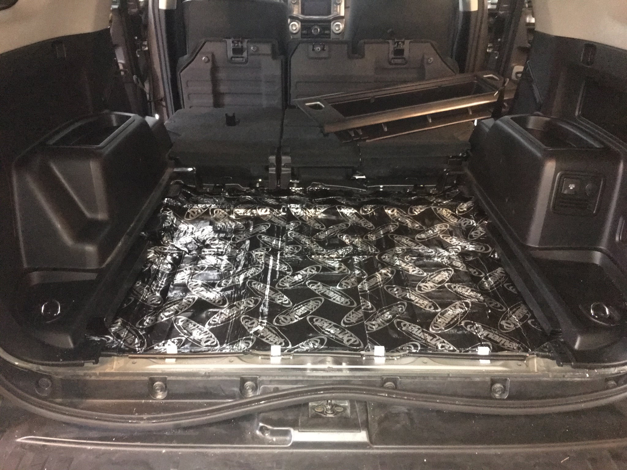

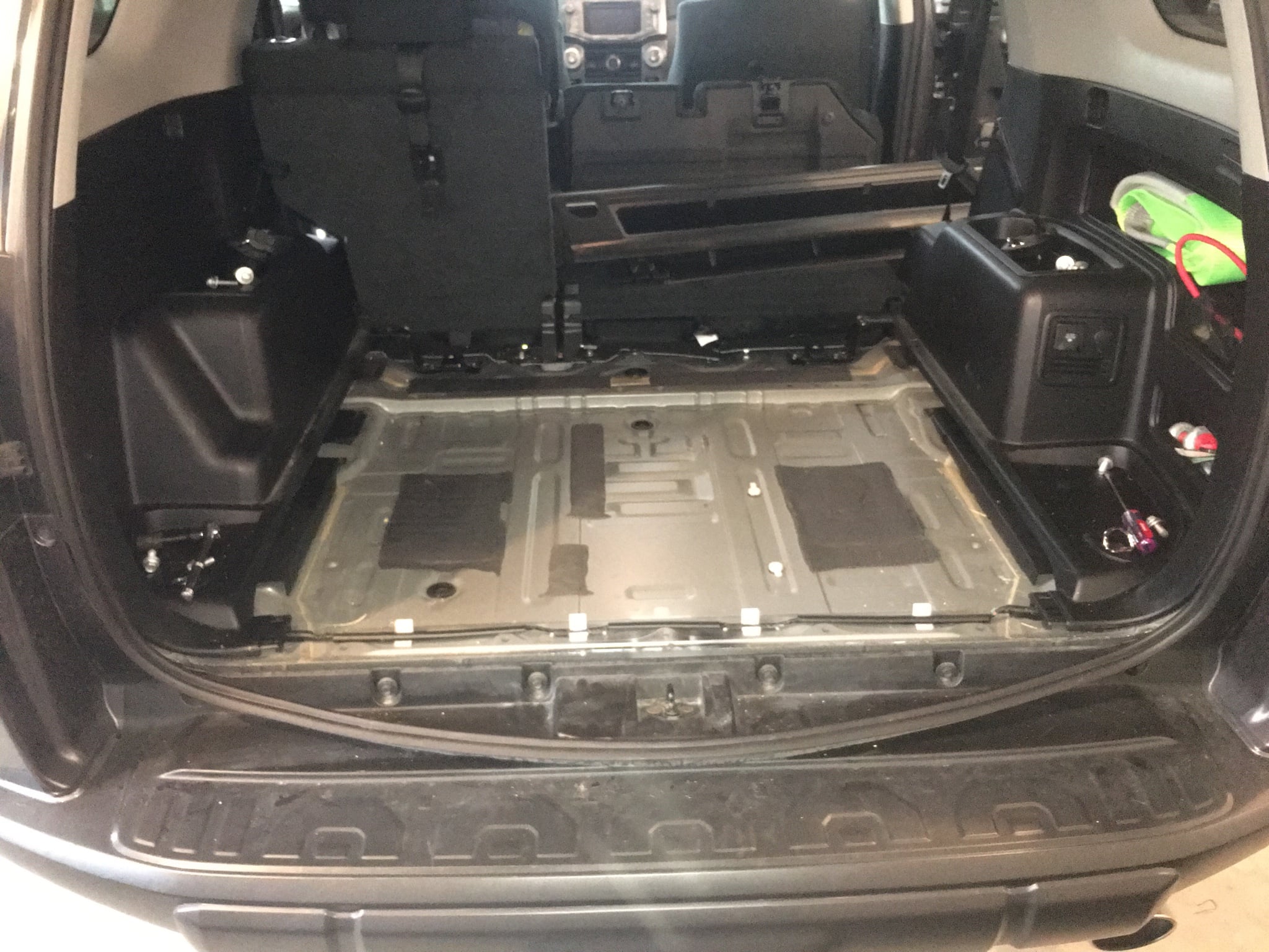

It is definitely still there but noticeably decreased. It doesn't ride like a Lexus just yet :) If I had to put a number to it, maybe a 30-40% reduction of road noise. Most of the continued noise is emanating from the floorboards, particularly around the wheel wells. I am pulling the carpet back and deadening these this week and will post an update.

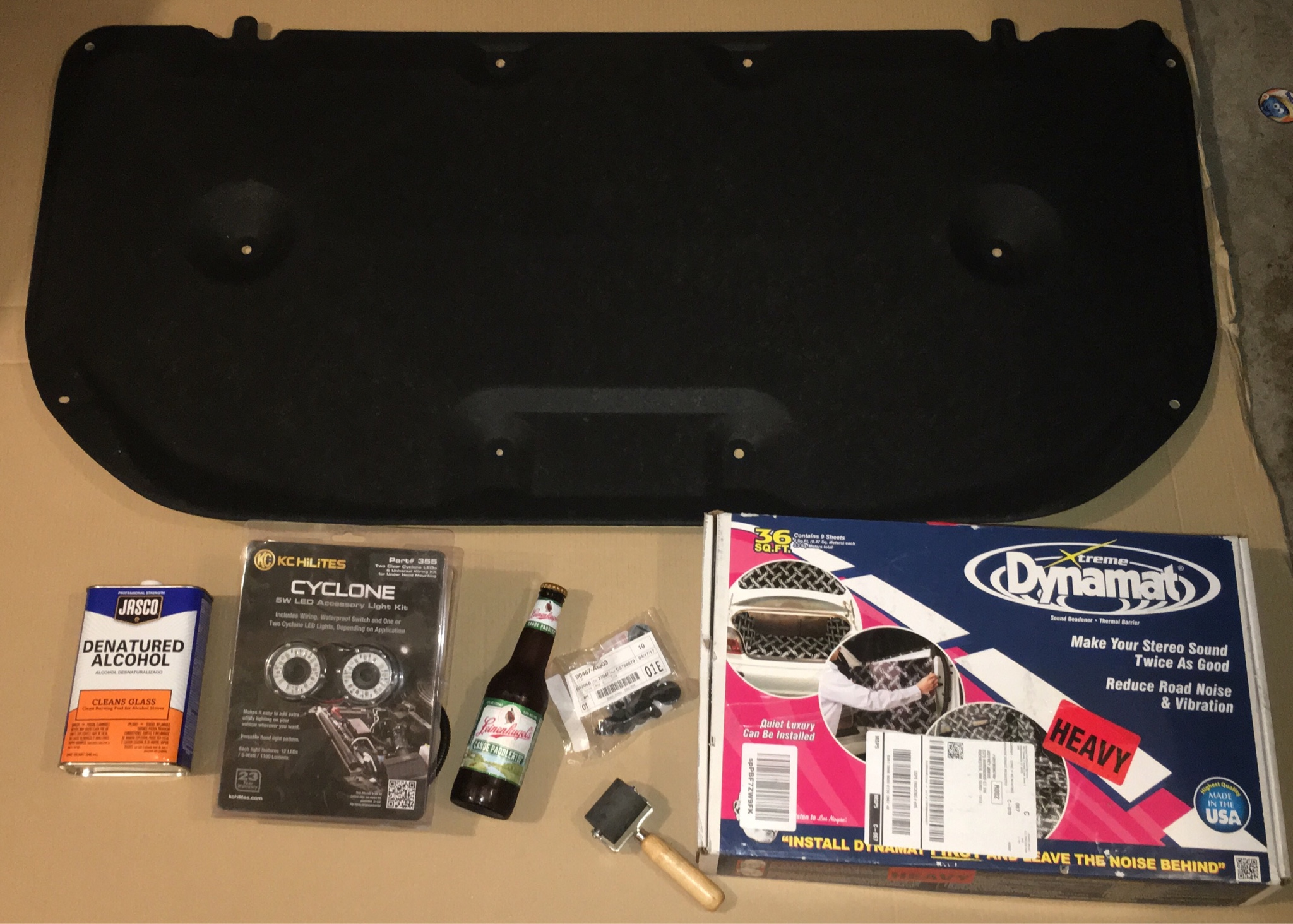

Prep- dynamat Xtreme kit (this is heat rated for under hood applications), denatured alcohol, beer, dynamat roller, KC underhood lighting kit #355, 4runner underhood insulator (stock, ordered from dealer), 10 clips (also from dealer).

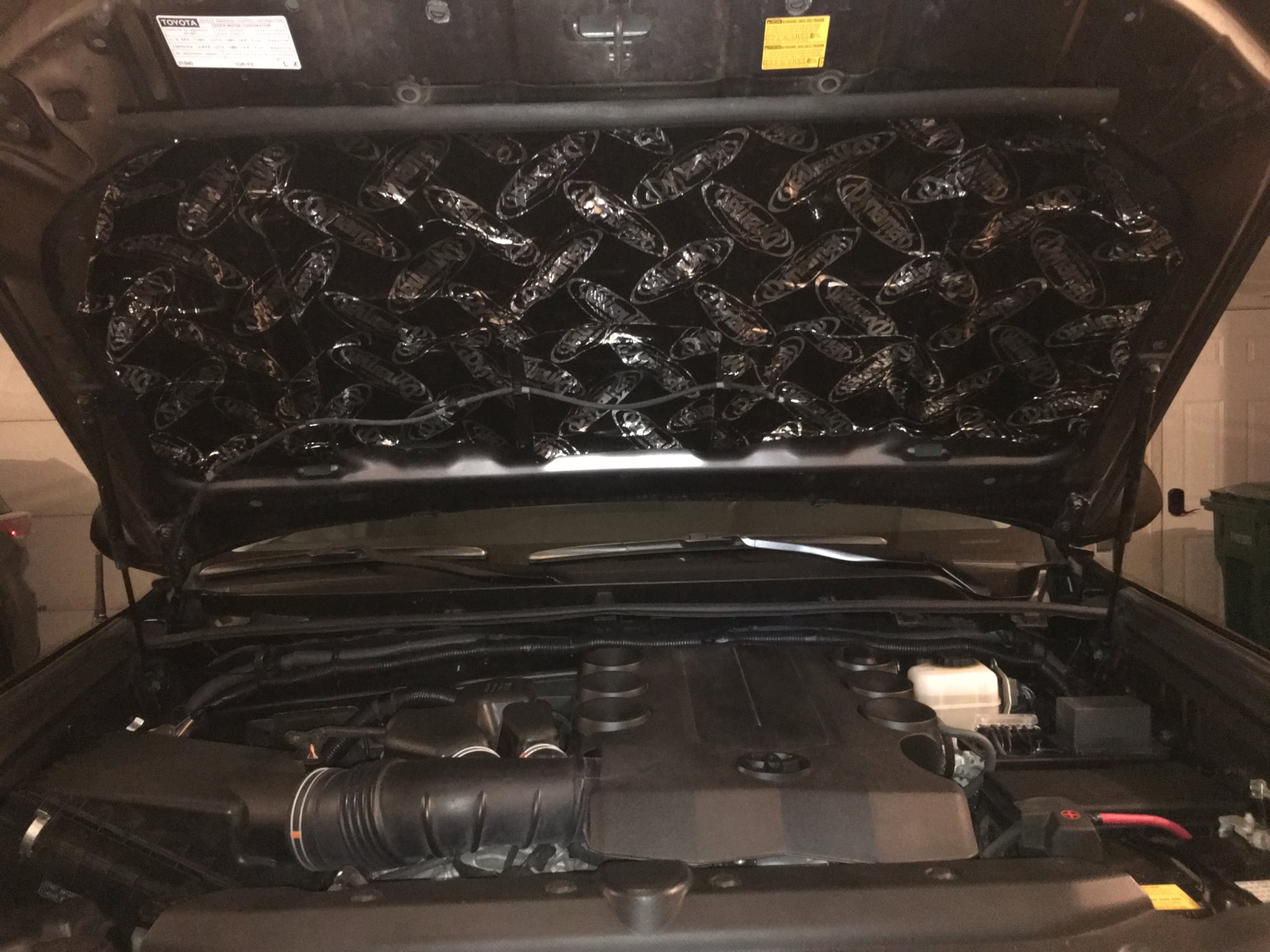

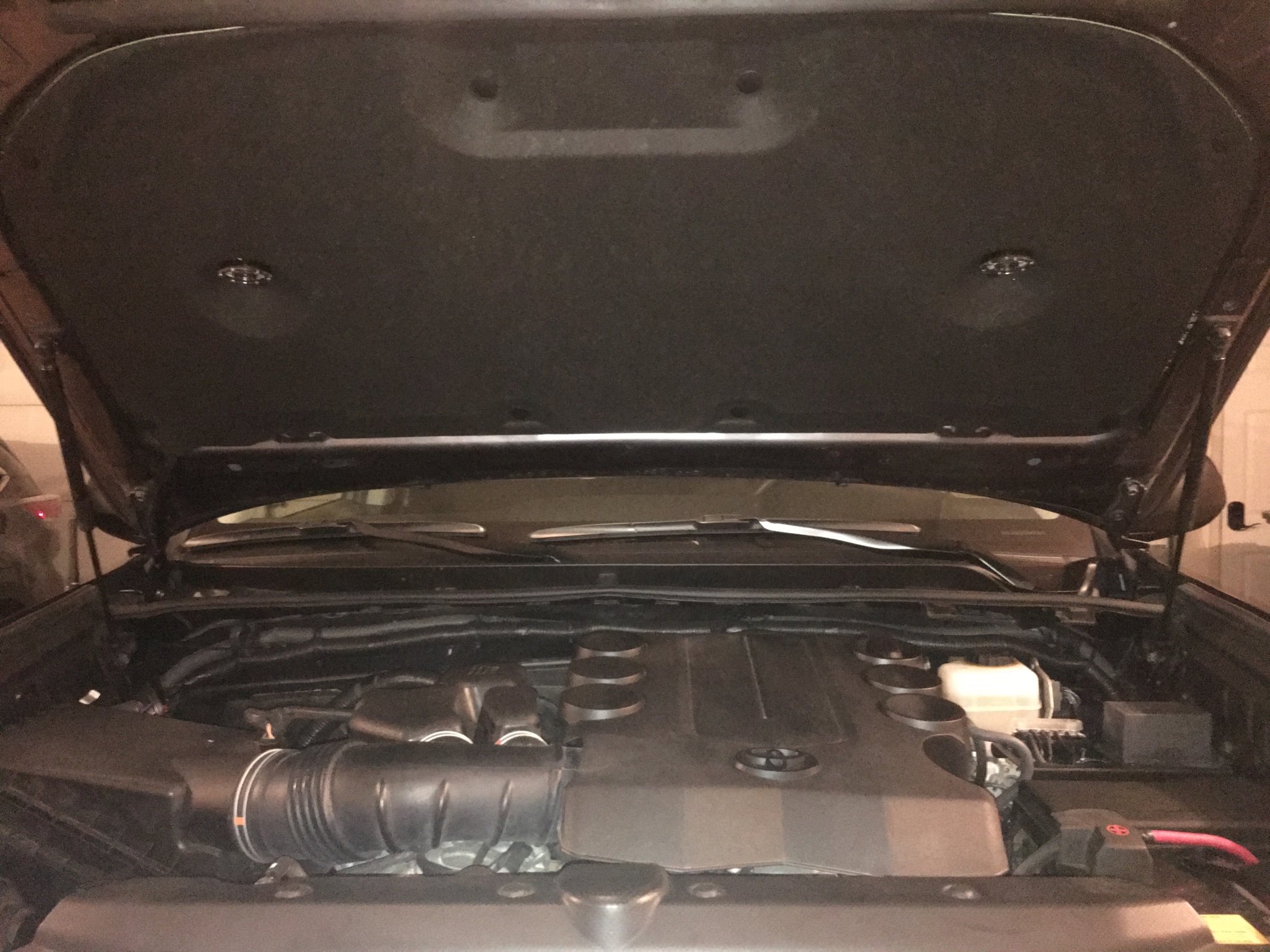

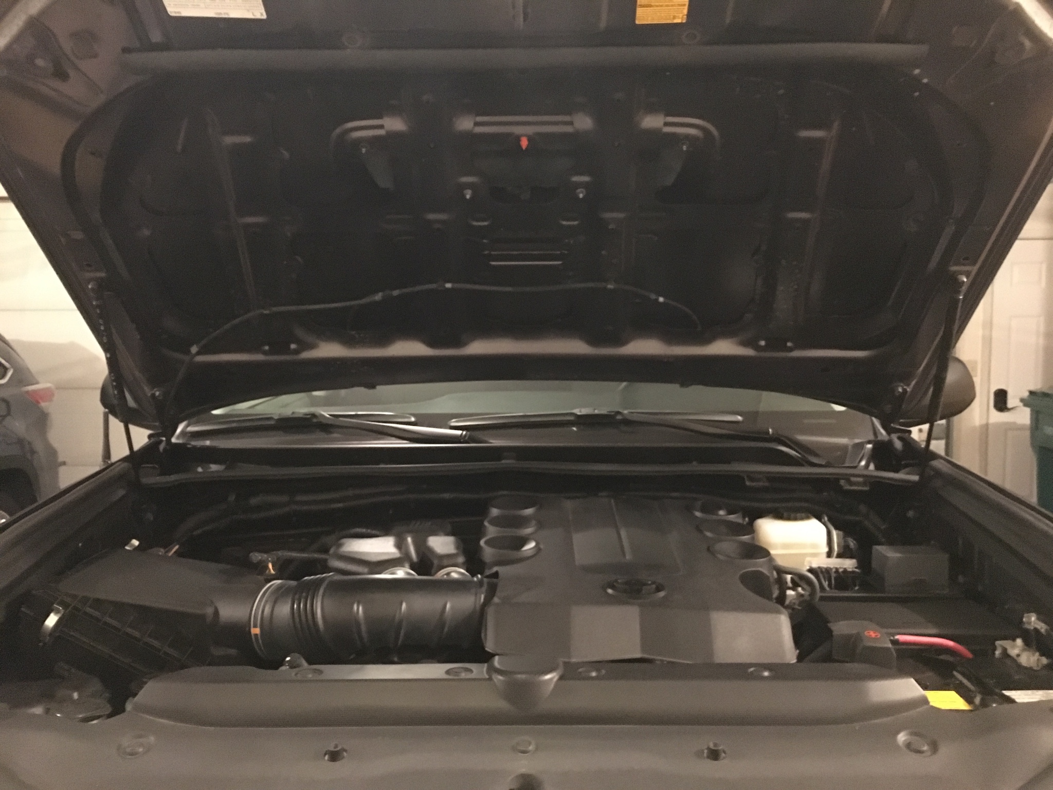

Here's what It looked like starting out. Rub down the underside of the hood with denatured alcohol to clean.

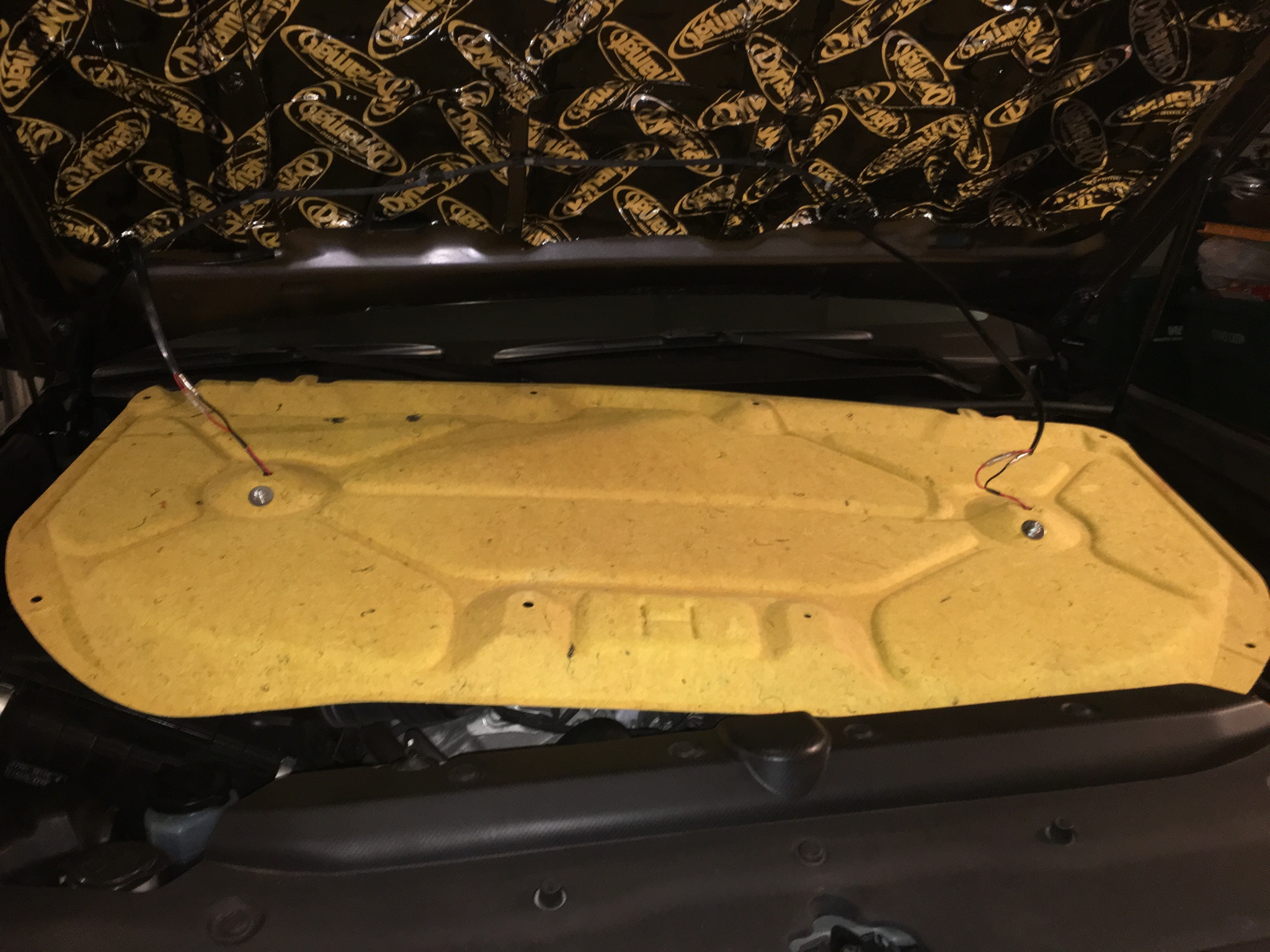

Apply dynamat to underside of hood in the area that will be covered by the insulator. Use the clip holes as a guide on the sides, the insulator phalange inserts in the back, and mark the front with a magic marker. If you go out past the insulator with the dynamat it will look sloppy.

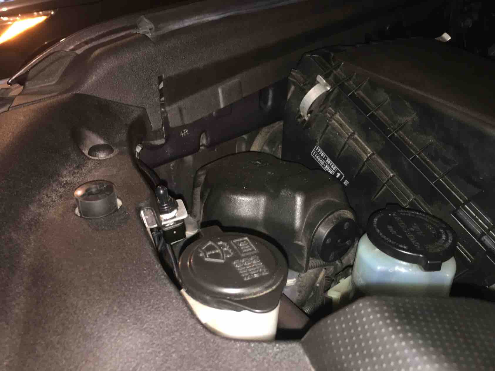

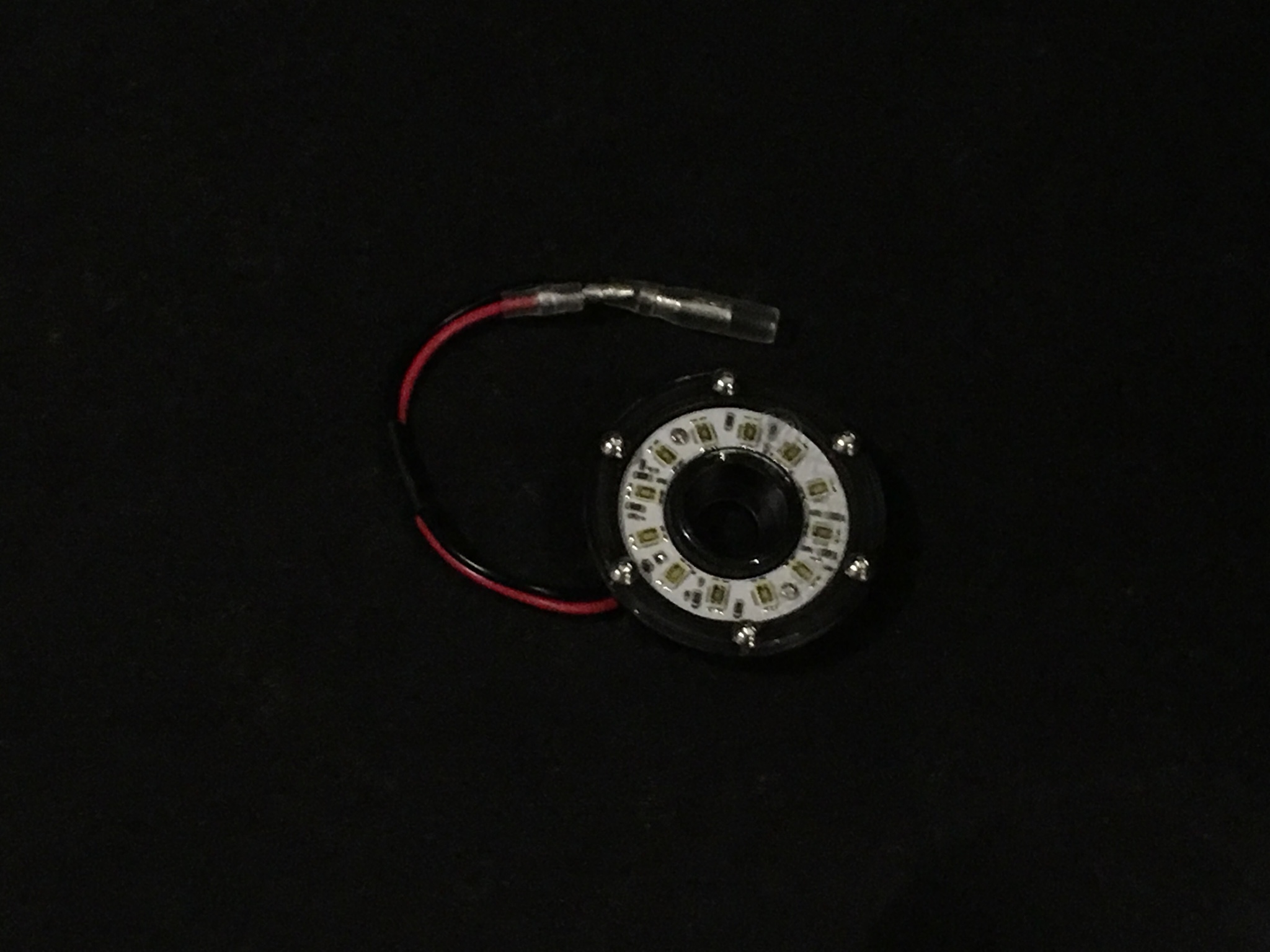

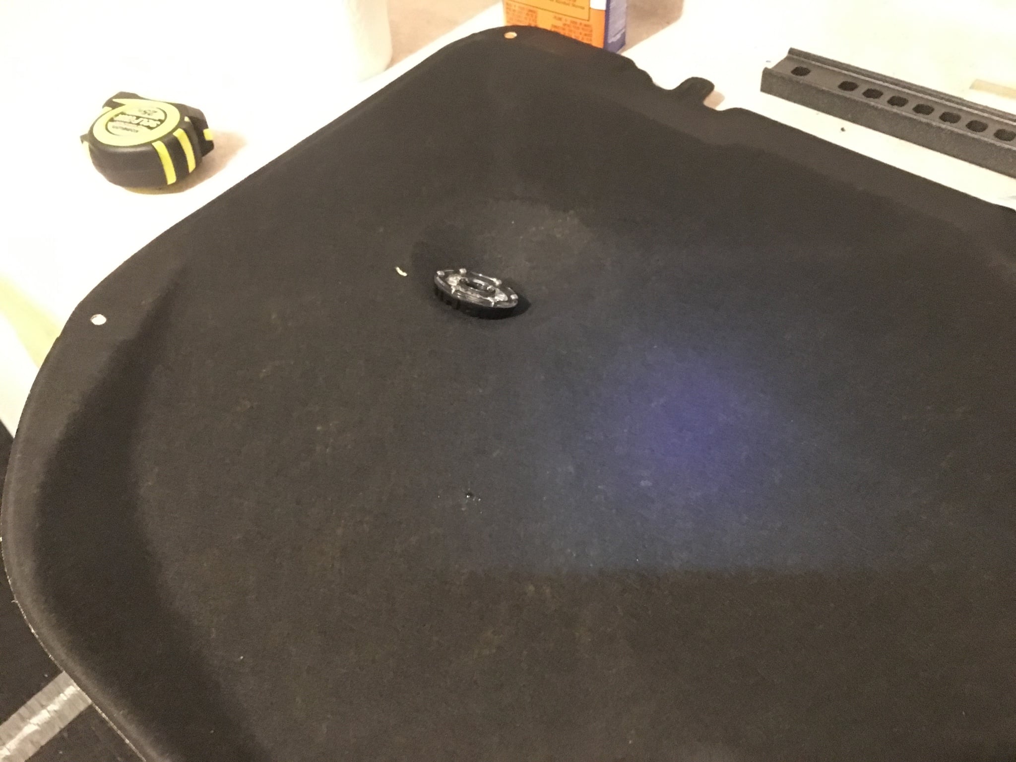

The KC lights are two ring shaped Lights with 12 LEDs each. The come with a wiring harness and a waterproof switch.

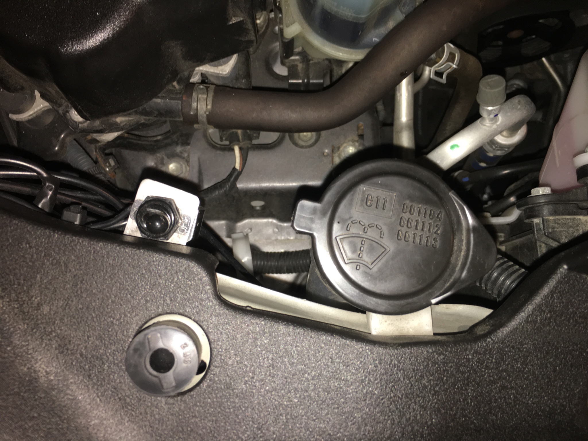

I mounted them on the upper aspect of the two concavities in the hood insulator, this will allow you to still apply the clips and keep the lights pointed down into the engine bay.
I ran the light wires through the clip holes and bolted the lights down. I then ran the wiring harness down with the washer fluid tubing.

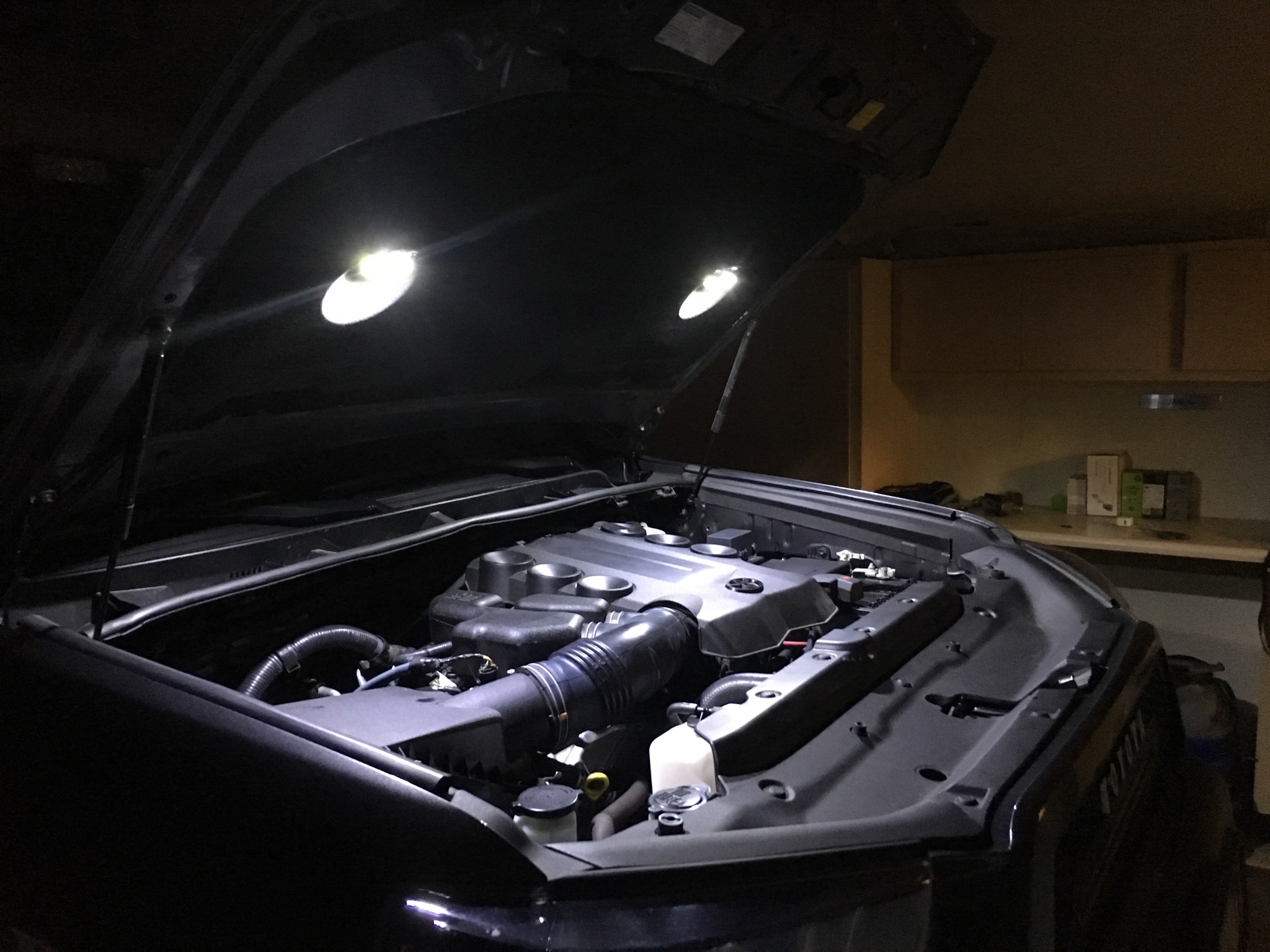

Here's what the underside of the hood looks like now.
Lights on!
