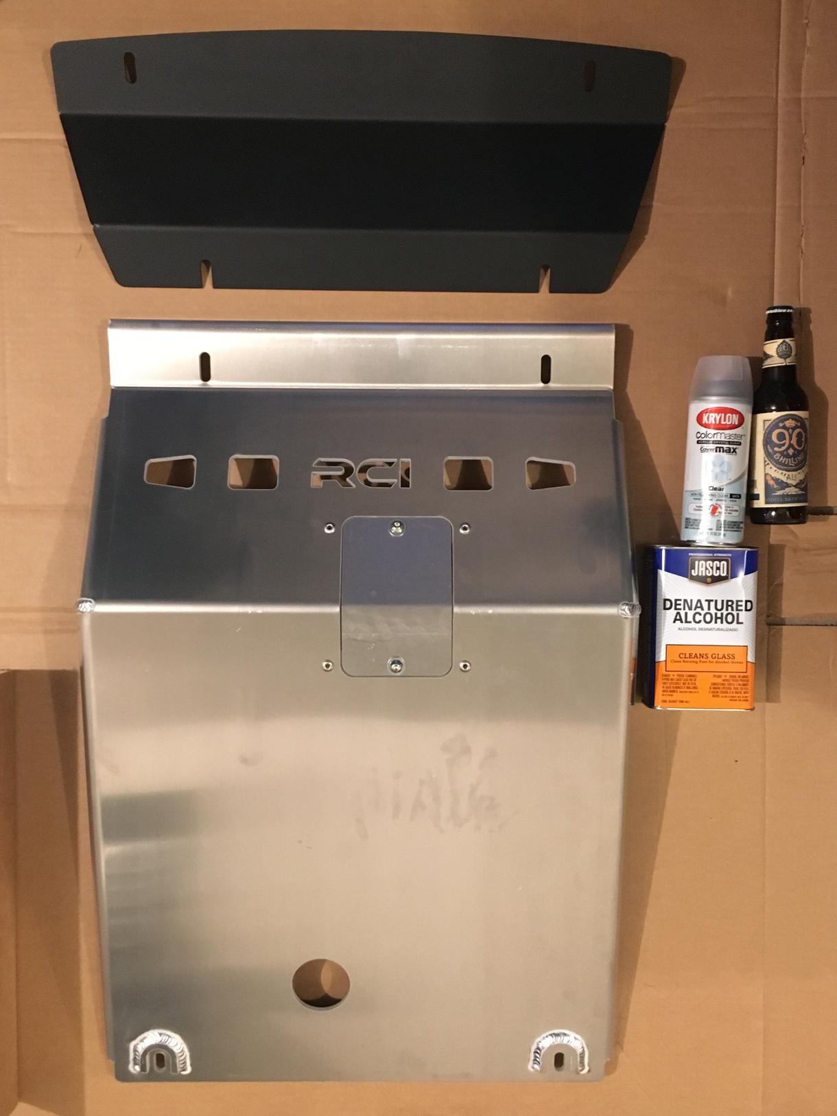

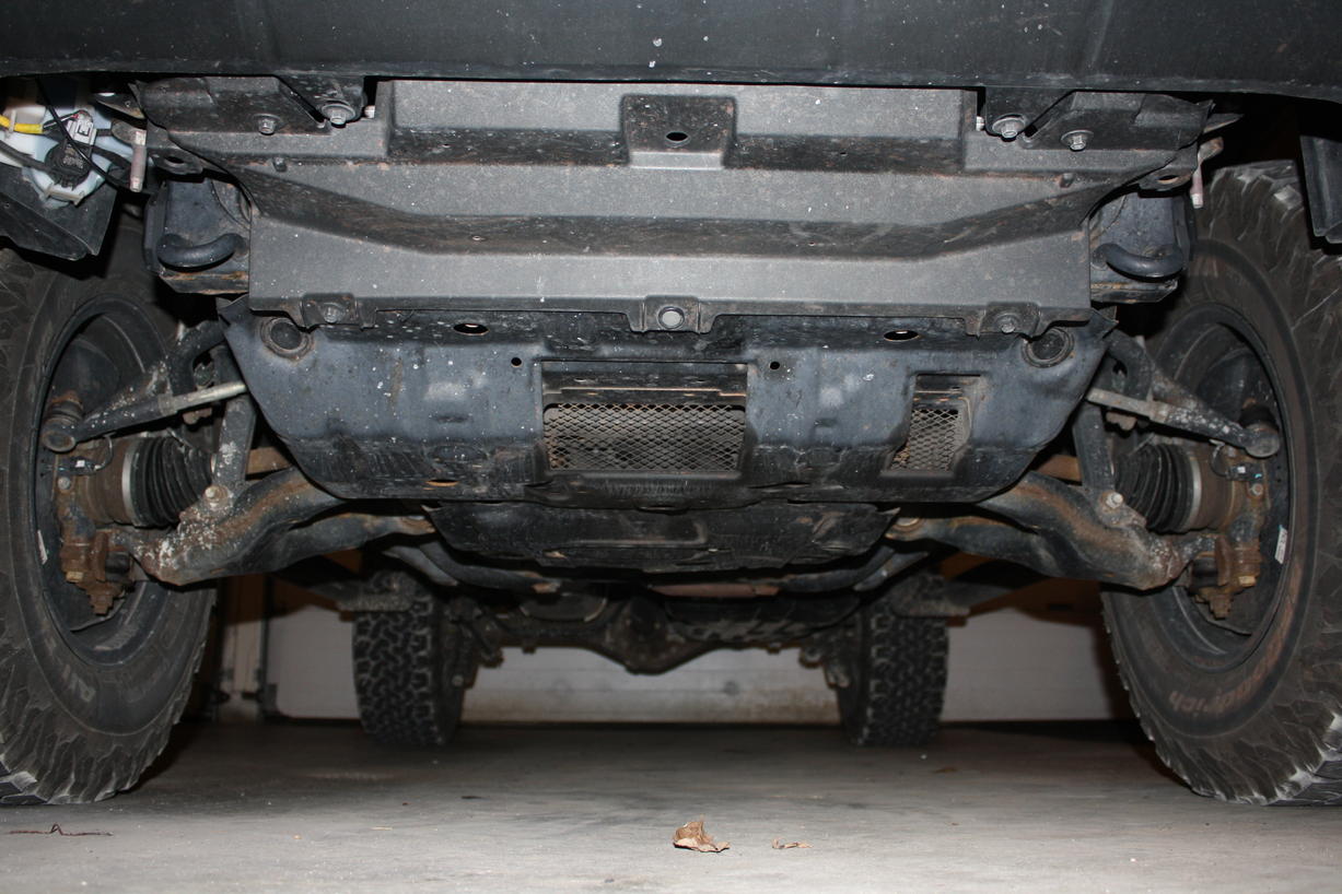

So I decided to get the RCI front skid and filler plate to see how they hold up for the next year of wheeling and harsh winters. The filler plate only comes in stainless and the front skid I selected in aluminum. I will complete the whole underside of the vehicle if they are durable.
Prep: Plate, denatured alcohol, clearcoat, beer, 8mm, 12mm, and 13mm socket wrenches. Take a look at the final post in the thread to see how much the clear coat changes the appearance of the plate (not at all). I put it on there to curb aluminum oxide formation over the harsh Minnesota winters.

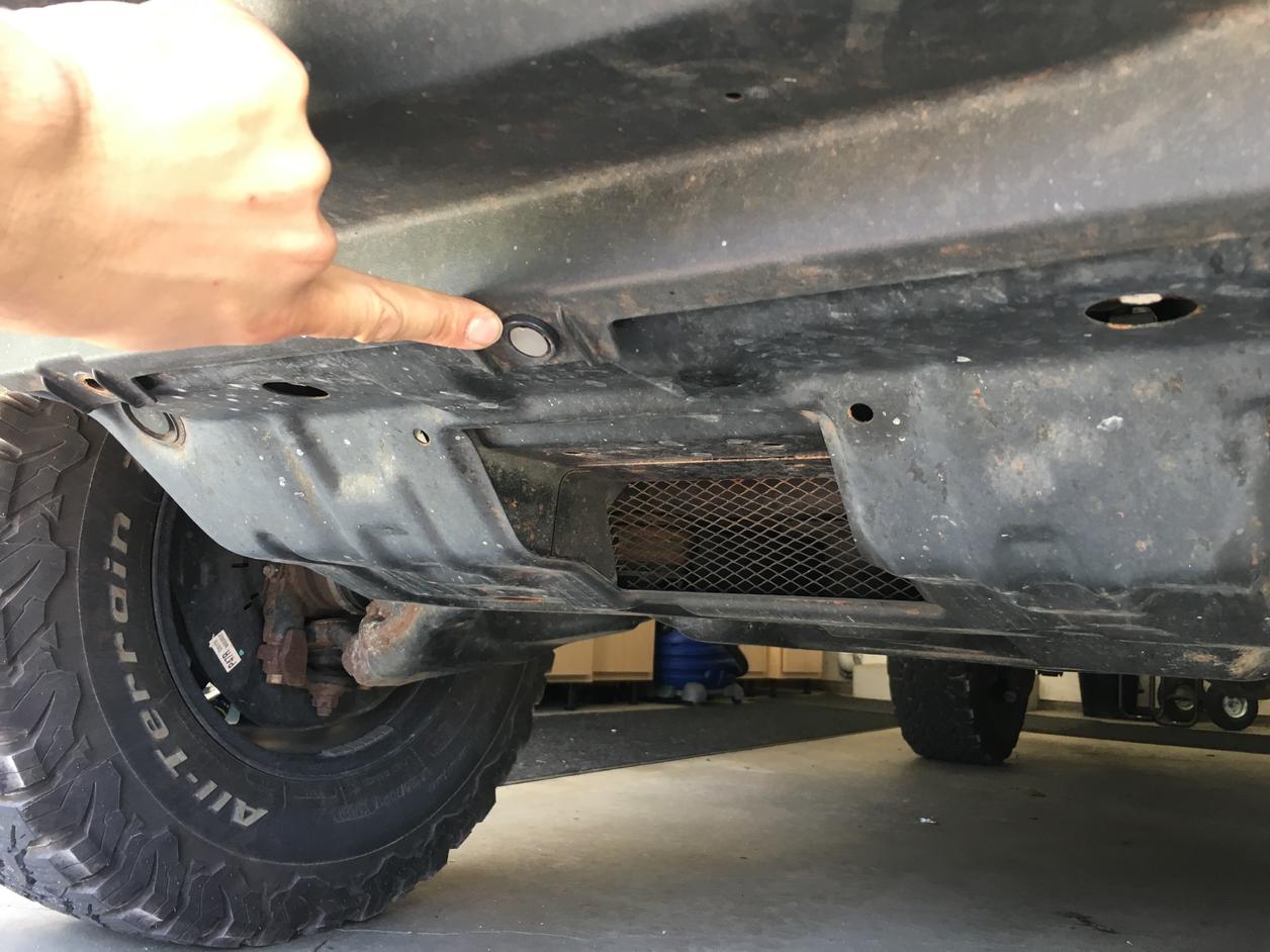

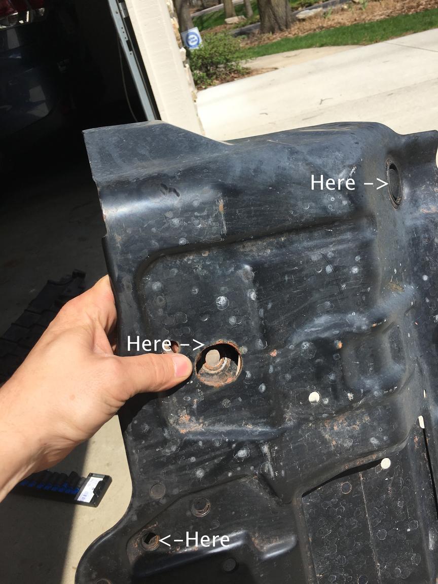

Let's start with the filler plate: remove four 8mm bolts (the two shown on each side) and pop one tab (shown):

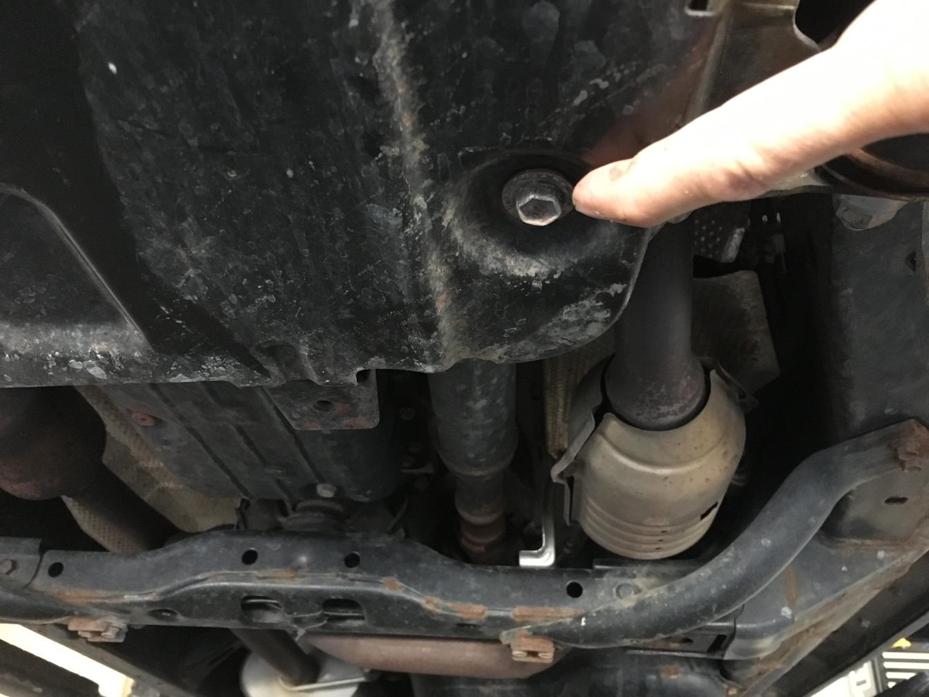

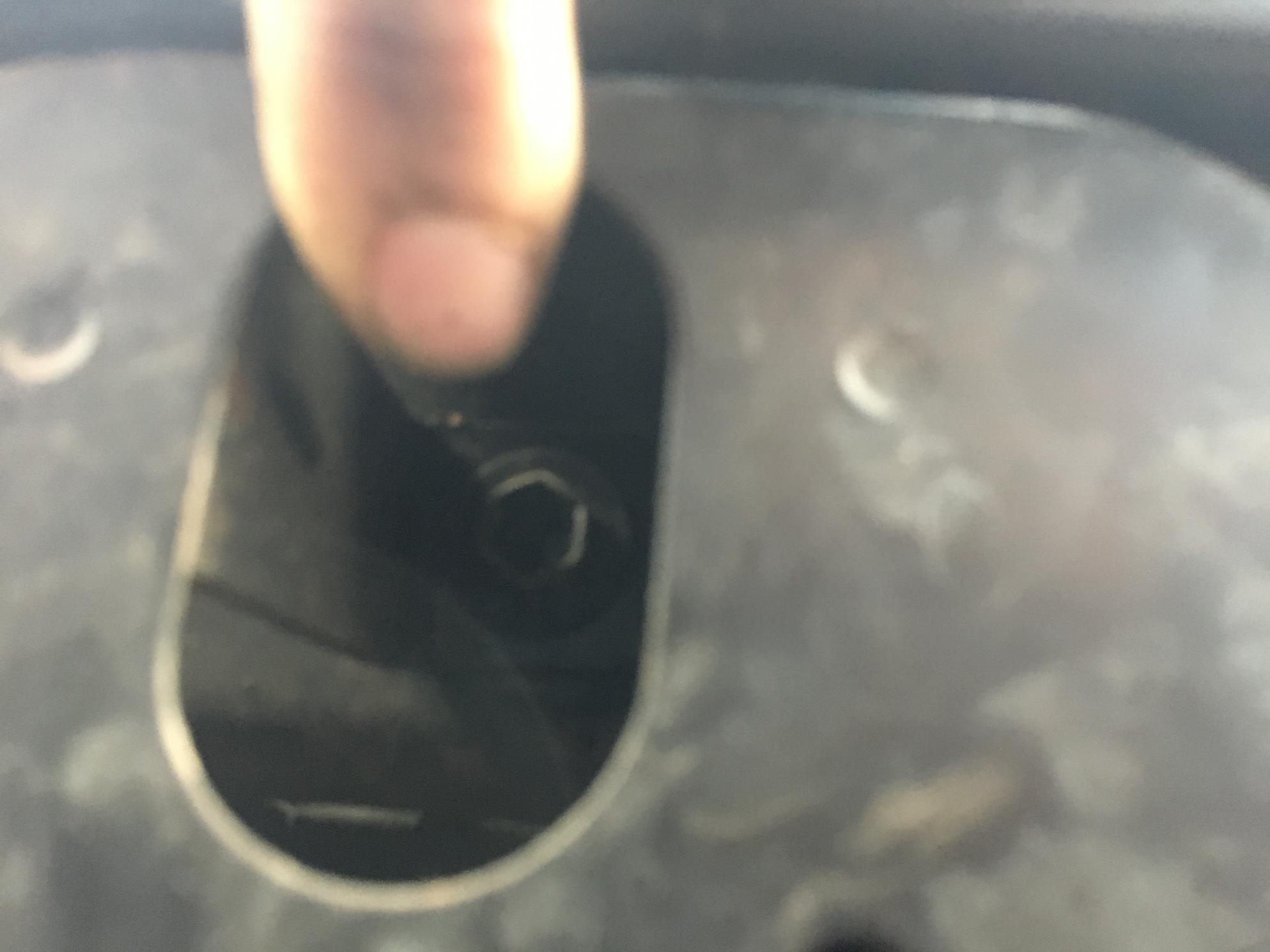

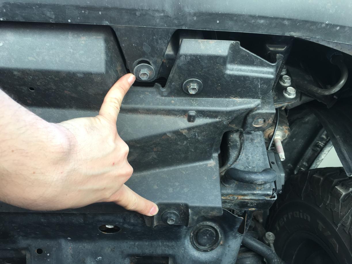

The stock filler pops off, you will see the radiator. Now remove the two 12mm bolts in the rear of the stock front skid (shown), then the two buried in these deeper recesses (shown). The stock front skid is two plates, the rear one will then slide back and drop off.
You then remove the 6 bolts on the front plate of the stock skid (shown). It will drop out

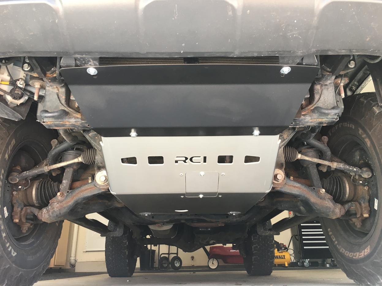

The attachment of the RCI plates is easy. 6 13mm bolts spanning two plates with 2 holes overlapping. Before and after:
