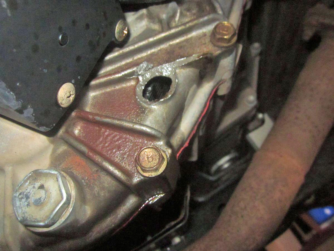

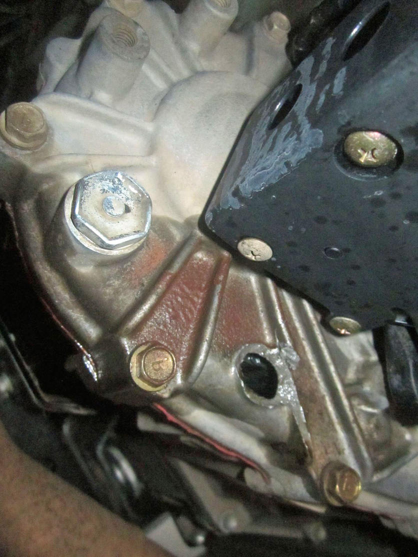

I got high centered last week in Moab and my skids made by a friend failed miserably. This is where one was bolted. Any suggestions on a fix? JB Weld seems to be the most frequently mentioned. Opinions/suggestions are welcome!

Remove them skids, JB weld and put the RCI's on. Component will be protected.
Look for a replacement cover in the mean time.
Edit... Hope you had a good time other than that.
JB Weld would be a limp-back-to-civilization fix only.
I would take the T-case out of the vehicle and install a new case half, or have the damaged one welded back together. That would require some Aluminum welding expertise.
Never bolt anything to the relatively fragile aluminum T-case. That was a very poor skid plate design.
The stock little skid plate on the T-case, would only stand up to very minor abuse.
Aftermarket skid plates should only bolt to the frame.
I wouldn't consider JB Weld a permanent fix either. It might hold forever, or it might decide to give up at the worst possible time and leave you stranded again. I'd get a junkyard case and swap it out. Keep your old one for parts. Unless you have a friend that's good with welding aluminum, a repair of your existing case is probably not cost effective?

I had to pull the lousy skid off to find the leak and got to it today. It wasn't hard to find.

I agree with the poor design now! Besides doing the damage shown a weld on the opposite corner mount also broke.
I'm in agreement on the cost effectiveness of getting it welded being unlikely. I am waiting to hear from a friend that might be able to do it.
I'm not convinced JB Weld wouldn't hold though. I have the RCI skids that will be on after fixing this and see no real need for the little protector that bolts on there. Without anything mounted to it what would stress the repair?
Vibration. Thermal expansion and contraction. Freezy water. Time.

Yeah that seems like a MAJOR design failure with predictable results.
Is this common on other designs or just the one your buddy made?

That sucks Chris. I would try to find a used one or I wonder if that can be welded?
Yeah, it sucks but such is life. I'll find a used one but am going to patch it until I can replace it.

Just mine that I know of, hopefully this can serve as an alert for anyone else whose are mounted where they shouldn't be. I ran it for years without any issues but look forward to getting my RCI's installed.

Just about done with this topic but have one more question. Can anyone tell me which year 4Runners have a t-case that I could use with my 2005 V8?

Without being where I can look up compatibility, I'd say a full-time 4wd T-case W/Torsen diff from '03-'09 should work.

I'm about 90% positive that the T-Cases are the same for all years dependant on the engine.
You'll want to remove that factory plate anyway. It will sit to close to the RCI plate after installed.
I was getting a vibration/drone sound when I left mine on.
