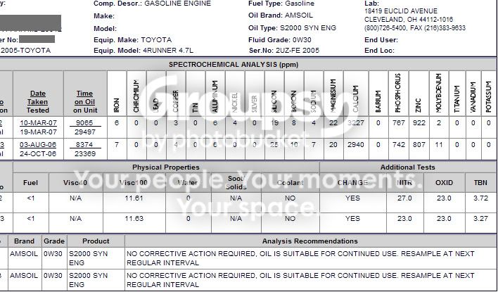

Color does not mean anything. I think Mobil 1 will come out dark out of any vehicle. I used it in my V6 Acura, it came out dark. Get an analysis if you are worried.
