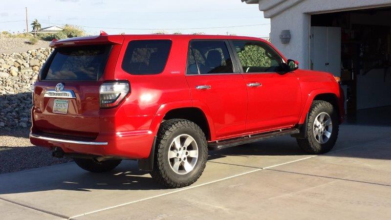

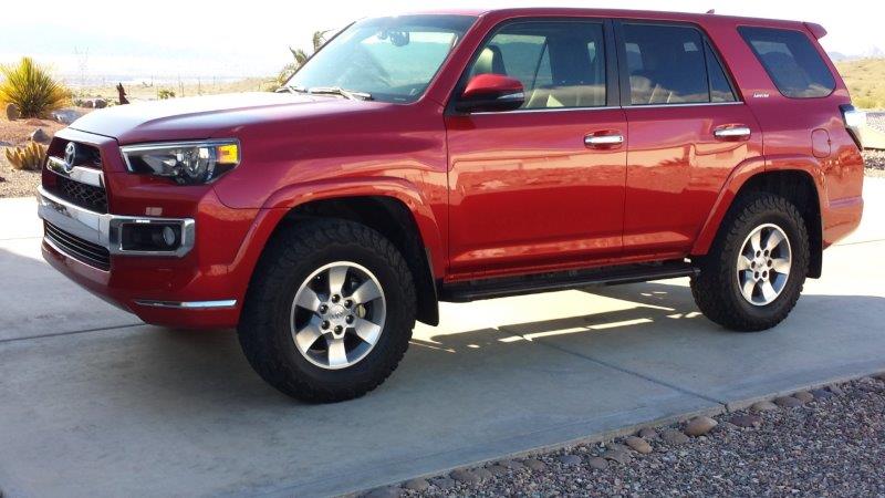

I modified mine shortly after I got it. I trimmed the back bumper to eliminate the part with the black inserts in it. On the front I removed the big cover that connects the front bumper to the skid plate and trimmed off all the black trim below the vehicle color section. You will have to make a few simple brackets to support the bumper and be willing to do none reversible cutting but it was useless to me the way it came the factory. I also removed the limited side panels to make it like an SR5 or trail.

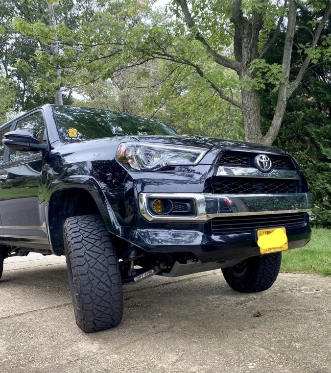

i've trimmed my stock bumper to improve clearance (started above the small standalone chrome pieces on each side then cut to where that chrome ends before turning down to follow the contour of the bumper. i then cut out all of the plastic aero. my cut is about flush with where my front license plate hangs), but the key issue with the limited is that the aluminum crash bar is significantly wider than on the other trims. I wouldve trimmed more on mine but this wouldve been super exposed and looked wrong. I imagine this will get in the way of dom tubing or any of the low profile winch bumpers

Hopefully these pictures load ok. My wife tried to figure it out for me how to load pictures. There must be an easier way.
There is also a picture of the rear so you can see what I trimmed off the bottom of the bumper.

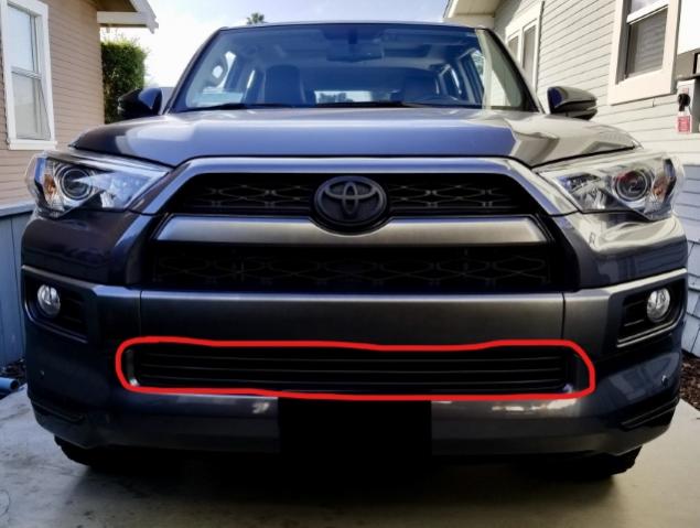

Has anyone sourced a grill insert or modified that lower grill? It's probably my least favorite part of it...

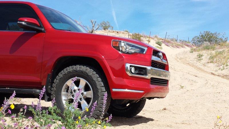

I guess you could cut it a bit higher if you wanted to lose the parking sensors but I did not

Thanks all. What I'm seeing on here is basically the same that others have done so that's confirmation enough. Love the rig pics!
