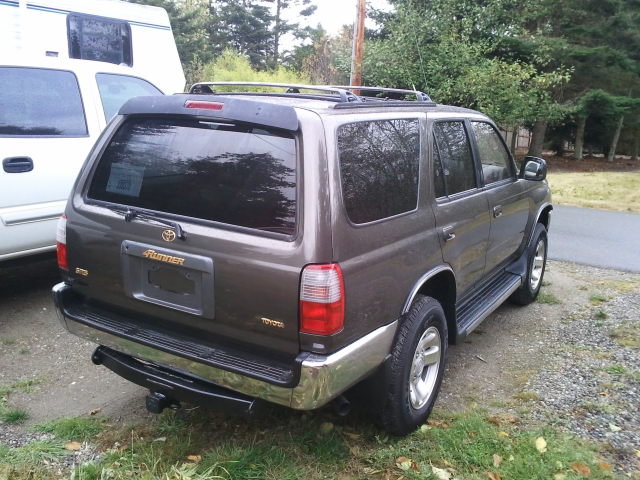

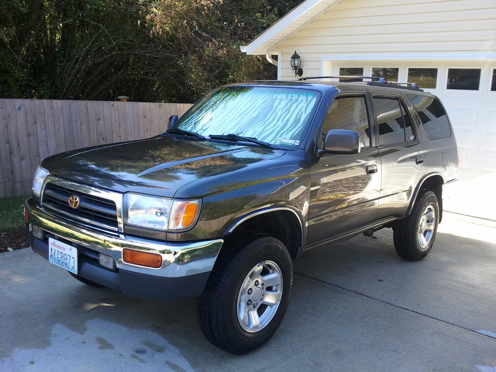

Well ladys and gents, the build is starting. Picked it up in Nov '12 with 160k. Super clean, imo.

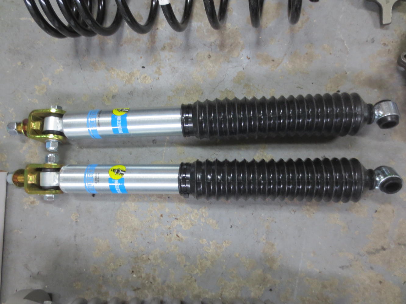

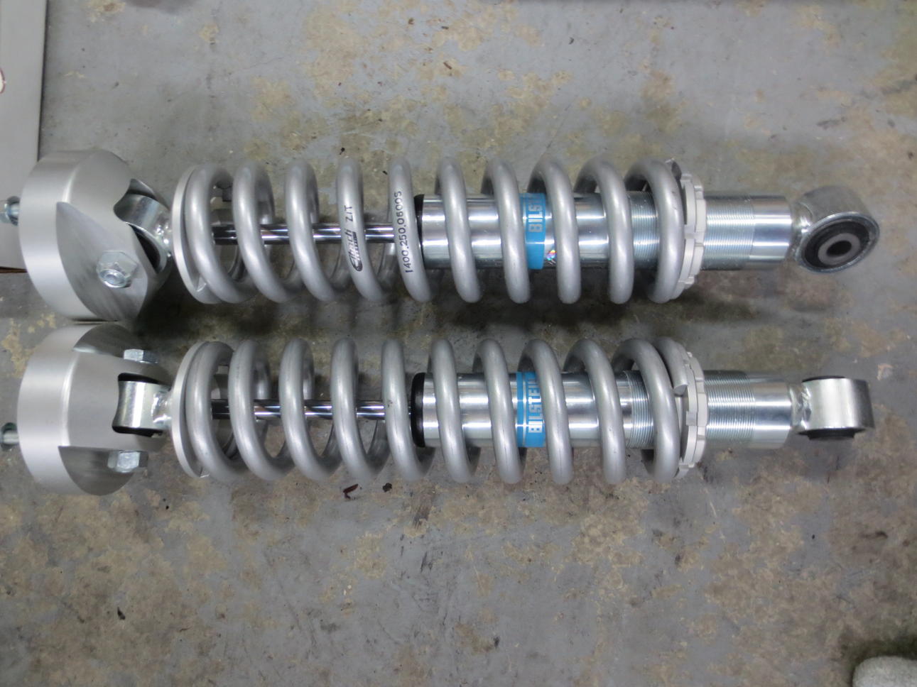

Toyotec Ultimate lift
OME 890

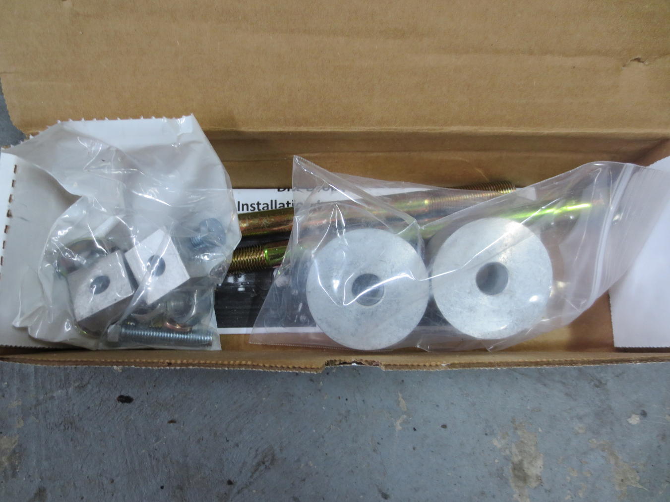

1" Diff drop (toyotec)

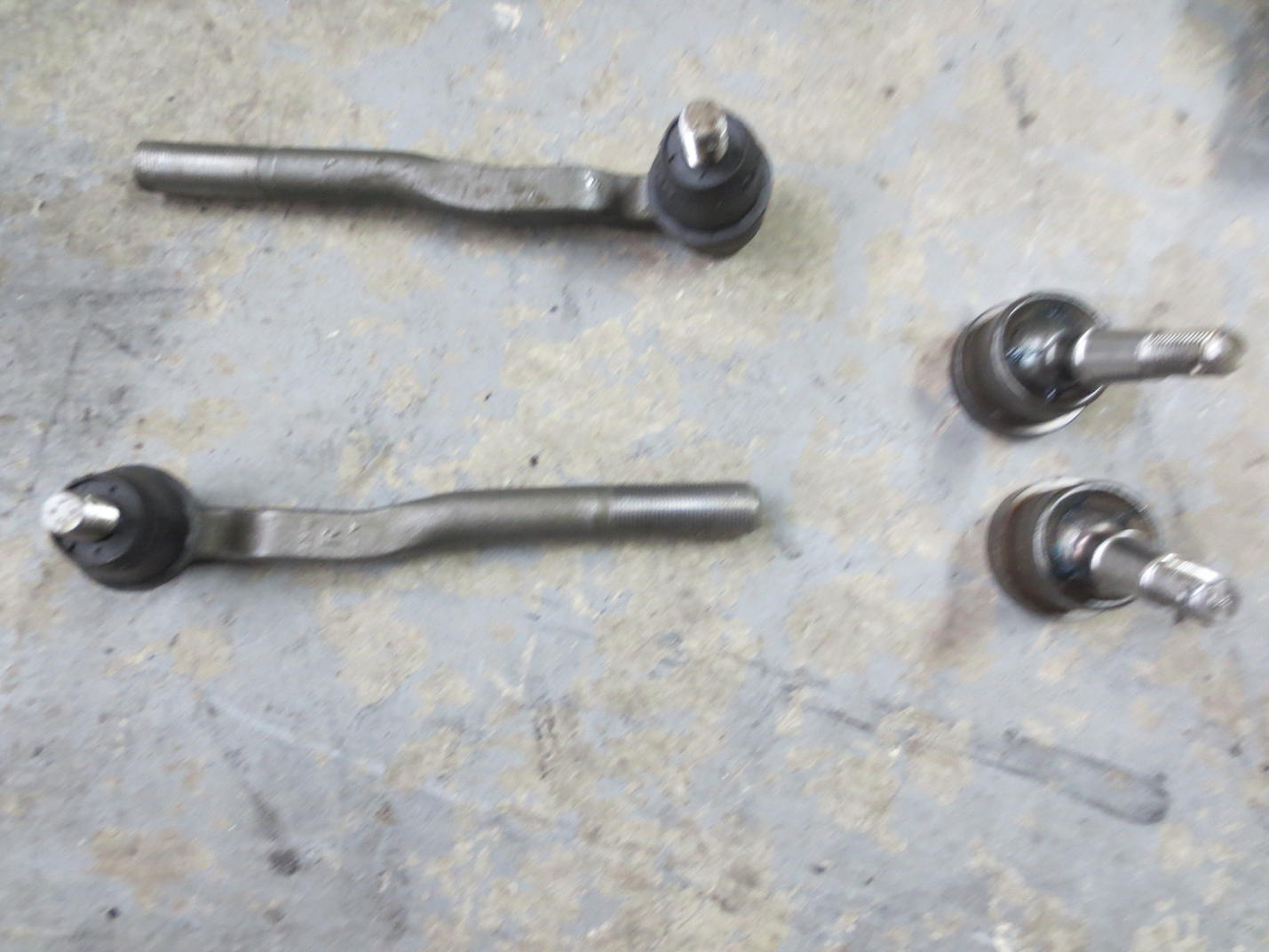

UBJ/LBJ and ITR/OTR(Moog)

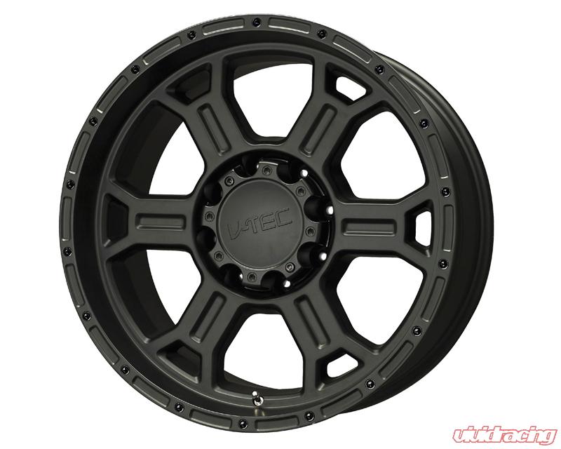

16"x8" V-Tec Matte Black Raptor w/ 285/75r16 Duratracs

Not sure if it's on my end, but all the attachments are coming up unavailable. I want to see it!
Thanks for fixing. Always liked that color on the 4runner.
I'm looking forward to seeing what she looks like with her new wheels on. Keep us posted!

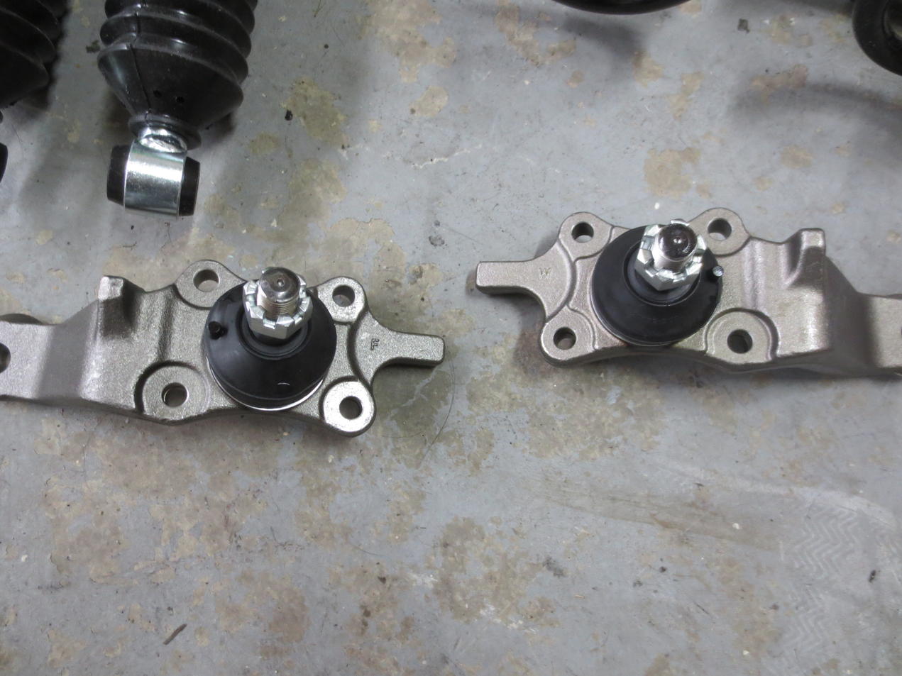

Are you doing the inner and outer tie rods just for peace of mind or were they worn?
Sorry to thread jack but LBJ and both inner and outer tie rods are on my list... Just wondering at what point I should change the tie rods (how do you assess the wear?)
ShouldBe- Just doing them for the peace of mine. Giving the runner the love so it will take care of the wife and kid.
Good call.
I've got an extra steering rack... I wonder if it would be easier to swap the whole thing (and add outer tie rods) as opposed to servicing the current rack...

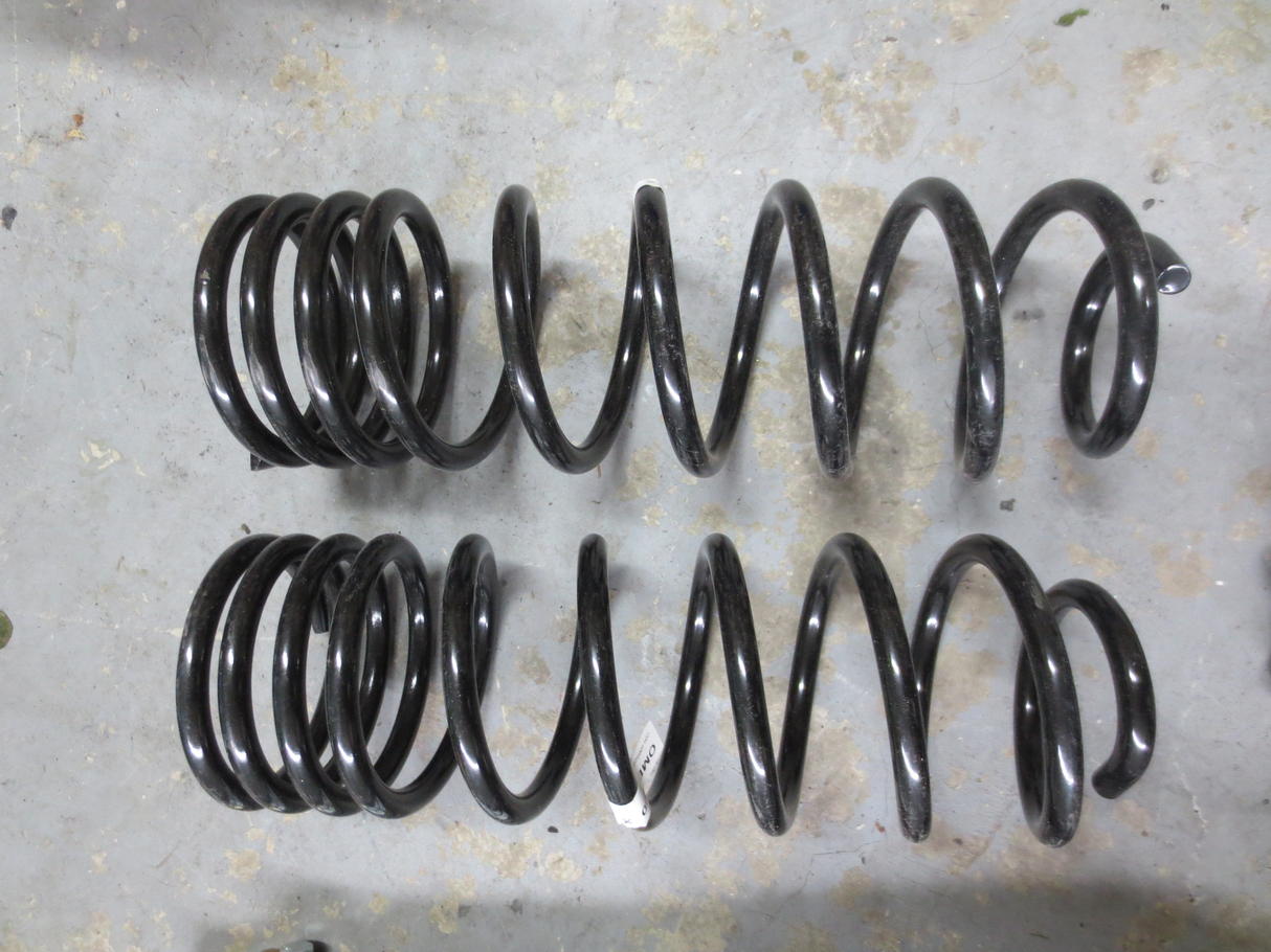

Lift all done, 5 hrs later, not too bad. Also got the Curt roof rack installed today. Not my first choice for a rack but it was in the budget.
Just some fair warning I installed some moog lower ball joints on my father in laws Tacoma and within a year the rubber was already failing. Pretty bad quality if you ask me. Maybe look into Toyota ball joints or Napa which people have had good luck with. Your truck looks great I've always loved that color.
For LBJ's I always recommend OEM - I will probably end up going OEM steering components too. For me, it's one of those things I don't really want to risk to component failure.
