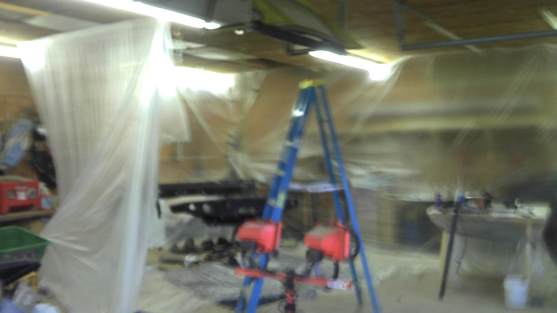

- clean the area as best you can
- wipe down area with MEK
- Sand down all the areas you want to coat (careful not to strip to bare metal, just enough to remove clear coat)
- wipe down with MEK 2 times ensuring surface is clean of everything

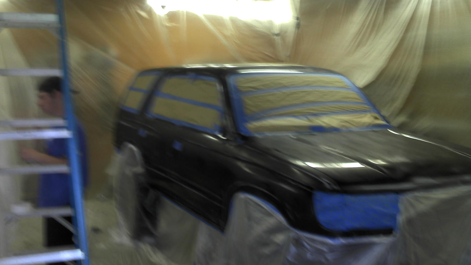

- Tape all areas you don’t want hit with paint

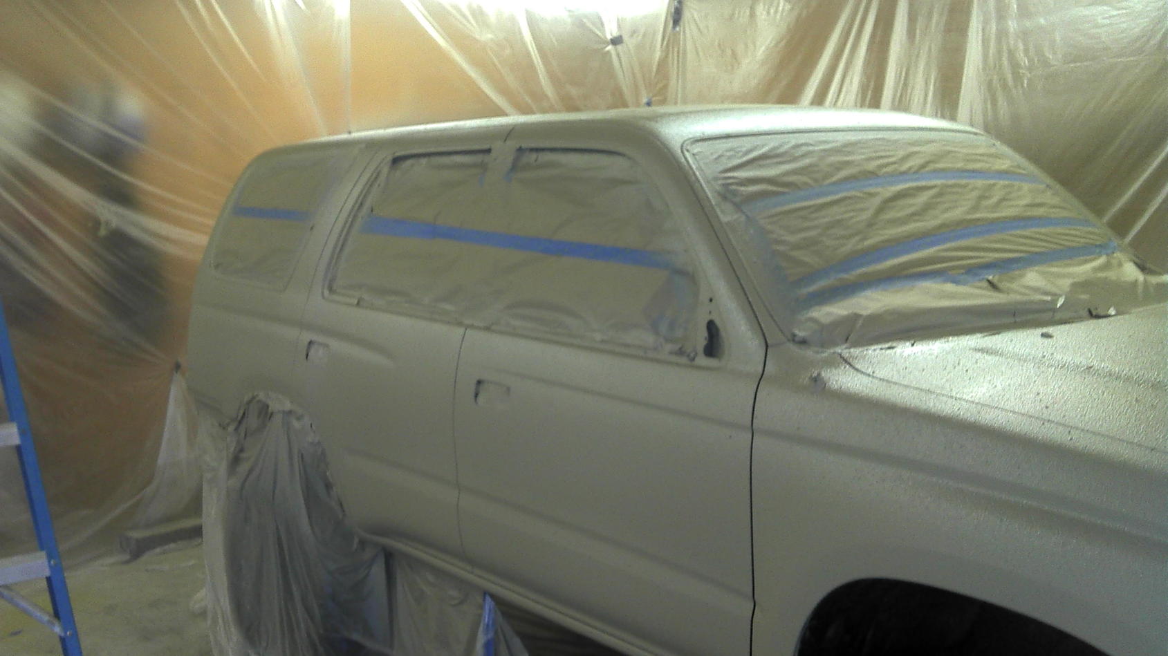

- Once mixed I poured the paint into the gun and started spraying working from the top to bottom.
- I sprayed at 65 PSI (recommended 50-80) (they also say to reduce it with 4 oz. of MEK when spraying)
- spraying is extremely easy; you will get a hang of it as soon as you start spraying.
- Once done first coat clean gun and wait around 1 hour between starting again (paint should be dry to touch also clean the gun by spraying MEK through it)
- If working from the same gallon mix for 1 min. before starting second coat
- apply second coat making sure you hit all the areas you want (you should see texture now)

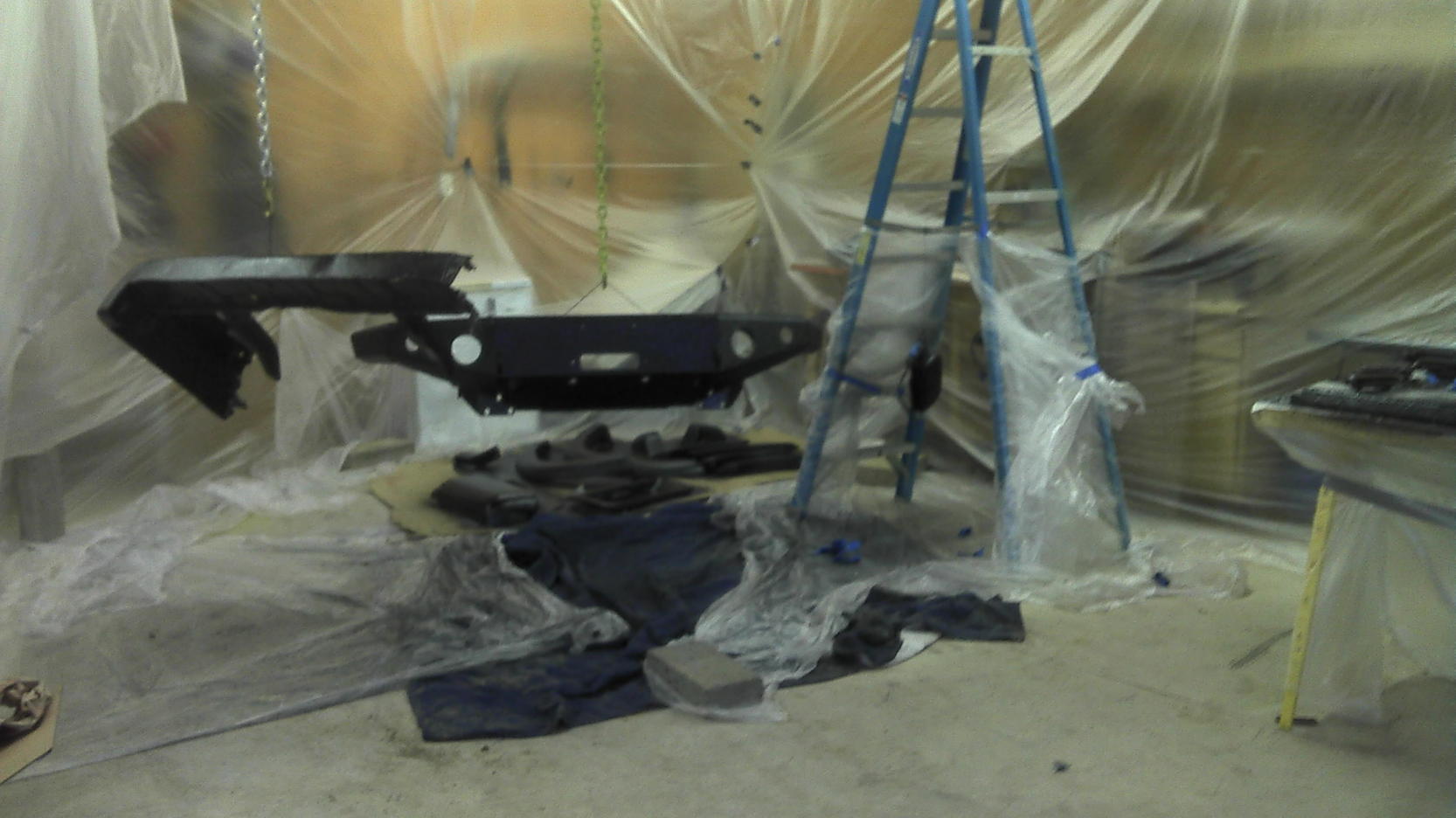

I used about 1.5 gallons of the desert sand and about 3/4 gallon of the black. with the desert sand I applied 2 heavy coats to entire body - all the parts I took off to paint black. for black I did 2 coats on most but 3 heavy coats on the bumpers.

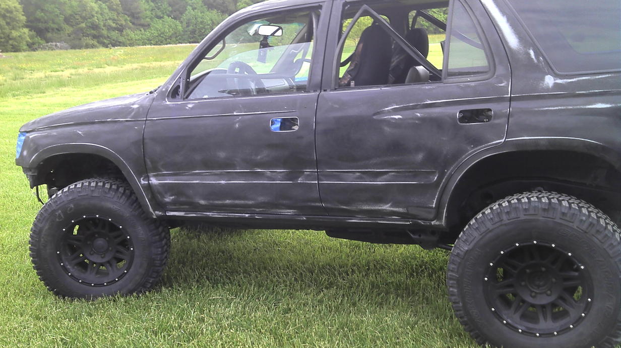

some pics

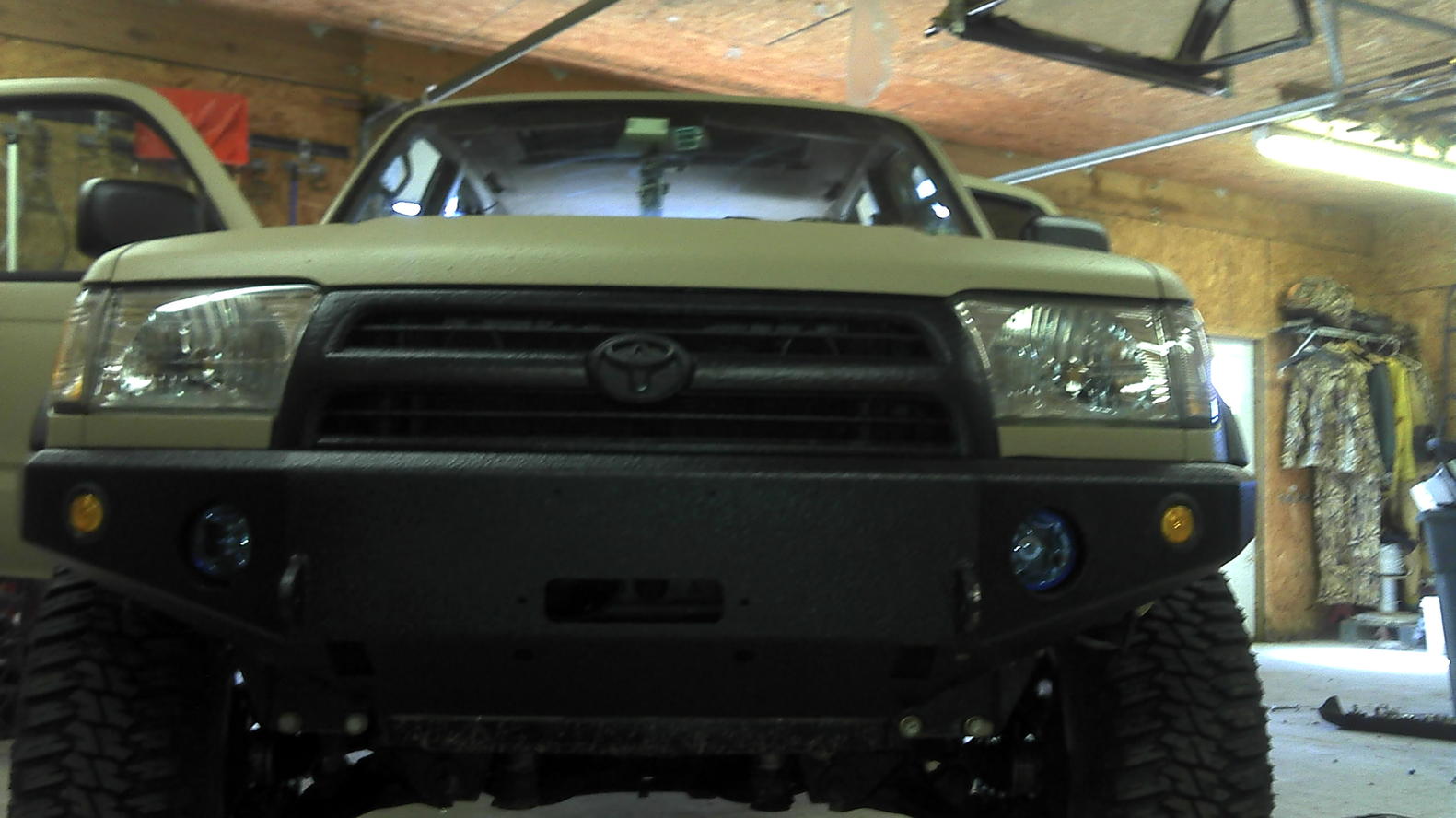

Great man! I'd also like to request some more hi def pics, especially outside so we can see the quality in direct light.
Thanks!

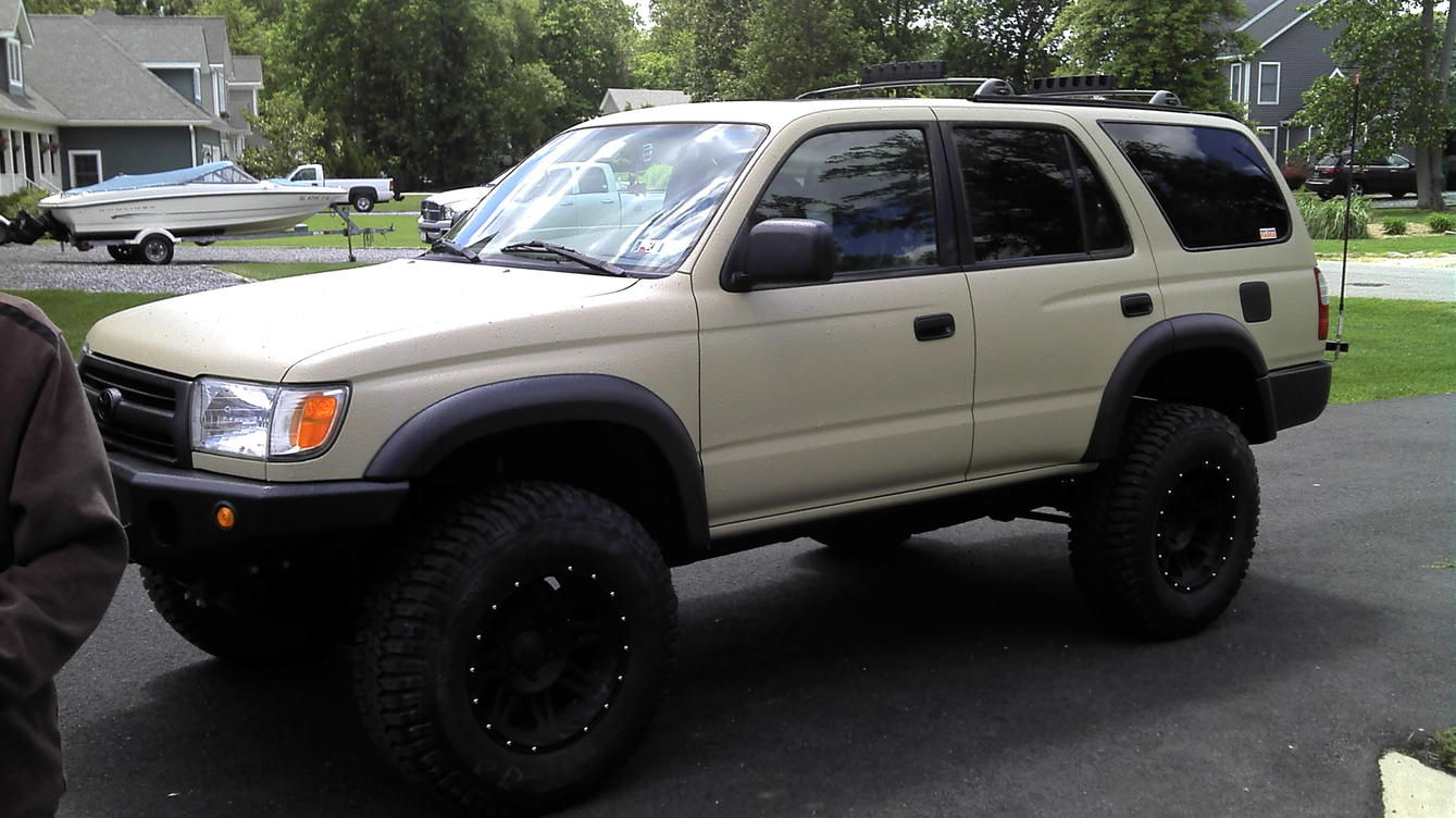

I have to admit that when I first heard about this I thought it was dumb as hell.
Now I actually think it looks pretty sweet. :) Not sure it would make sense for everyone, but for those who plan on wheeling a LOT I could see how it makes quite a lot of sense. Looks pretty sweet. :)
How did you do the fenders? Are they aftermarket flares? Or did you mask them off and paint? If so, with black monstaliner? or regular paint?
You mentioned you sprayed because you liked the texture better than rolling. Can you describe what the differences are in texture spraying vs. rolling?

I noticed in your pictures that you have some spots that look like "clumps". On the hood there are a few and on the driver side doors there is a few. The first time I saw your pics I noticed those spots where the texture wasn't uniform and I wondered if it was because you sprayed. Seems like that wouldn't happen if you rolled because it would all be smoothed out with the roller.
Could it be possible to use different size porous roller pads to achieve more or less texture?
Good eye, I ran into a problem when I did it where the material was too thick at first so it kept clogging the sprayer so specks were all over and there was a few spots where there were big glops from me accidentally having some pour out. Those problems are now fixed since in sanded it down and re painted. I feel rolling you can see the stroke marks if you are not careful but you can create your own texture with the speeed you go at

Can you give us an update on how you're liking the Monstaliner? How is it holding up to the elements?
I still love it and it's holding up pretty well, I haven't noticed and fading, but I did get a small chip on my front bumper , maybe because it came bare metal and all I did to prep it was some self etching primer . Overall I still love it and am thinking about doing the interior with it
