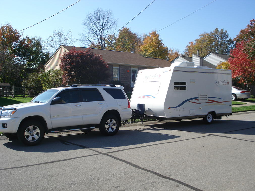

What do you think about this option. I found a Jayco Featherweight, 18' TT. It's a M-165 Sport. The unloaded weight is 2850 and loads out at 3500 max. The tongue weight is 450. With the V6 option, this seems like the weight of a good size pop-up, just catching more wind. My hitch shop is saying I probably only need anti-sway, but they'll put a WDH on if I think I need it. Is the WDH mainly for any sag? I have a lift, so the rear sits level with 450lbs on the tongue. I am going to take it for a test tow this afternoon and see how it does. The length seems within search recommendations. I just can't trade tow vehicles, so I'll either keep my pop-up or see if this smaller TT will tow safely. Feedback much appreciated. Best regards, Doug
Well, I took this thing for a test tow today. It pulled up and down some pretty good hills fine. I don't think this lite of a trailer is even equiped for accepting WDH. I dropped the rear about 2", but I am + 2" in the rear anyways, so I was pretty level. The steering felt fine and didn't seem like the front end was floating at all. I would add an anti-sway bar for sure. It was pretty breezy today and the thing towed fine without one at 55mph. Here's a picture of the set-up. I will contact Jayco to see if a WDH can be run with this unit. Looks like they do sell a WDH 600/6000 that would work. I think with this hitch unit, the combination should tow well out West. The Equilizer E-2 has the anti-sway build into it.

Good to hear. If it were me I would add some of the firestone air bags to help level the rear out and offset the load. Kit is $100 and easy to install. We use a set in our F350 SuperDuty when we tow 15k+ to help level the truck off. Makes a noticible difference.
Thanks for the input,
Those Firestone Air Bags make sense. I'll look to get a set to put in my set-up. Thanks again my friend.

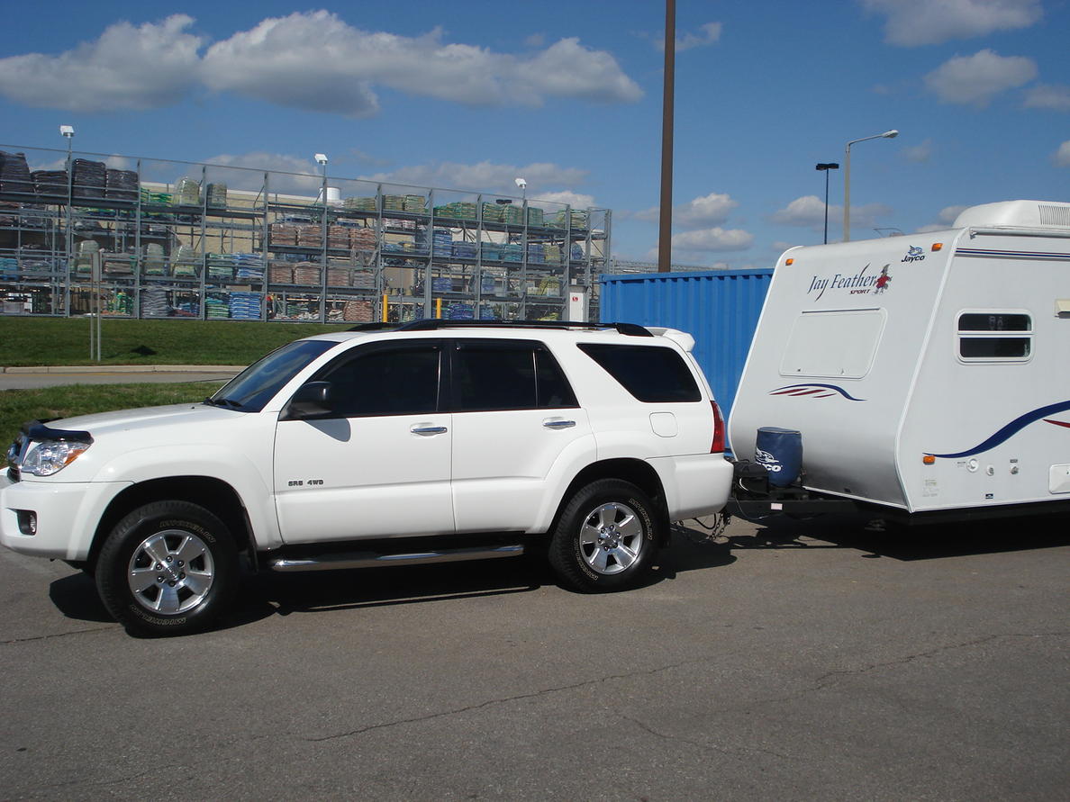

Final Rig 16' TT with WDH
Well, I ended up purchasing the Jayco Feather 165 Sport. I bought a hidden hitch and WDH. After setting the WDH up, I an now only down 1/4" in the rear and feels much better with the weight back on the front axel. Anything bigger is a little squirly with this short wheel base. These 16' TT's are hard to find, but they seem to be a good choice for the V6 4Runner. Went through the 2007 TT top to bottom and have it put in storage. RV dealer wanted $675 to put on WDH alone. I purchased from Etrailer for $325. If you have a lift, you'll need to order the 4 5/8" drop shank to level your trailer. The one that comes with the E2 Equilizer is not long enough. The Hidden hitch was $191 on sale. If you have the V6 factory hitch, you'll have to remove the back bumper to get the 4 bolts off under the bumper.
