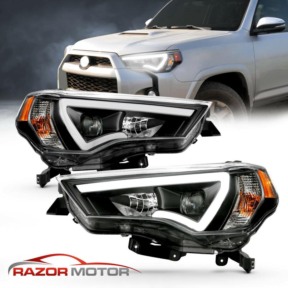

Anyone bought the Morimoto head light clones sold on ebay? Since Morimotos are about $1500 and have issues I was looking at the 1:1 clones sold on eBay and using good bulbs for the lamps. I did a search but only thing I found was threads on the Morimotos and all the issues. My main worries are fit since you need to remove the bumper to install head lights.

The question you need to ask is whether they're clones or actually the same lights. Remember, Morimoto doesn't make their own products. They simply buy from Chinese contract manufacturers and have them slap their name on them. Those same contract manufacturers also sell to other folks who market them under their brands. That said, do you really think something even less expensive on eBay is going to work better? My educated guess would be no.
Where are you seeing 1:1 clones of Morimotos? Usually good bulbs in some shitty housings are not going produce good results.
Isnt everything made in china? For $1500.00 Morimoto has a very high failure rate seems about 20%, Even good working Morimotos have a poor beam throw. But anything automotive on EBay has a guarantee backed by Ebay. Its just the time of removing the bumper at least 2x. So its $1500K and I get a 100% bad light pattern and good chance of LED going out. Or 1/8th that price and ? , thats why I asked if anyone had them.
All of those headlights floating on ebay and AlphaRex's products are complete garbage when it comes to light output. Either do a proper HID or LED projector retrofit or buy OEM LED headlights. Those are the only two options if you care about actual lighting performance.
save your money. upgrade bulbs in the OEM housings or find some OEM LED takeoffs
I already have HID in OEM housing , and can revert back if needed. I wanted Morimoto but people say they are horrid. I was going to buy Alpharex but thought Id see of anyone one had the knock offs 1st. Most knock offs are made in the same city and people literary walk over and copy it exact since China has no laws against it. Ive been to China many times and have seen it.

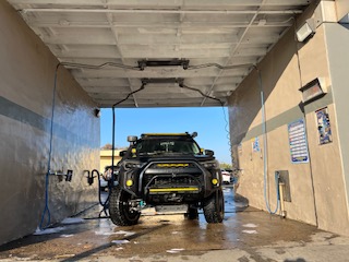

I shall return with pictures of my Gen2 Morimoto's I had installed on my '18 Limited later today. I would absolutely shill this brand so hard for anyone interested in upgrading their shitty stock headlights.
Knock on wood but loving my Gen2 Morimoto's a lot. No issues. It is certainly worth the purchase price and I'd do it again in a heartbeat if I had a 2nd 5th gen vehicle instead of my backup 4th gen.

I just installed these last month and am happy, especially for the price. Fits just the same as the OEM so nothing to be concerned about with installation.
2 notes:
-They come with H7 lowbeams.
- I needed to re-aim my beams but that maybe due to my lift vs anything with the lights themselves.
