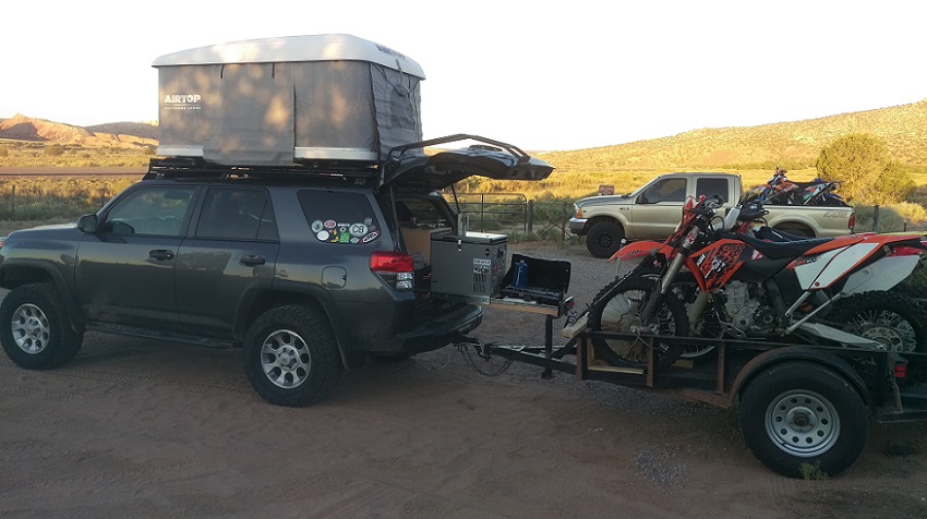

I have a 4 bike hitch carrier that works pretty good.
It has wheels on it though.
