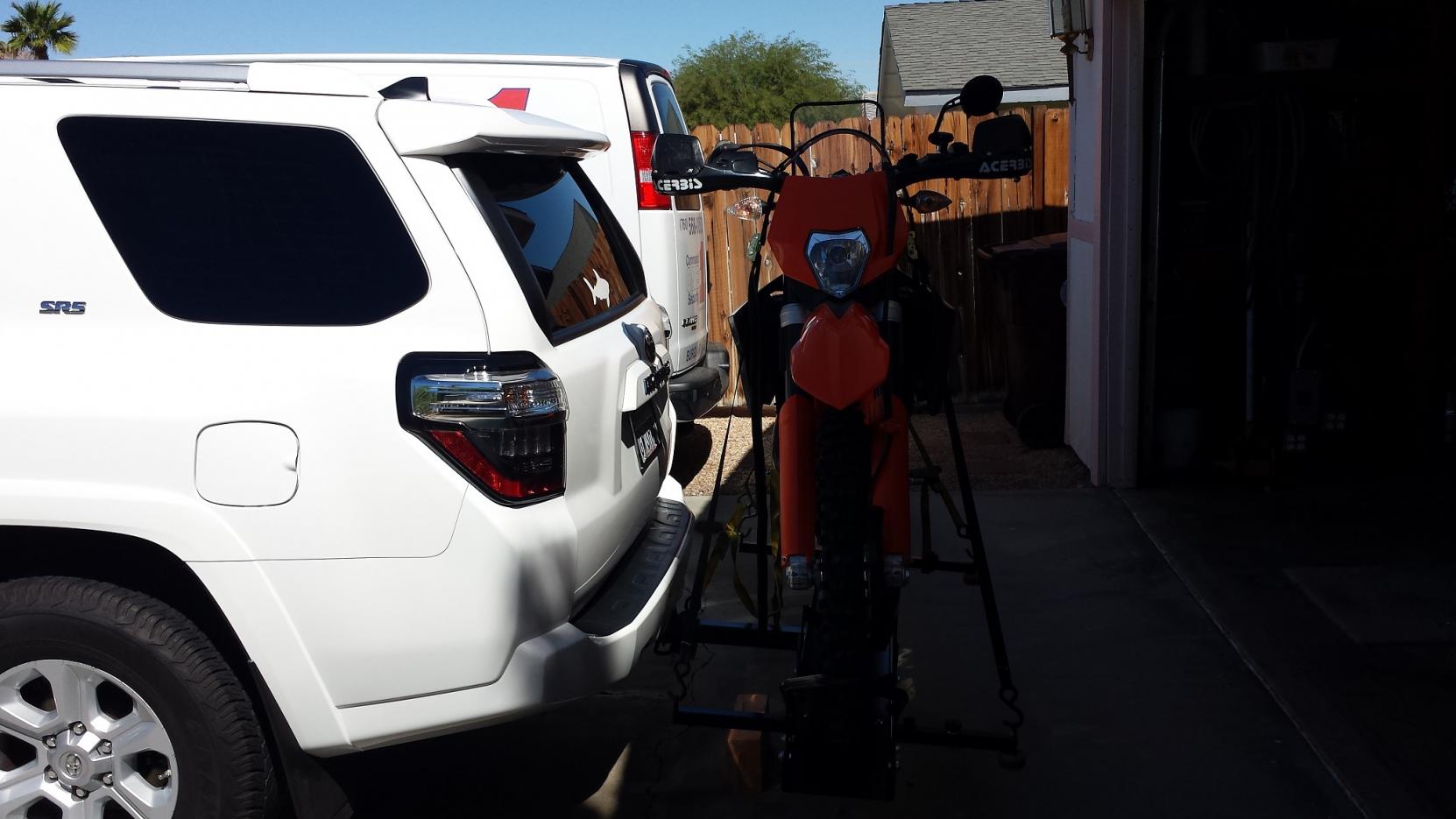

Don't have any current pics on the 5th gen, but my old Versahaul held my dirt bike and Ducati 748 without any issue's.
ktm008.jpg~original
This one is cheaper, but perfect for dirt bikes

I use the AMC-400 to carry my KTM. It works okay for what it is. I have a few different anti-sway setups to try because the ones included dig through the hitch coating very easily and creates surface rust spots. Also, it loosens easily. Minor complaints, but for the price it saves having to store a trailer just to move the dirt bike to the trails.

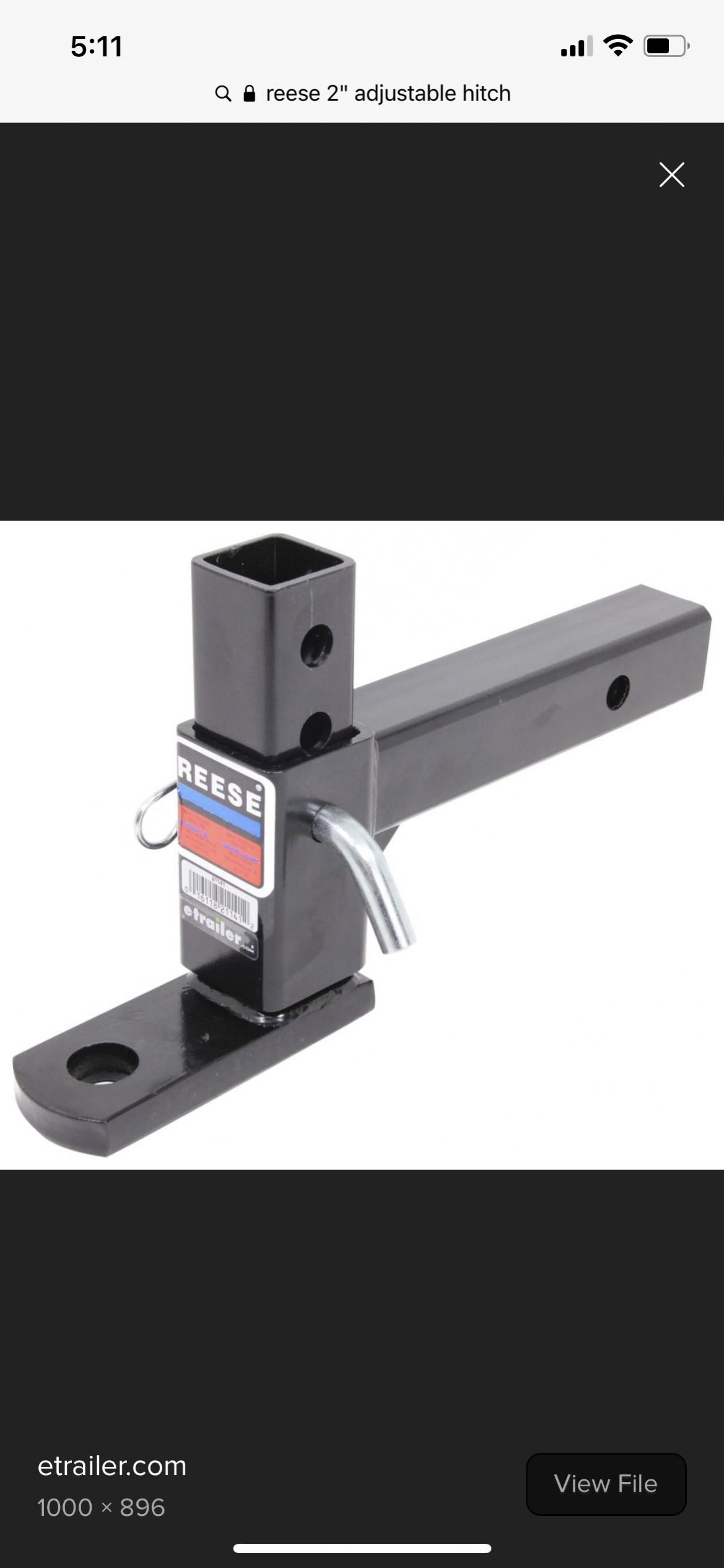

You can DIY or find a fabricator to add onto a trailer hitch. If bike is lightweight.
My multi purpose carrier hitch uses a Reese 2 piece Hitch. I bolt on the horizontal carrier thru the tow ball hole. Photos of set up will not load here.
