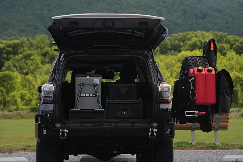

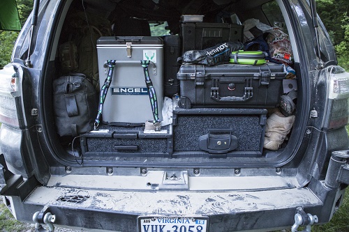

Phase 2 - Drawers
Hey guys. Sorry for the delay with the build posts. We have been busy getting season 3 produced and pushed out and we certainly hope you're enjoying it so far. We're slowly getting back into the groove of things and will be pushing out more updates on the T4R5 so stay tuned. Here is a bit about our drawer system.
For season 3, we went with the Outback Solutions dual drawer setup from ARB. Originally, we floated around the idea of using three drawers, 2 Roller drawers and 1 Low level roller floor drawer however after physically placing the drawer set up in the T4R5, it turned out that spacing behind the backseat would become an issue. After much thought, we opted to ditch the second roller drawer and went with 1 of each.
The install was pretty straightforward..four holes in through the tailgate sealed from the outside with the supplied rubber padded plates. Lining up the drawers actually was more time consuming than the actual install. The drawers are built with space saving in mind hence the connector in the middle which minimizes wasted space between the drawers. For the connector piece, we actually ended up completely disassembling the drawers according to the supplied instructions and stripping them down to the framework in order to run the connecting bolts through..that was the time consuming piece.
Now onto the drawers themselves. As stated before, the drawers seemed like they were designed and built with space saving in mind. Due to that fact, we quickly found out that space saving also meant sacrificing storage space. The roller drawer proved to be a bit bulky at times with the drawer consuming a little more than an inch on each side on the inside of the drawer housing. With a minimalistic approach, we were definitely able to fit a number of items that we needed into the bigger roller drawer but finding a practical use aside from the roller floor on the smaller drawer proved to be challenging. (Ended up housing a compressor hose, a laptop, and a few other low profile items)
All in all the Outback Solutions storage system definitely served its purpose but did not WOW me by any means. I do wish I had more drawer space, we may have to add storage next year.
