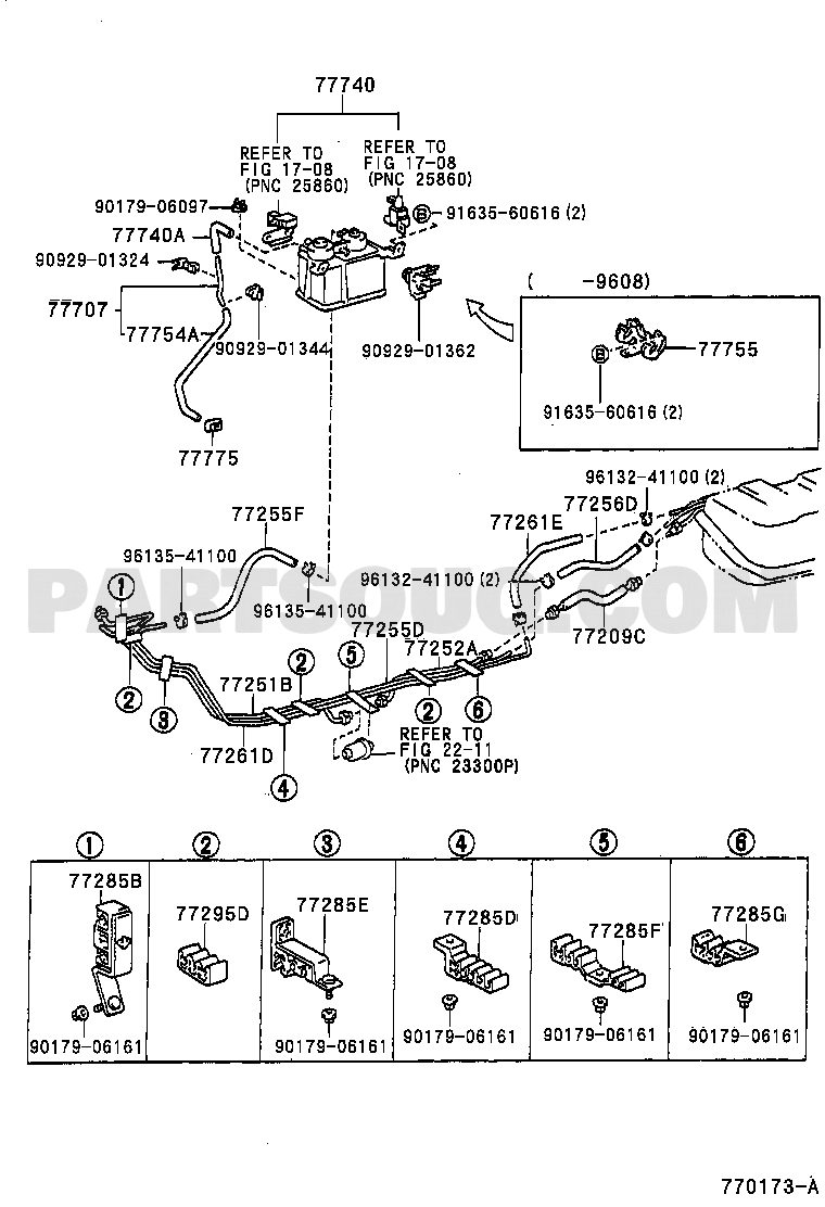

Also, can someone tell me where this vacuum line terminates? Found it not attached to anything and figured I must’ve popped it off when I was messing with the motor mounts
Swear jar filled up fast today. Welding in the new cam tabs tomorrow…beer trumped motivation before I got any further. BTW, screw that front diff removal, what a pain
pretty sure that is just the vent to atmosphere, there is a little plastic gourmet like thing that just goes into the frame.
GUIDE, CHARCOAL CANISTER OUTLET 77775
Like [MENTION=168172]sleepydad[/MENTION] said, it’s the vent hose. My plastic fitting at the frame rail broke during my frame swap, and as far as I can tell it’s no longer in production. Mine is also just hanging freely, with no negative side effects it seems. If you didn’t like it dangling, you could probably run new rubber hose and vent it anywhere you’d like low on the frame.
Thanks for the info, no wonder I couldn’t find a diagram that showed what it connected to.
